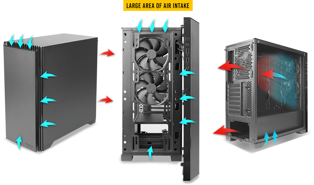

Take off the front panel and see how much that does. This case has NO airflow because its "silent". Fyi noise padding doesnt sor when the pc gets louder because it cant cool itself. Defeats the entire purpose
It's a 12900k ... It uses like 250W+ at full load so reaches 90C+, seems pretty normal to me
On 5/18/2025 at 5:56 PM, Haveri said:
If I open the case in point a home fan directly inside, and the temperatures don’t drop significantly, can I safely rule out the case as the issue?
Which part of the case did you open, the front or the side?
That case is blocking the part where you want air to enter it - the front. It’s a poor design based on aesthetics over cooling.
Antec are trying to sell the idea that its vents allow enough air to enter the case…
I doubt their claims.
If you were to only open/remove the front of the case (leave the side closed) I think your temps would drop. But it’s still not ideal.
In an airflow-focussed case, 3 intake fans in the front & 2 exhaust fans (rear & top/rear) would let you keep both temps & noise down.
