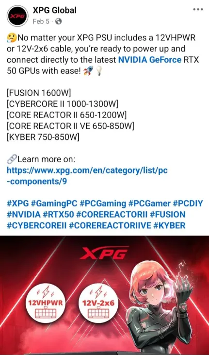

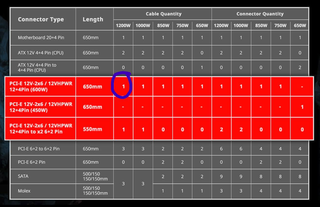

So I did buy myself an XPG CORE REACTOR II 1200 WATT and the package says ATX 3.0 12VHPWR yet the website of the local store that I bought from said ATX VERSION: ATX 3.0&3.1 and  ended up confused not knowing if what I had was an old unit or the new one.. Some ppl said that it's just the package is old and hasn't been updated but inside you will find the new updated cables, then I actually did find this on XPG facebook official's page okay so they saying no matter if the psu includes 12vhpwr or 12v-6x2 , still ready to connect and powerup the new 50s series? does it mean that they are aware of such a thing and trynna say that the atx 3.0 12vhpwr will still get the job done perfectly fine as much as the 12v-6x2?
Imma be pairing it with a 5090 nd this is why I am really worried and wanna make sure..

Comes with the cable you need in the box.
I'd suggest you stop worrying about what the retailer and twitter say and just use the manufacturers website.

16 minutes ago, GuiltySpark_ said:
https://www.xpg.com/us/xpg/pc-components-core-reactor-ii?tab=spec
Thank you soooo much dude I was hella worried to pair it with my 5090. So actually even if the box says and the package says ATX3.0 12VHPWR, it still has the new cable that I need? I did check the warranty and it says it is under warranty till 2034-11-30 which means the unit I do had been produced like 5 months ago so it is literally new and should have the the all new 12v-6x2 cables right? but I dunno why the box says atx 3.0 12VHPWR, tho..  and what if the PSU still has the 12VHPWR connector and not the 12vh-6x2?

aha I see. if so then what about XPG statement? and what about the 5080? same issue? need atx 3.1 12v-6x2 too?
Others walked you through it

but I mean atx 3.1 12v-6x2 isn't needed with it, no? like what do you think of XPG statement? their 12VHPWR cable already ready to work perfectly with the 50s gen just as much as the 12vh-6x2?
Again others have proven to you and explained that

This was a very very helpful reply.. Thank you so much for real.. So basically what do you think of XPG statement ? like when they say "No matter your XPG PSU includes a 12VHPWR or 12V-2x6 cable, you’re ready to power up and connect directly to the latest RTX 50 GPUs with ease!"
Buddy idk what you want us to say about the statement
It says it has the cables you need to power 50 series GPUs. There isnt anything else to it

like even if it is the 12VHPWR and not the 12v-6x2 still will power up 5090 with no issues huh? sorry for being worried much, but you shoulda said what ppl on reddit been saying .. " if its not an atx3.1 12v-6x2, your 5090 will get melted" so ofc got worried sorry lol
There isn't any difference between a 12VHPWR and 12V-2x6 cable. The power cable is the same. A 12V-2x6 cable is a 12VHPWR cable and vice versa.
https://www.corsair.com/us/en/explorer/diy-builder/power-supply-units/will-my-12vhpwr-cable-work-with-12v-2x6/
Quote
There is no difference between a 12VHPWR and a 12V-2x6 cable. The changes in revising the 12VHPWR connector and renaming it to 12V-2x6 were only made to the connectors on the graphics card side.

OMG now it makes more sense like honestly thank you so much.. I do understand now and the pic is clear. Wel,, imma pair this atx3.0 12vhpwr right now and plug it in all the way in and lets hope it won't get melted lol

XPG did reply back to me saying : " it is ATX3.0 ver" so basically some how I got the atx3.0 ver 12vhpwr eventhough I did buy it a month ago and the warranty till 2034-11-30 which means this unit had been produced last December so it supposed to be a new unit yet it's an atx3.0 12vhpwr omg.
