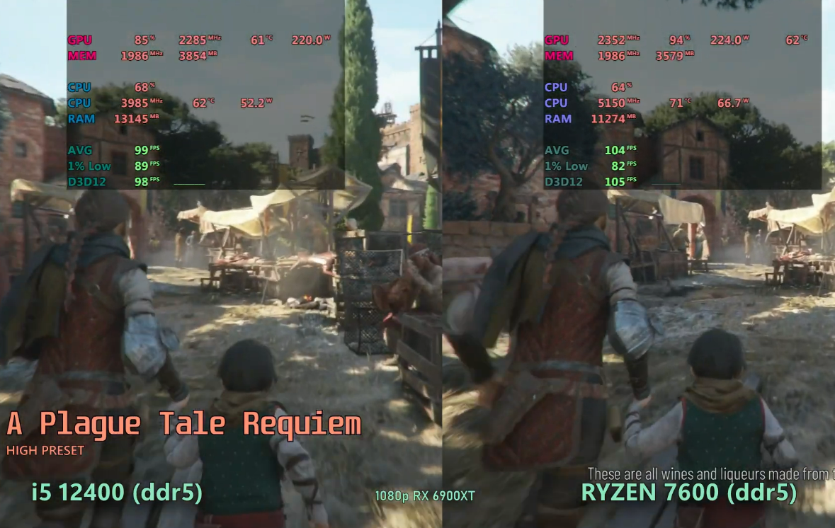

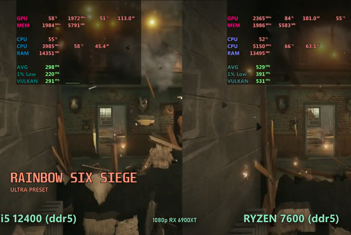

I thought of another question, do you think i necessarily even need an upgrade to this level of config if i want to upgrade from my 1080p 60hz to 1440p 120+hz light/mid gaming+productivity?
Currently i have 12400F, 3060ti, 32gb ddr4 3200 cl16
It does depend what game you're playing, you might still need new PSU for better GPU. And CPU upgrade also depends on your motherboard.
It also depends on game, if you're looking for boost, this benchmark is 12400 vs 7600 with 6900 XT GPU: (1080p)
It's up to you, 12400 is already decently fast to deliver smooth 60+ fps gameplay which in majority of games is more than enough, and you could just get better GPU and PSU so that you could crank settings higher and crunch Blender renders faster and do more complex scenes.
