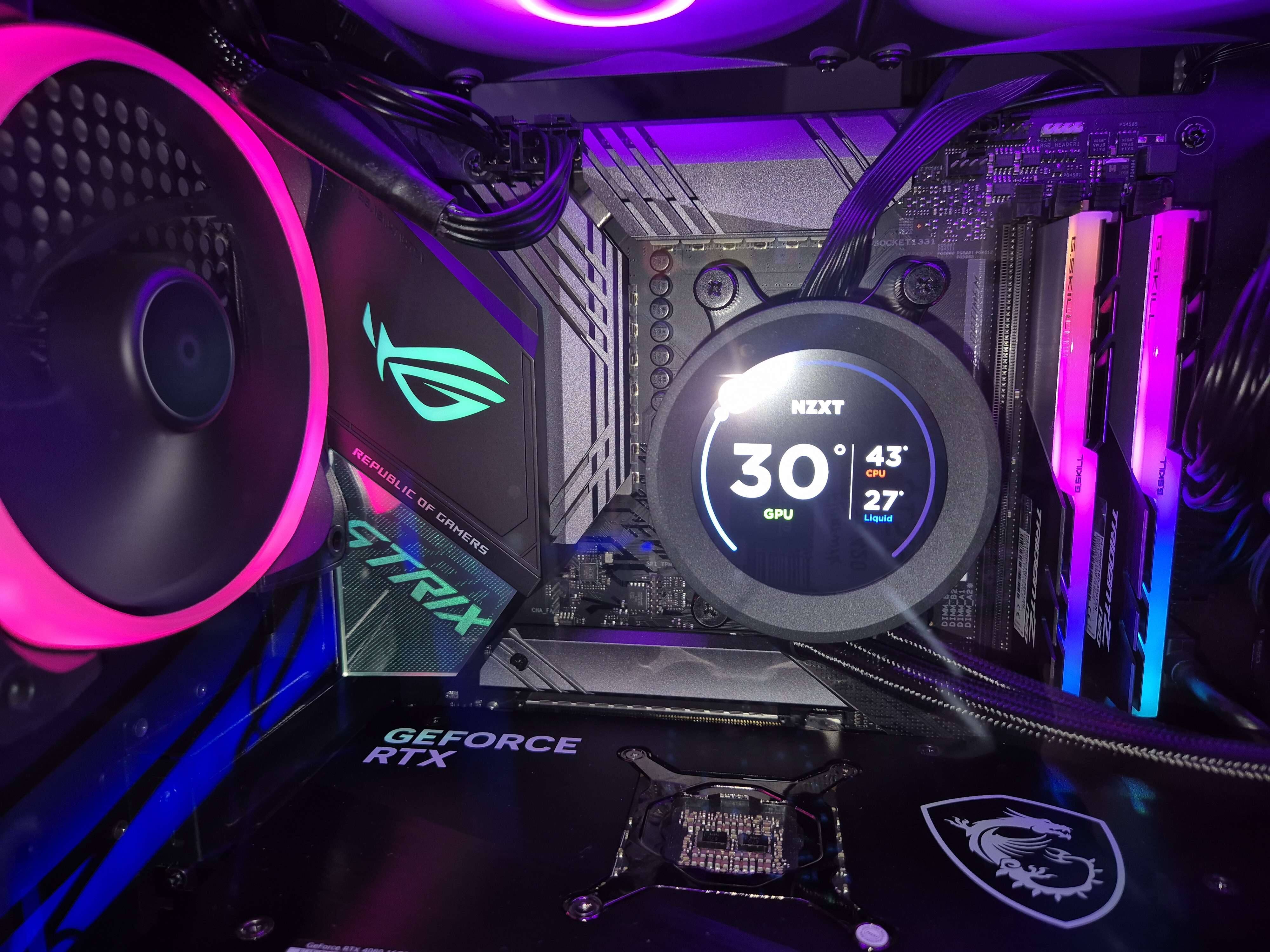

I observed that my top case fans were configured as intake, directing heated air towards the VRMs via the radiator. I have reconfigured them as exhaust fans, but have yet to conduct thorough testing. I will provide updates on this thread regarding the efficacy of this modification in resolving the issue.

Top case fans (mounted with an AIO radiator) were configured as intake, pushing hot air from the radiator back into the case, right over the CPU socket and VRMs. This caused heat buildup in that area, especially with side panels on, despite all reported temps (CPU, GPU, VRMs) being within "safe" range. It was enough to cause freezes under sustained load like OCCT AVX2 or gaming.
  • Reconfigured the top fans to exhaust (instead of intake).
  • Left the rest of the fan setup as-is (normal intake from bottom/front).
  • Used a normal fan curve (not even maxed out).

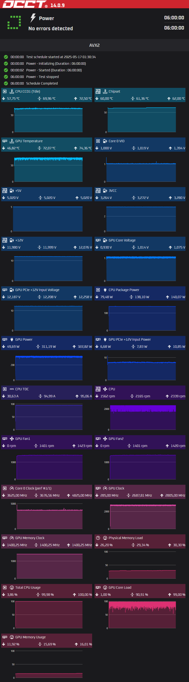

  • Reran OCCT AVX2 power test for 6+ hours – no freezes.
  • CPU and RAM temps dropped by ~6°C.
  • System now stable under load with case panels on.

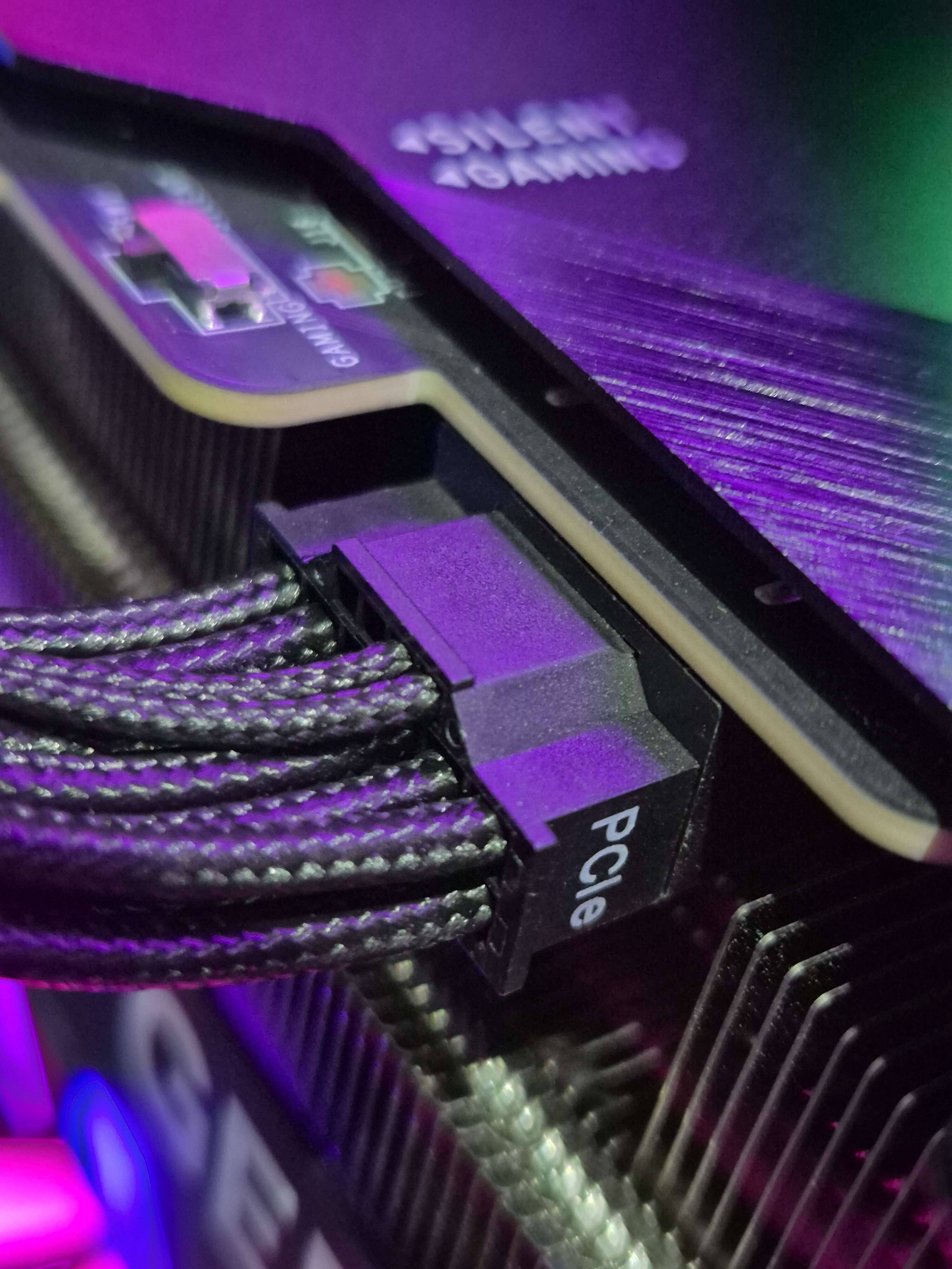

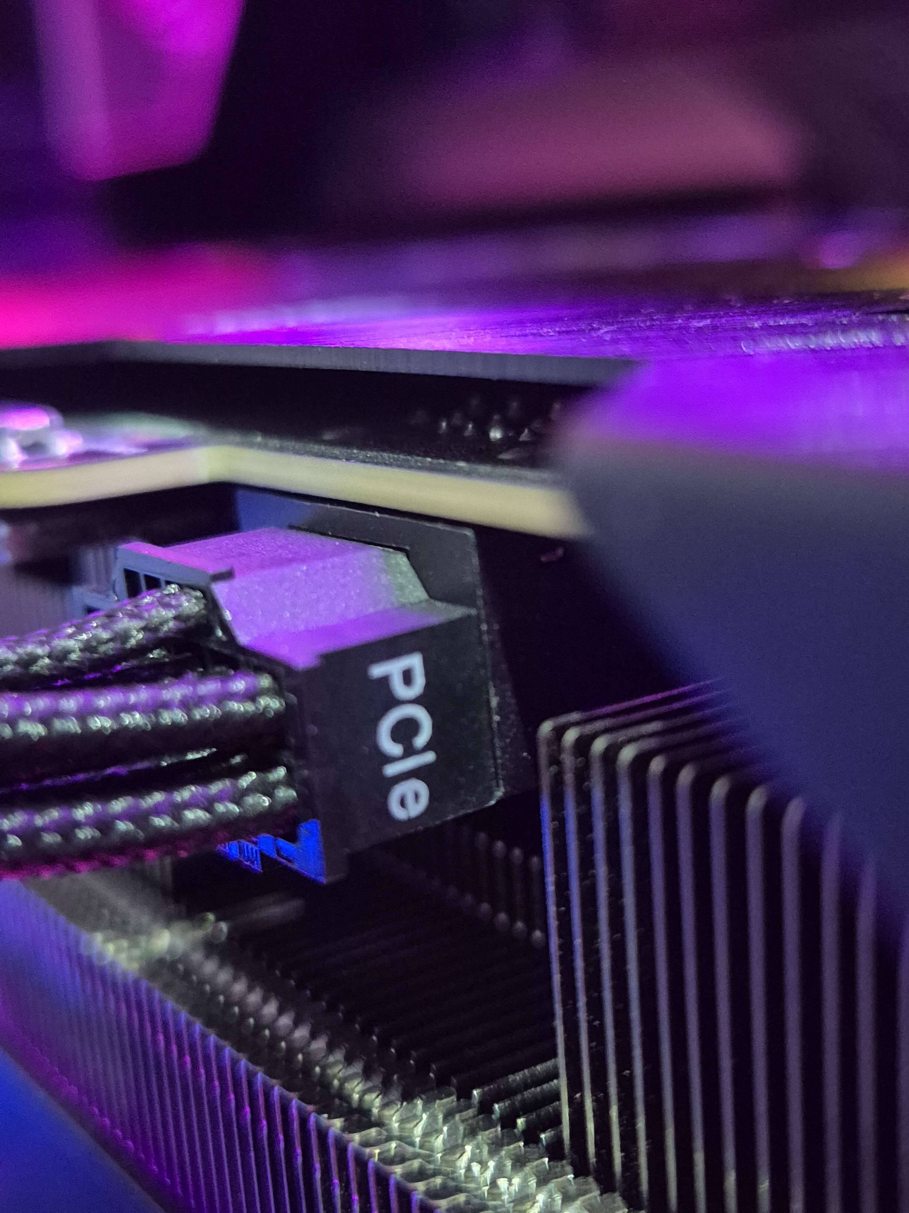

  • 12VHPWR Cable: Premium Individually Sleeved 12+4pin PCIe Gen 5 12V-2x6 600W cable, Type 4, BLACK

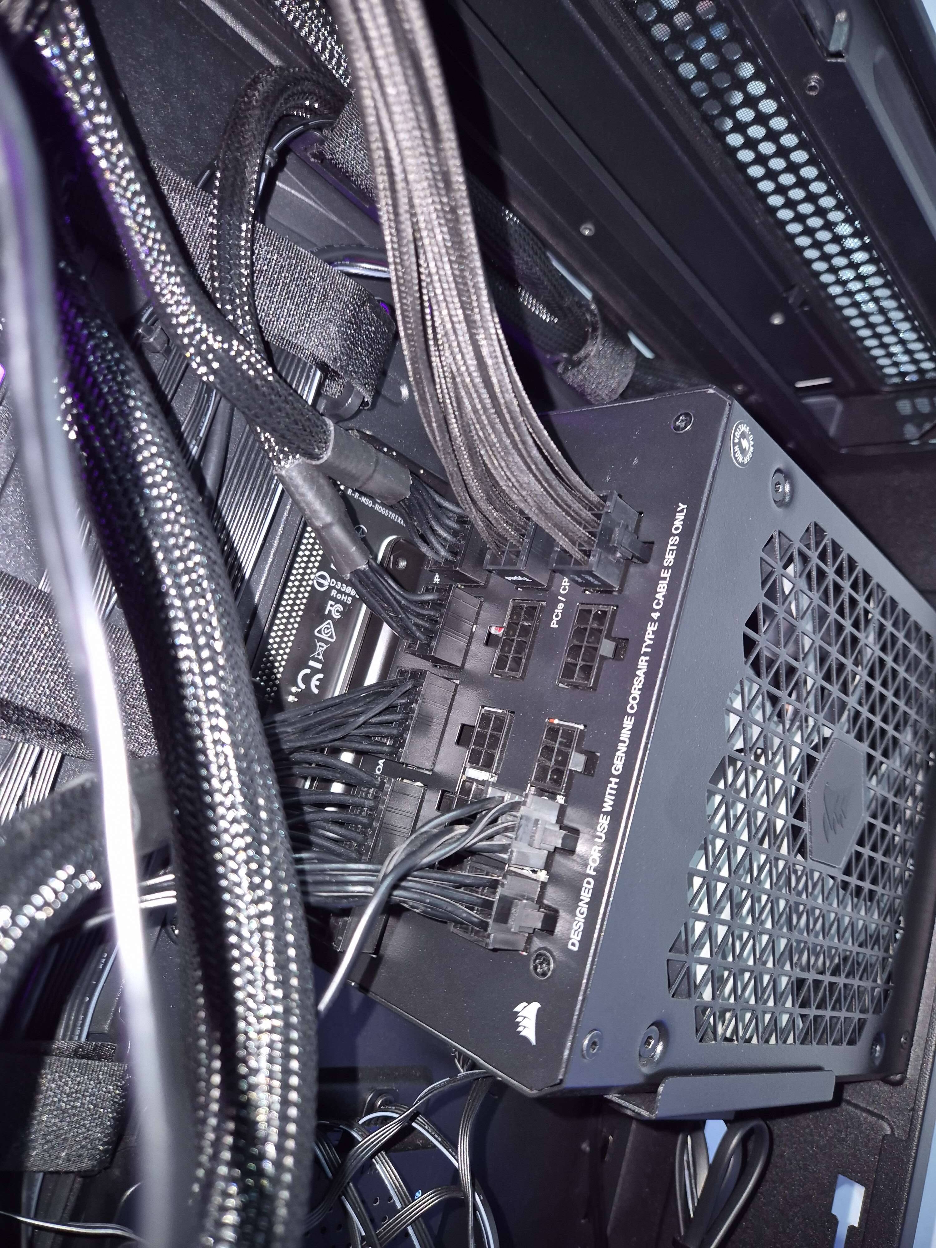

  • Reseated GPU several times, removed GPU support bracket.

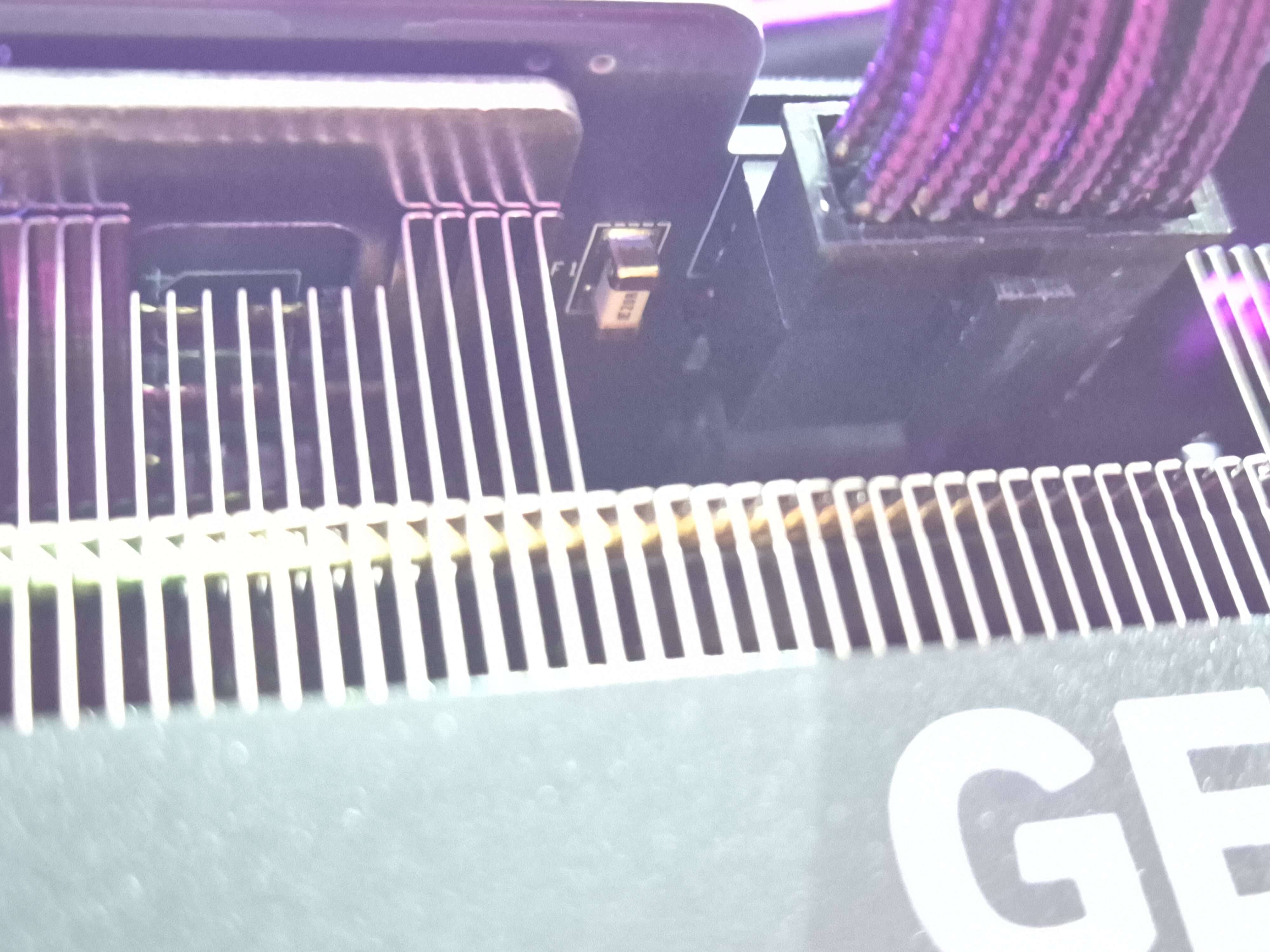

  • Replaced and reconnected all PSU cables (OEM Corsair, new 12VHPWR cable)

  • 12VHPWR Cable: ~50 - 55°C under load.

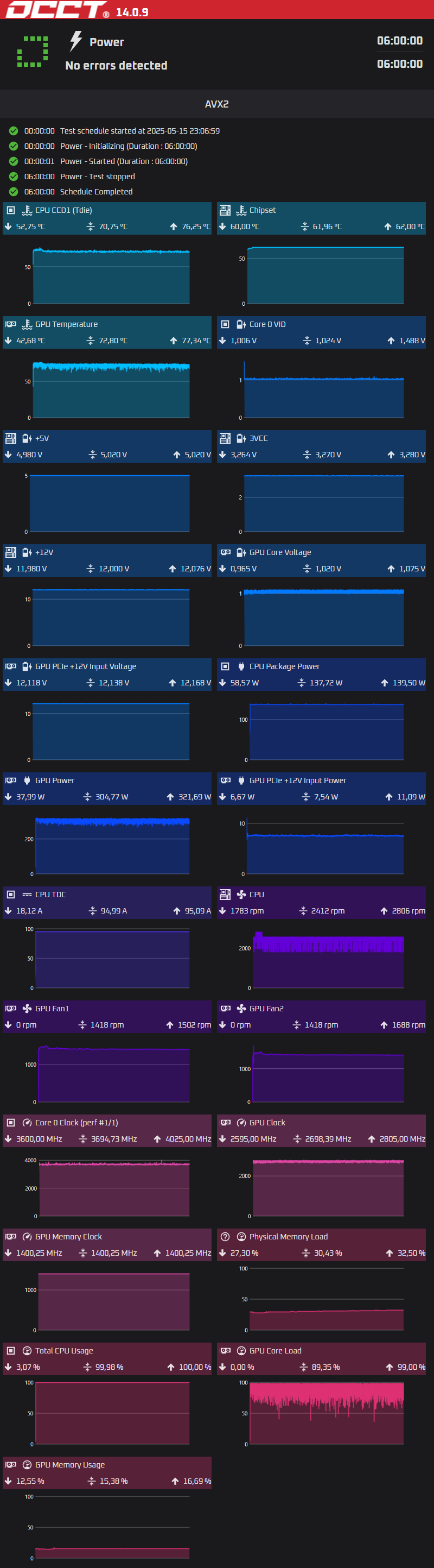

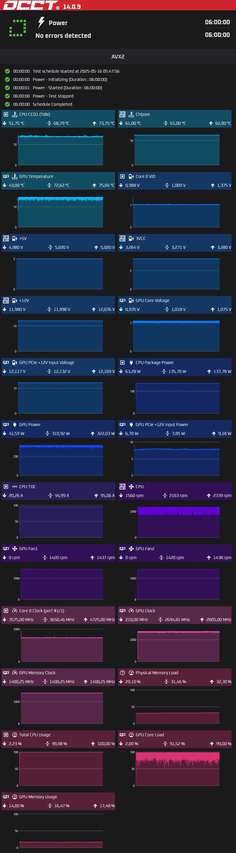

Stress Test Results
  • FurMark, 3DMark and OCCT 3D Adaptive: Pass without issues!

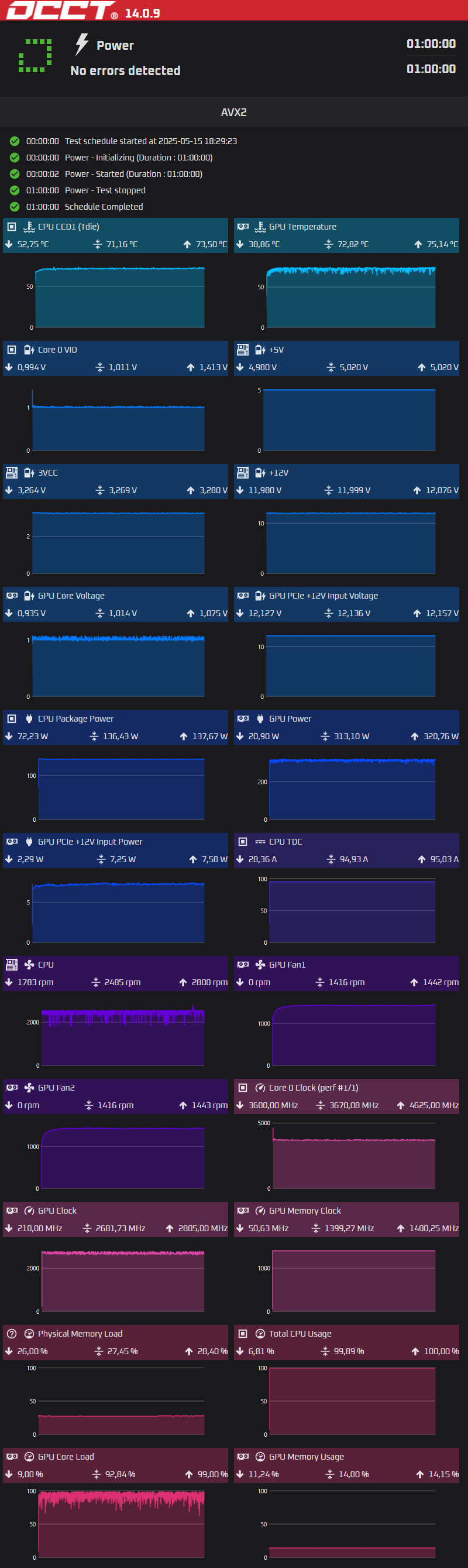

  • OCCT AVX2 Power Test:
    • Fails (system freeze) after 20 - 60 minutes with case closed and airflow on Silent or Normal.
    • Passes 12-hour test when side panels are removed and NZXT CAM is set to Performance mode.
    • CPU/GPU temps remain steady at ~70–75°C under full load in both cases.

OCCT-Report-25515-073243-1h.pngOCCT-Report-25515-083335-1h.pngOCCT-Report-25516-021723-6h.pngOCCT-Report-25516-050920-6h.pngOCCT-Report-25517-074409-6h.png20250517_104310.jpg20250517_104315.jpg20250517_104328.jpg20250517_153117.jpg20250517_153145.jpg
