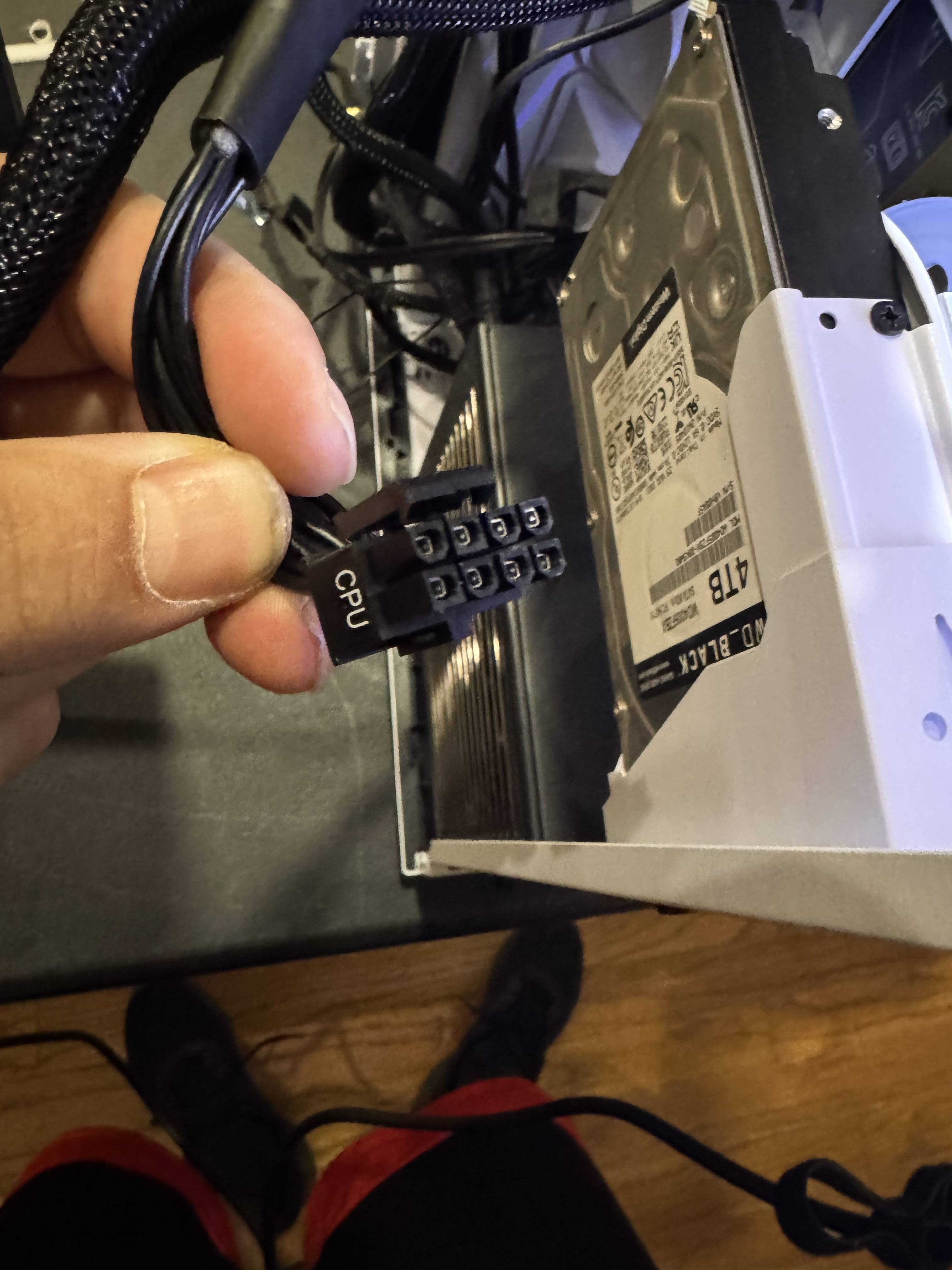

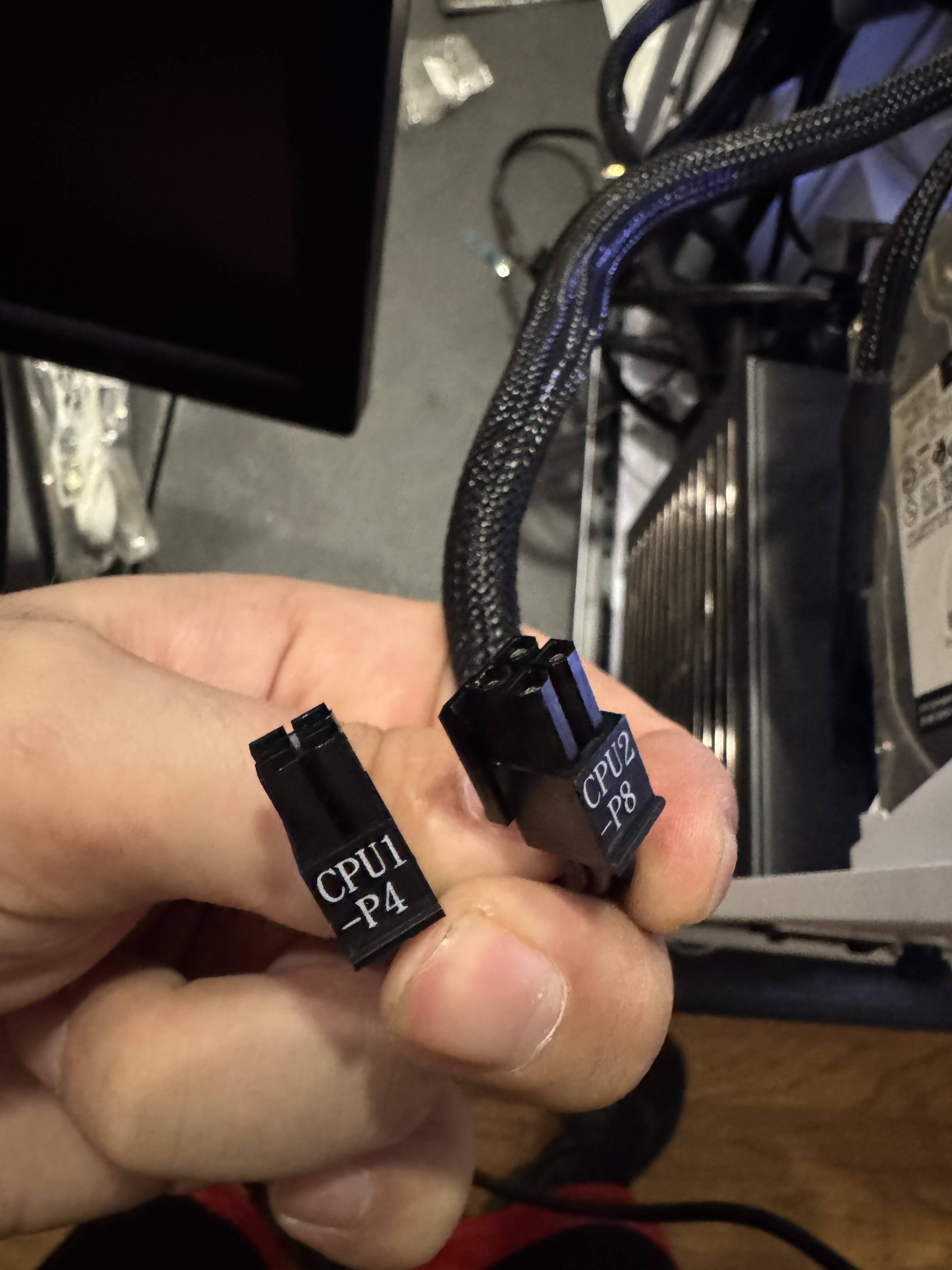

however I did end up getting the psu fan to spin that is only when I removed the CPU connectors for the PSU below are the 2 CPU cables I have and the items I’m running maybe I’m using the wrong CPU CONNECTOR

using the connector in the first picture only, everything seems to be turning on ie. PSU fan GPU and the AIO pump
I am now getting LED Diagnostic lights
When I first turn on I get red CPU then I goes away and then I get a solid
White VGA
green boot
Nope, it says CPU, it's the correct connector, is it clicking/locking into the slot when you get power connector in? (even if guides say so, some parts don't make audible click when slotting in, but some still have locking mechanism that tells you if it's secure or not - RAM, GPU slot, power connectors)

Yes update using the connector in the first picture only, everything seems to be turning on ie. PSU fan GPU and the AIO pump
White VGA
green boot
that does not
Should I be using both?
White VGA
green boot
that does not
Both CPU 8pin slots? Ideally yeah, if the PSU came with enough connectors.
And yes, if you have 4pin connectors for CPU in motherboard, you can use 2 side by side, it's bit of a work to plug those in though. If you do have this easiest way to plug these is to first 4+4 them into 8pin connector and then try to hold them and plug them both in. Because it might not even be possible to plug them 1 by 1 in 8pin slot, they have little bit of mechanism that's in way.

Thank you I got it to boot !
