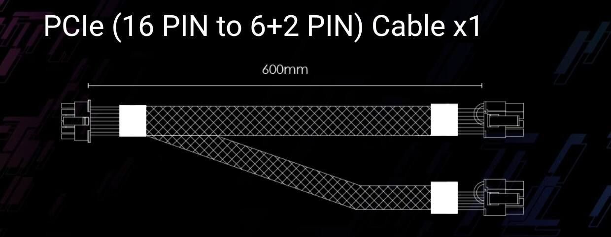

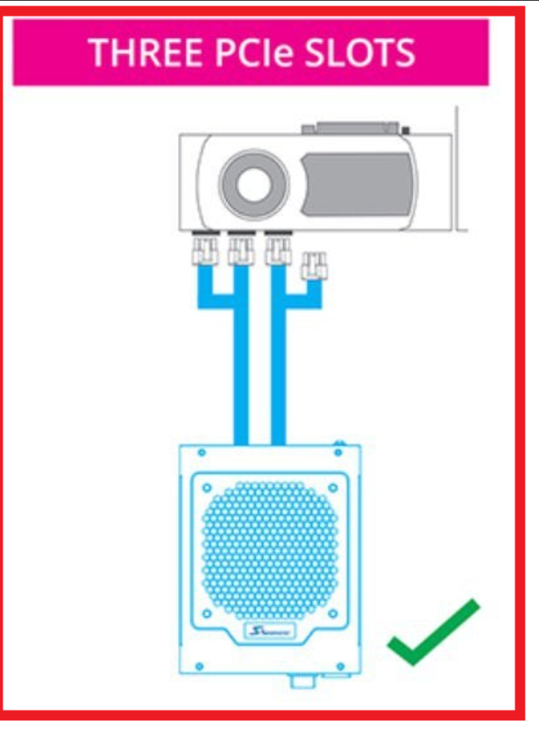

Hello,
I have a 9070xt Red Devil and MSI mpg1000g which came with a two 6+2 pin cables and one 16pin to 2 x 6+2 cables.
I just want to confirm that the correct way to connect GPU to the Power Supply is by using the 16pin (on the PSU) to connect to two 6+2 pin slots on the GPU and the connect the remaining slot on the GPU with a traditional 6+2 pin to the PSU slot.
Is this the optimal way to connect or is it safer to buy a new 6+2 cable from MSI?
Thank you.

1 minute ago, Zero23 said:
This cable
Yeah I was looking at the website for the power supply.
I have never seen a cable like this before.
But it definitely doesn't go the other way since the 16pin is rated for 600w while each of the 6+2 is rated for 150w each so thats not enough.
I would say that it goes the way you thought in your first post.  16pin to PSU and 2x6+2 to GPU.
There are a few threads on Reddit that say the same thing as well.
Thanks for confirming!
