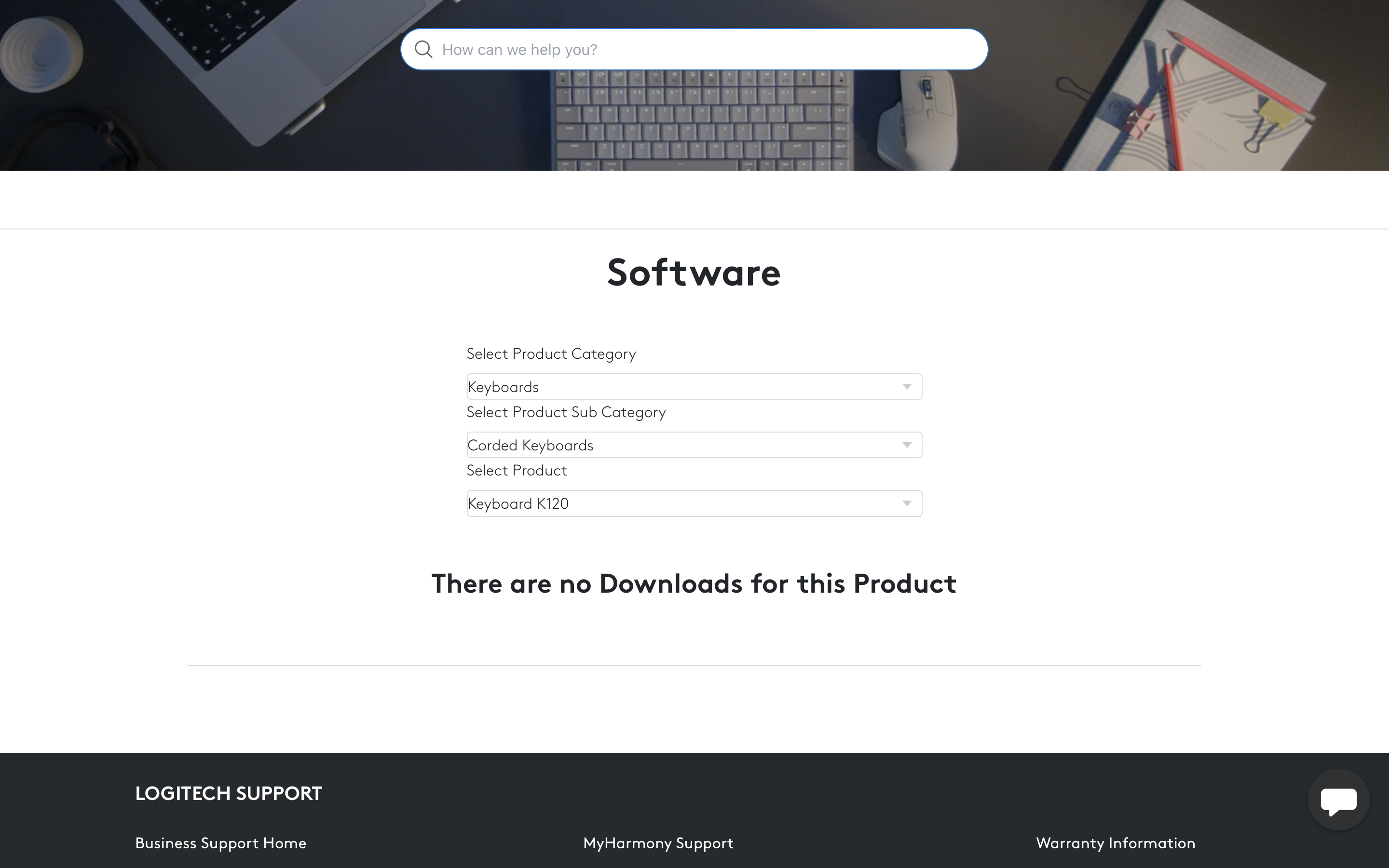

I've been watching videos on updating keyboard drivers but when I go to Device Manager I have no "Keyboard" section, and therefore no drivers to update, as if whatever drivers I had before have just up and left. If it helps, my keyboard is a cheap Dierya one from Amazon and the other one I tried is the $10 Logitech K120.
