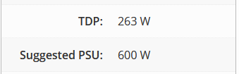

Hi i'm asking just to be sure i'm not missing anything but i found a fantastic deal on RX 7800XT and from what i've seen it seems to be the same PSU Requirement as with the RX 7700XT right ?
OC version shouldn't need more than 800W PSU:

5 minutes ago, Hinjima said:
OC models use the same amount of wattage as non OC models.
no they don't, they wouldn't need extra 8 pin if they did
current PC:
PC configs I used before:
extra 8pin power might be unnecessary, but still:
current PC:
SO if i understand things correctly i'm looking at only a max of ~50w increase over the 7700XT and my Corsair 2025 RM750e should still be fine and not loaded to heavily right ?
