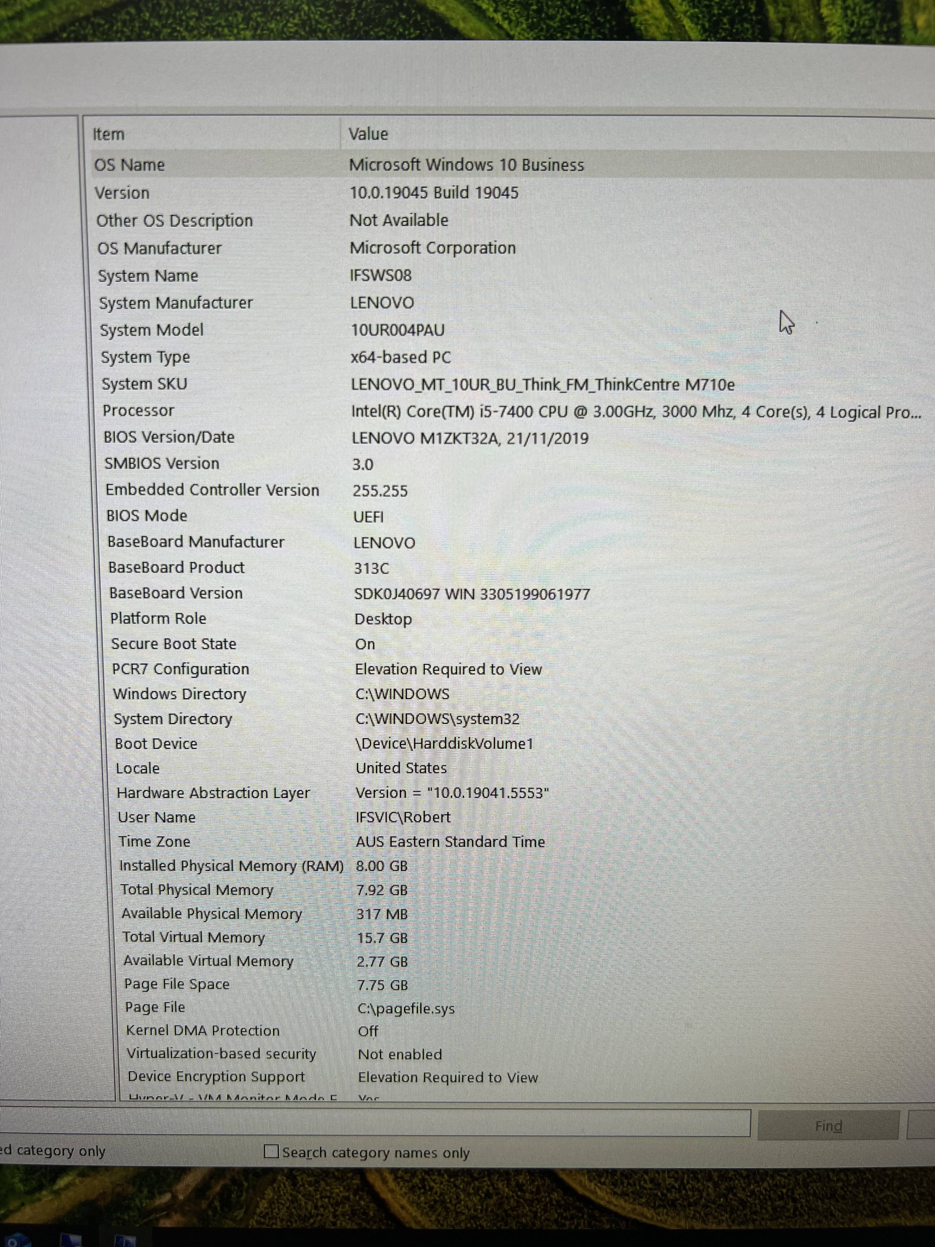

We've just updated our computers at work and wondering if the attached specs would be ok for use as a NAS.
planning on adding (provided there's space) a couple of gen 3 m.2 drives and run Hex OS
Any feedback before I get it all setup would be appreciated.
Main use is my side huddle files for solidworks and image editing as well as my Plex location for my nvidia shield

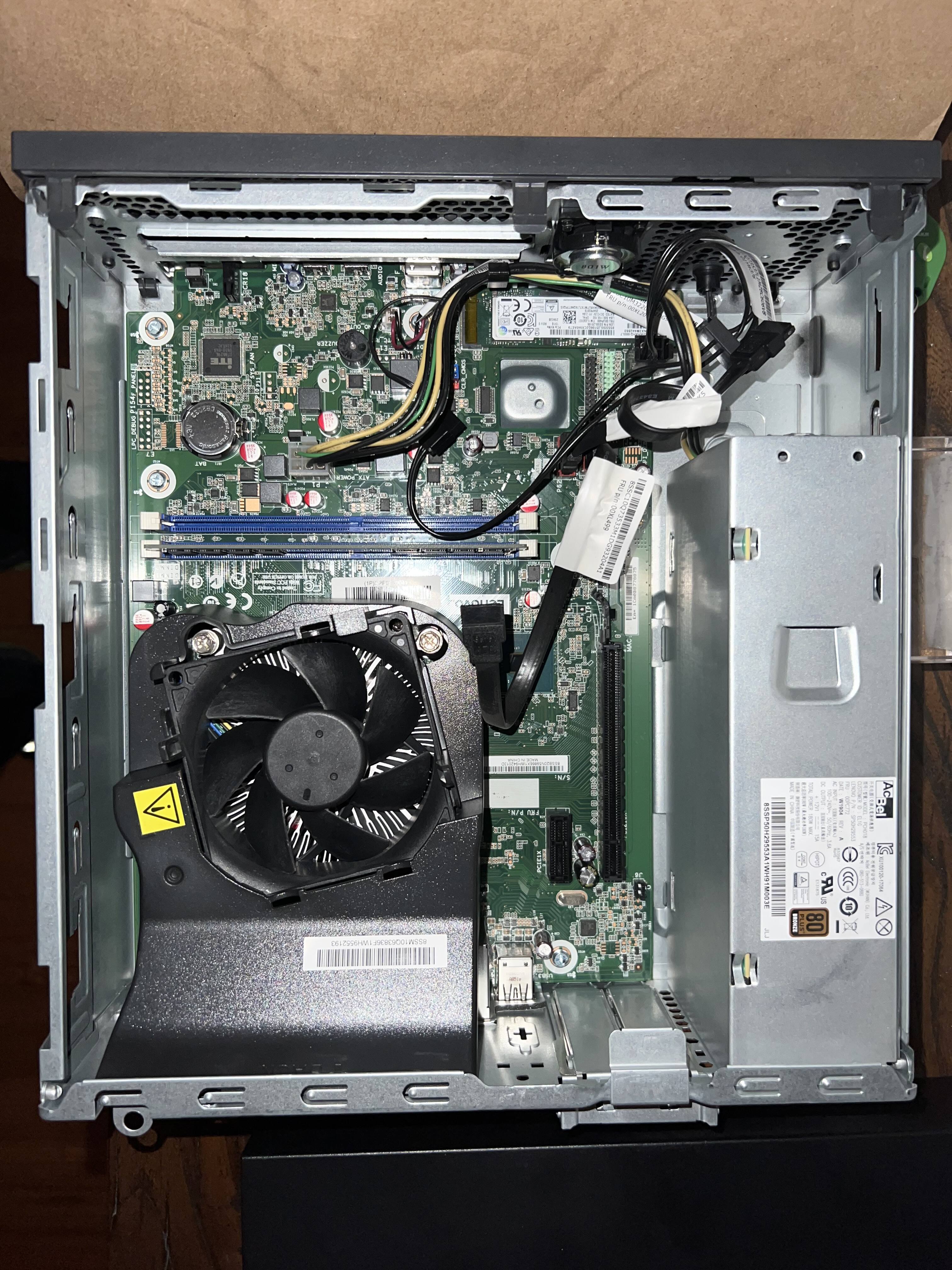

managed to snag a photo if you're interested

Aha a sff system always annoying to use.
Pcie is half half height here so you lose 90%+ of adapters.
Looks its been stripped of its hdd cases so that sucks
Safest bet is 2 sata ssds and call it good.

Thanks mate, was looking at a m.2 adaptor with 2 x 1tb drives but I'll look at a sata adaptor and maybe 3d print a holder in the for the drives

Yeah m.2 and sata are the same if you can find a low profile m.2 adapter it can work. KEYWORD low profile since these are half height pcie brackets

I got a 4 block one but then slot doesn't have the option for dual mode.

Ah you got a passive one yeah forgot to mention that you do need one with a controller.
No need for a gaming pc really. Just a normal desktop pc is heaps to boot. These office rigs make great nasboxes just get normal sized ones.
