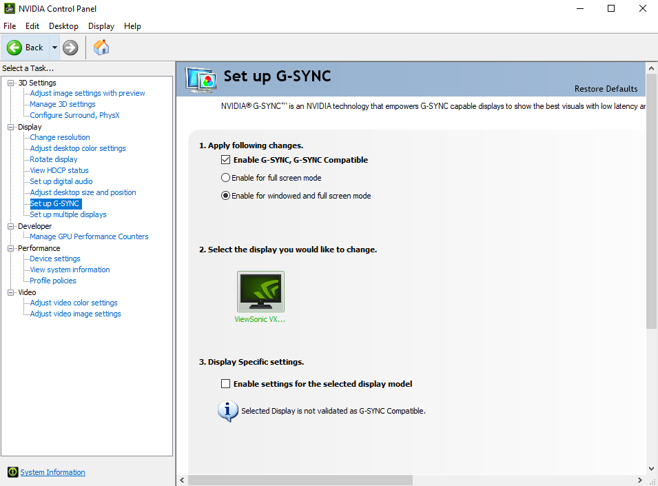

I have a VX24G10 which supposed to be G-sync compatible but apparently not? Or am I missing something? I have already turned on VRR from monitor settingsimage.png.648b5c04e2b1a1f19fe5f5cce77b9bca.png
It sure is, as are most displays today. Just doesn't have some fancy and worthless validation from Nvidia to prove it.
But you have GSync on, so it works. Check the box for Enable settings for the selected display model. Or better yet, ditch that ancient program and that confusing 3rd option and just use the NVApp.
AFAIK NVApp still doesn't have all the features of Nvidia Control Panel.
I personally still use G-Sync indicator:
Didn't find it in the app, and more annoyingly I have to manually re-enable it after each driver update...
I don't mind the green text in the top right corner, and for my monitor and GPU it pretty much fails to G-Sync once every couple of weeks (simple reboot fixes it).
Could I spot it without the indicator - sure, but only after being annoyed by it being off, so I prefer the indicator.

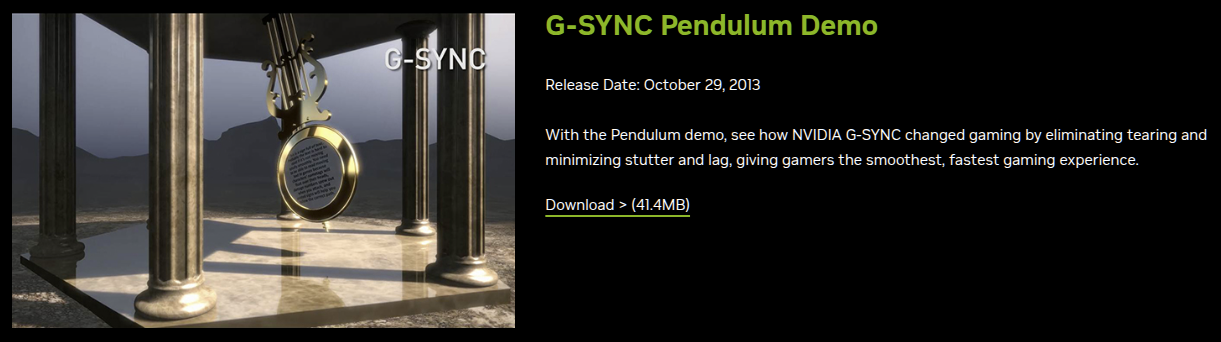

@LegendaryDragon if you are unsure if G-Sync is working you can tick that checkbox,
also for quick testing, I prefer starting the Nvidia G-Sync Pendulum demo (because it is very quick to launch):
https://www.nvidia.com/en-us/geforce/community/demos/
