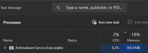

’’Hi friend, Im writing this post in desperate need of assistance I have been having issues with my system frequently rebooting/blue screening on me while Im playing my games I have been coming across this issue where my system seems to be checking along even if I play a simple game attached below. I have provided a screenshot of all the games I currently have installed into my system, as well as a screenshot of a process that I am unaware of how to get rid of in my task manager whenever I try to click on and task on the specific process it tells me access tonight. I find this very concerning particularly for the fact that as you can see from the screenshot, even when the system is running at idle, the process is taking up 18% of my memory been with making it so that when I play any of my games/might have Spotify open or chrome or even Discord a good portion of my memory your sister is already being put to its limit. I have had situations where I get up to 53 to 75 memory usage. I would also like to point out the fact that I personally have not had the chance to clean my system since I got it since I have a disability and it is difficult for me to lift my tower off of my desk to open it up and clean the system from the inside If anyone has any suggestions as to what I can do, I would greatly appreciate the feedback. Also separate from the advice if anyone who lives in the Westchester/Yonkers, New York area is willing or able to communicate with me about coming over to assist me in cleaning my system I would greatly appreciate it as well

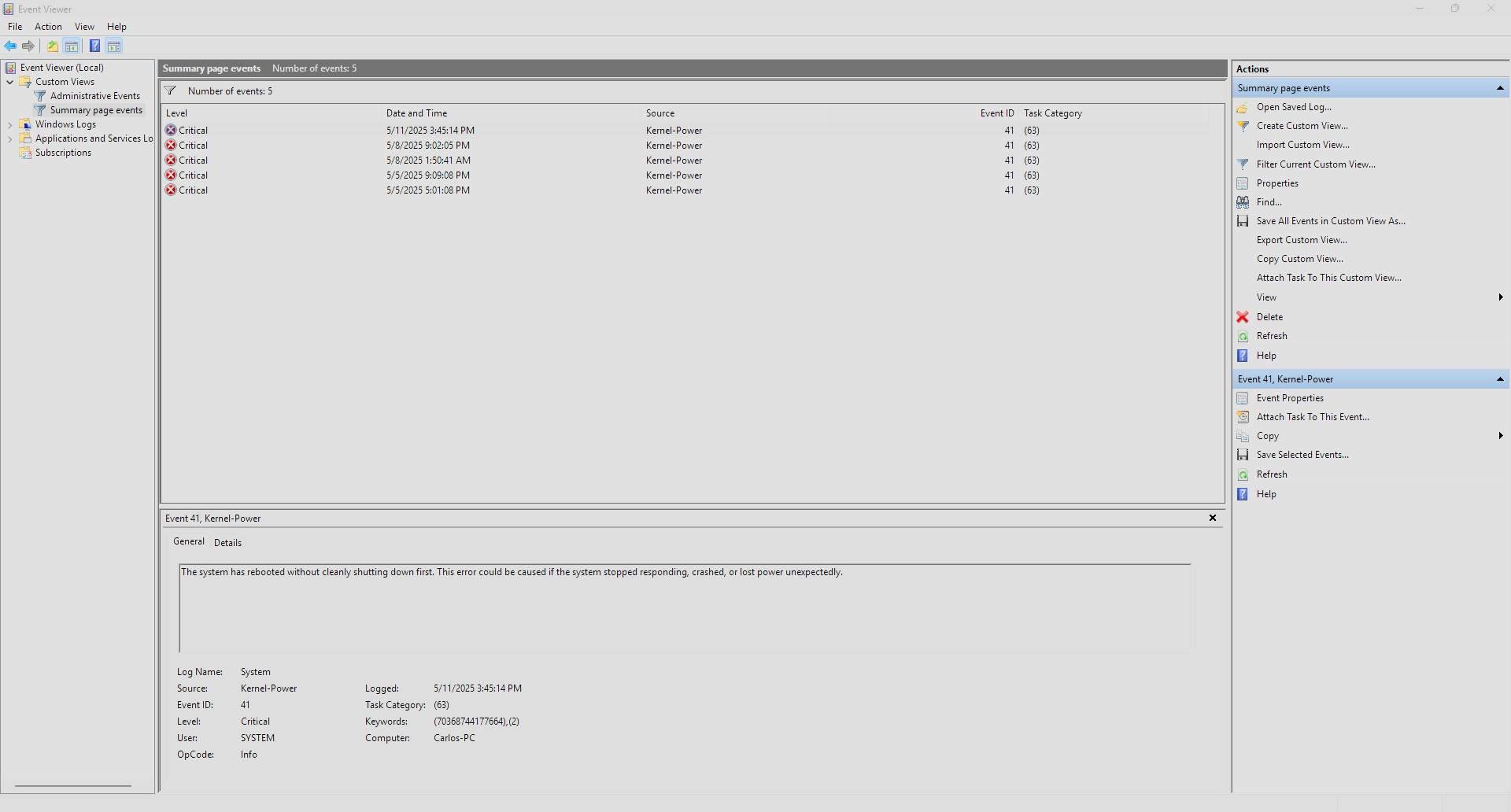

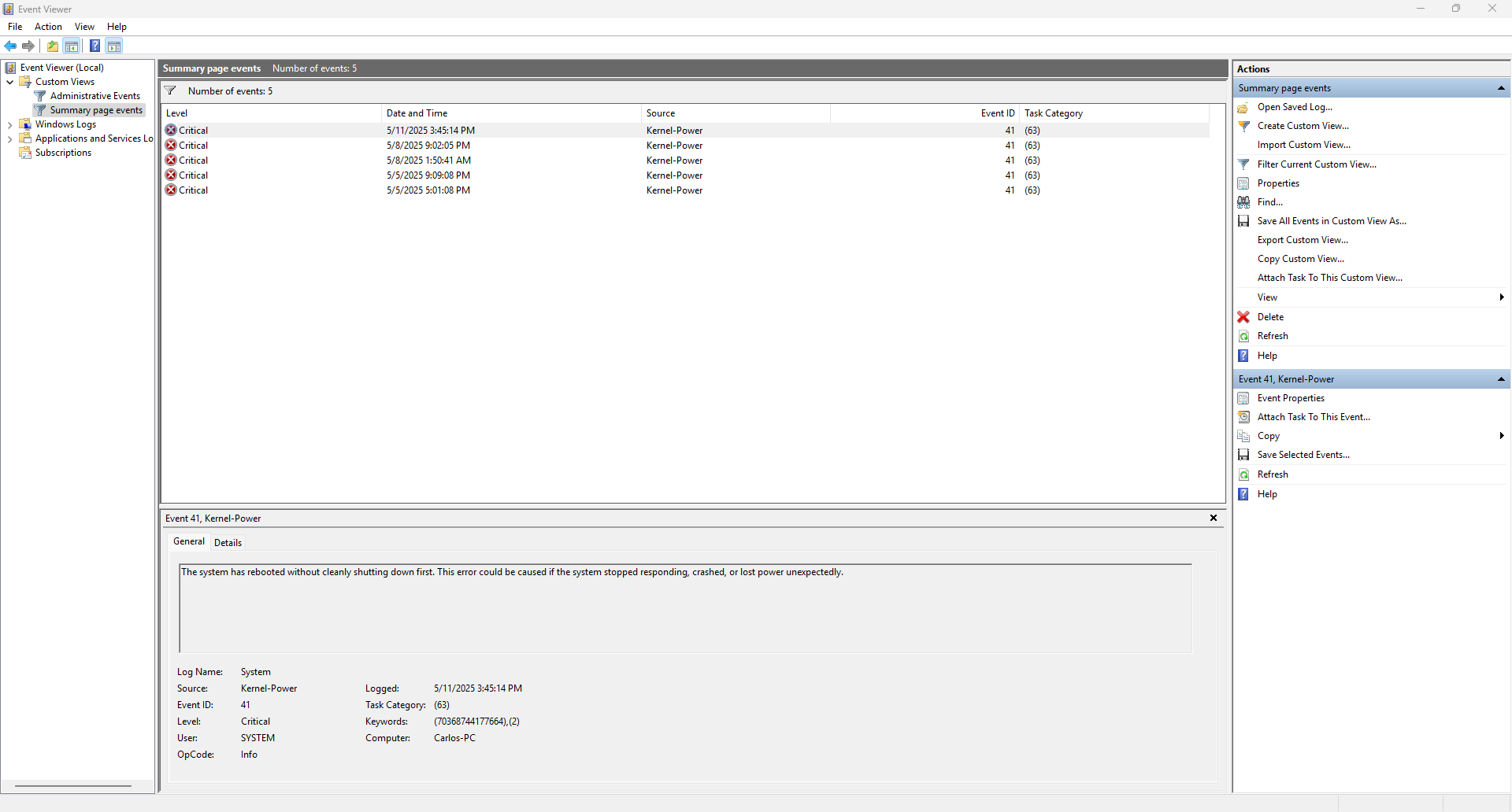

Thank you for your feedback. I was able to look into my event viewer. as you suggested, and I found this.
- System
  - Provider
   [ Name]  Microsoft-Windows-Kernel-Power
   [ Guid]  {331c3b3a-2005-44c2-ac5e-77220c37d6b4}
   EventID 41
   Version 10
   Level 1
   Task 63
   Opcode 0
   Keywords 0x8000400000000002
  - TimeCreated
   [ SystemTime]  2025-05-09T01:02:05.1039032Z
   EventRecordID 3058
   Correlation
  - Execution
   [ ProcessID]  4
   [ ThreadID]  8
   Channel System
   Computer Carlos-PC
  - Security
   [ UserID]  S-1-5-18
- EventData
  BugcheckCode 292
  BugcheckParameter1 0x0
  BugcheckParameter2 0x0
  BugcheckParameter3 0x0
  BugcheckParameter4 0x0
  SleepInProgress 0
  PowerButtonTimestamp 0
  BootAppStatus 0
  Checkpoint 0
  ConnectedStandbyInProgress false
  SystemSleepTransitionsToOn 0
  CsEntryScenarioInstanceId 0
  BugcheckInfoFromEFI true
  CheckpointStatus 0
  CsEntryScenarioInstanceIdV2 0
  LongPowerButtonPressDetected false
  LidReliability false
  InputSuppressionState 0
  PowerButtonSuppressionState 0
  LidState 3
  WHEABootErrorCount 0

Ok thats a very common error. Last time I got this was because of bad ram. Its s good idea to post your specs. Try running bios completely stock apart from secure boot enabled. Clear CMOS, to make sure no weird stuff is happening
Make sure ram is placed in the correct channels (Slot A2 and B2 on most boards)
