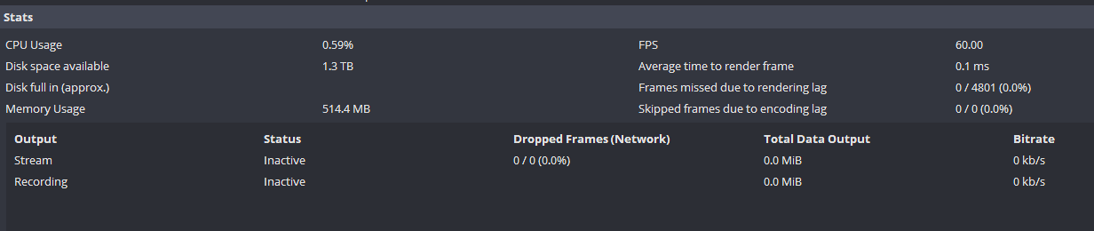

You're using this panel in OBS and the "Dropped Frames (Network) is the stat you're looking at?
Share your Output > Streaming tab. Should look something like this: (ignore my settings, i'm setup to stream to youtube at 4K)

I was only looking at the bar along the bottom of OBS. I got the stats window open rn, desktop capture with giftube avatar, but not broadcasting and dropping less than 0.1% frames due to render lag, with an avg. render time of ~1ms

You’re stream settings are in Simple mode so we can’t see details and I don’t know what that message from Twitch is all about.
