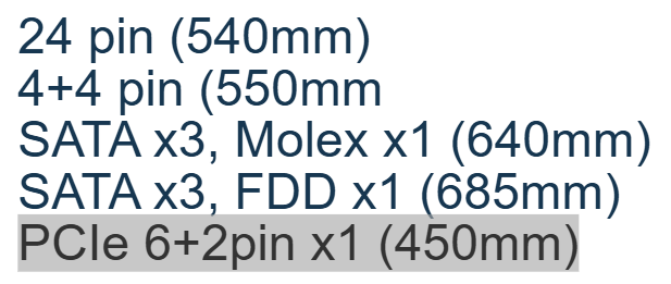

On another note, the specifications say the PSU comes with the following:image.png.458fcec9cd9e8487afea83e77bce1a32.png
Would these be okay for the setup? (Specifically the 4+4 pin for the motherboard and the PCIE 6+2 for the RX570, and the SATA for the SSDs.)

The 4+4Pin is CPU power and not motherboard power like thr 24pin.
The PCIE 6+2 is enough for the RX570.  Some RX570 models use more than a single 6+2 ( 8 ) Pin.
Its properly sketch. I wouldn't even dare plug that thing in a socket in my house.  Nope
