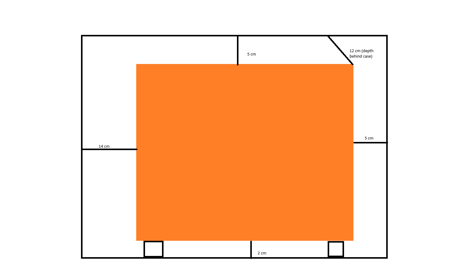

  • due to space constraints, the pc is right now sitting in a "box", basically a large opening in a cupboard next to my desk where it has only 1 side not blocked by a wall (which luckily happens to be the left side, with the perforated panel), and there is nowhere else for me to move it, nor can I change the furniture
  • it has some room on the 3 "blocked" sides, about a fist's distance from the top and more towards the back of it(drawing below), but I have a reasonable assumption that this "box" acts as a mini oven, trapping heat and probably making the problem worse

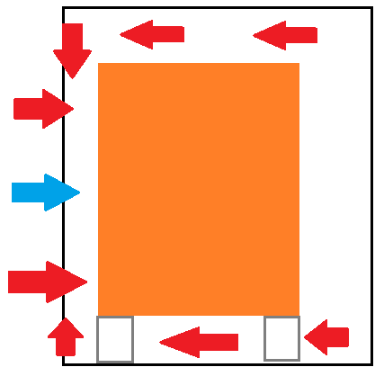

Youre also possibly experiencing this issue, as you have a full enclosure with only 1 side open, arrows are airflow, colour is temperature

Thanks for drawing this diagram, but I am a bit confused. Is the PC here viewed from the front, or from the left side (as my original diagram)? It looks as if you are looking from the front of it, but just want to make sure I understand it
Yes thats from the front, the left side being the open slot in the desk
