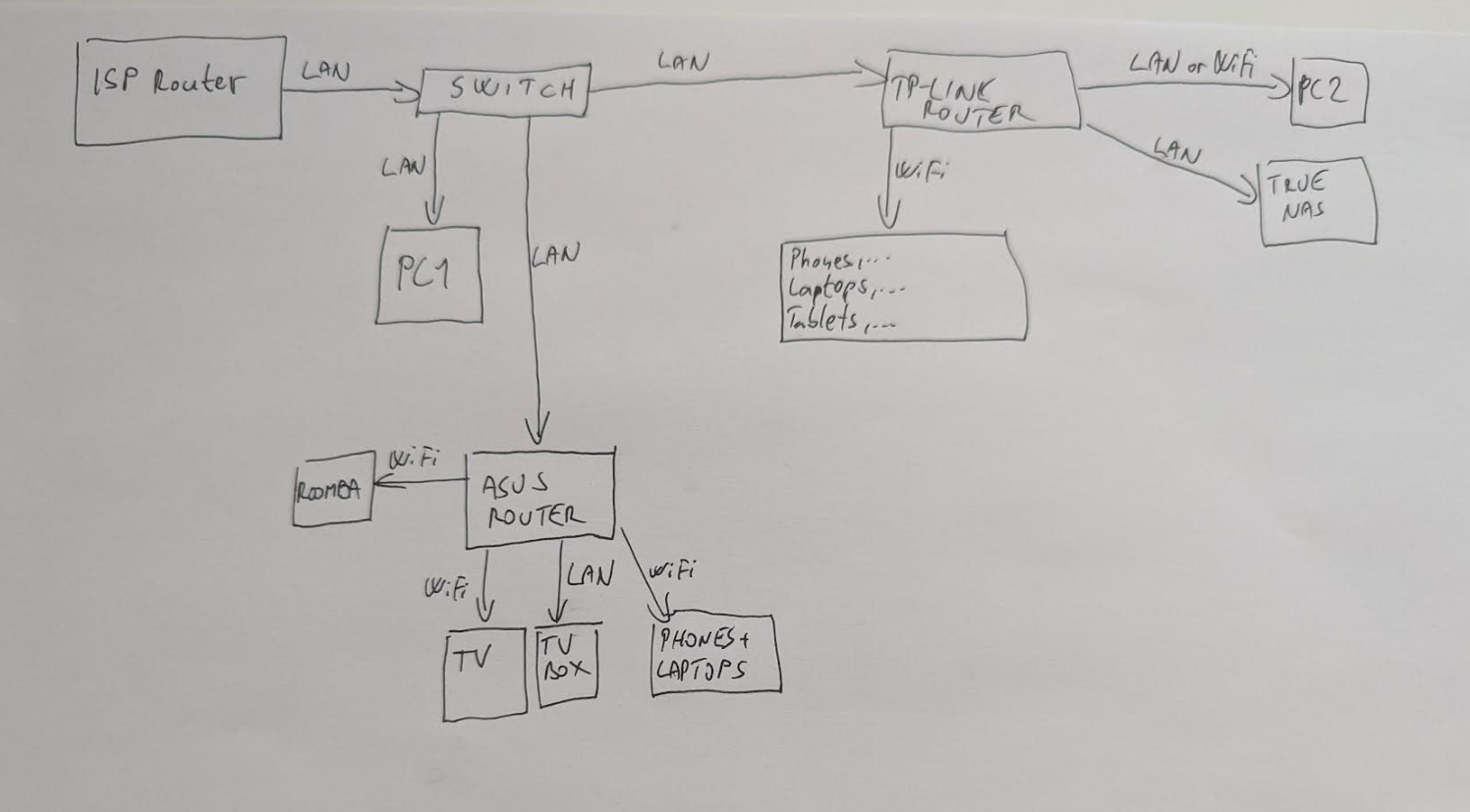

Can you help me figure out what I need to do so that I can make my other devices connect to my Jellyfin running on TrueNAS? I have to connect to the TP-Link router to be able to use it but I can't connect half of the devices to this router and if I want to do ANYTHING that's on the NAS I have to be connected to the TP-Link.
This is my network setup at home.
Are these two routers actually set up as full routers? That's usually not recommended unless you want two independent networks. Most home networks should only have a single router controlling all of the traffic.
Any other router should be set up as simply a wireless access point (WAP) - most routers allow you to run them in this mode. It disables the routing functionality, but still gives the network access to its WiFi and network switch capabilities.
The TP-Link router shouldn't be acting as a router, only as an Ethernet switch and WiFi access point.
Having three routers means you've got three separate networks stuck together, so only PC2 and the devices on the TP-Link's WiFi can access TrueNAS.
EDIT: Make sure both the TP-Link and Asus routers are set to not be routers, whatever each one calls that setting.
Having two routers means you've got two separate networks stuck together, so only PC2 and the devices on WiFi can access TrueNAS.
Thanks. Stupid mistake. ASUS is set as a WAP but TP-Link is as Router. I though I've set it up like WAP as well. I had to dig trough settings to find it now
I'll try to change it and will let you know it that worked.
