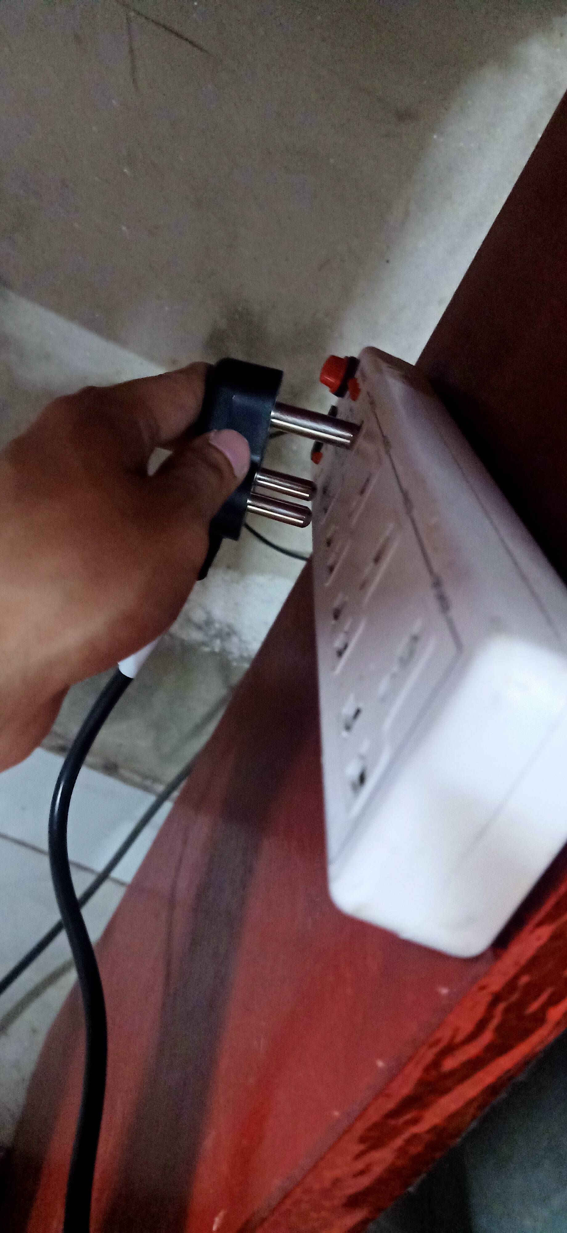

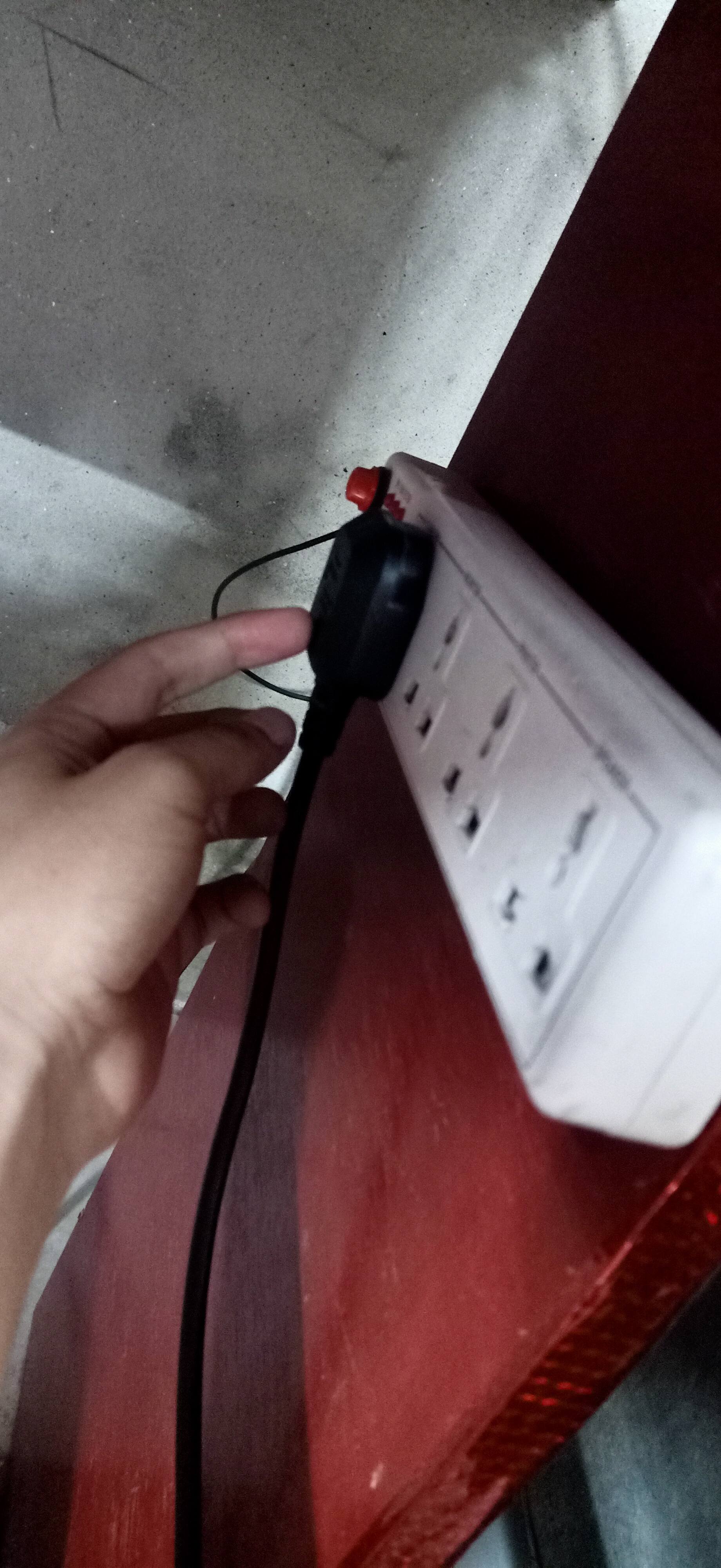

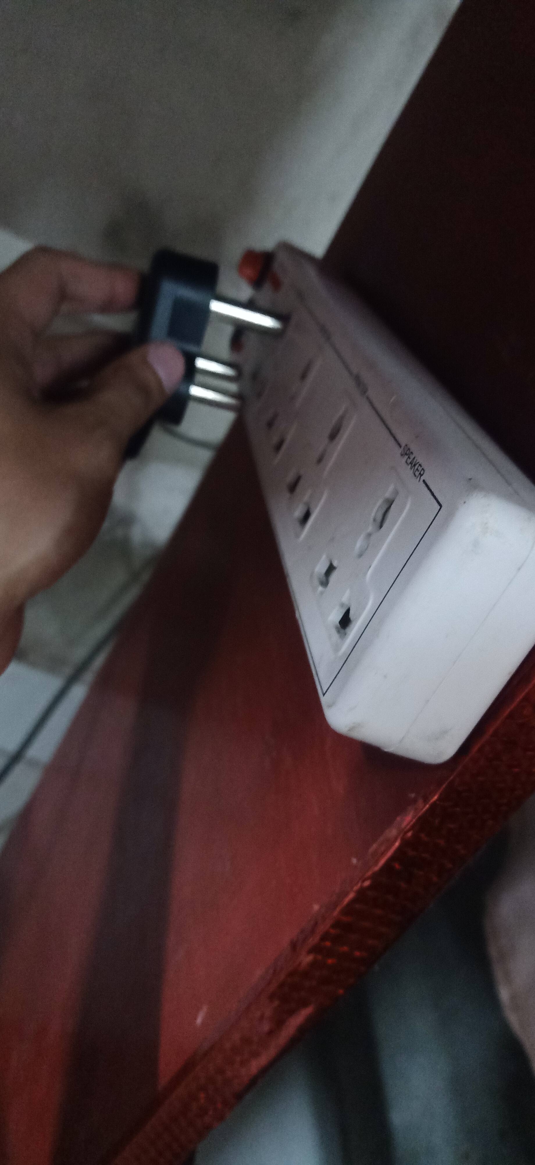

I changed my psu and the power cord which it comes with is so big, it doesn't fit in the power bar socket
can I use the old power cord?
here are some pictures

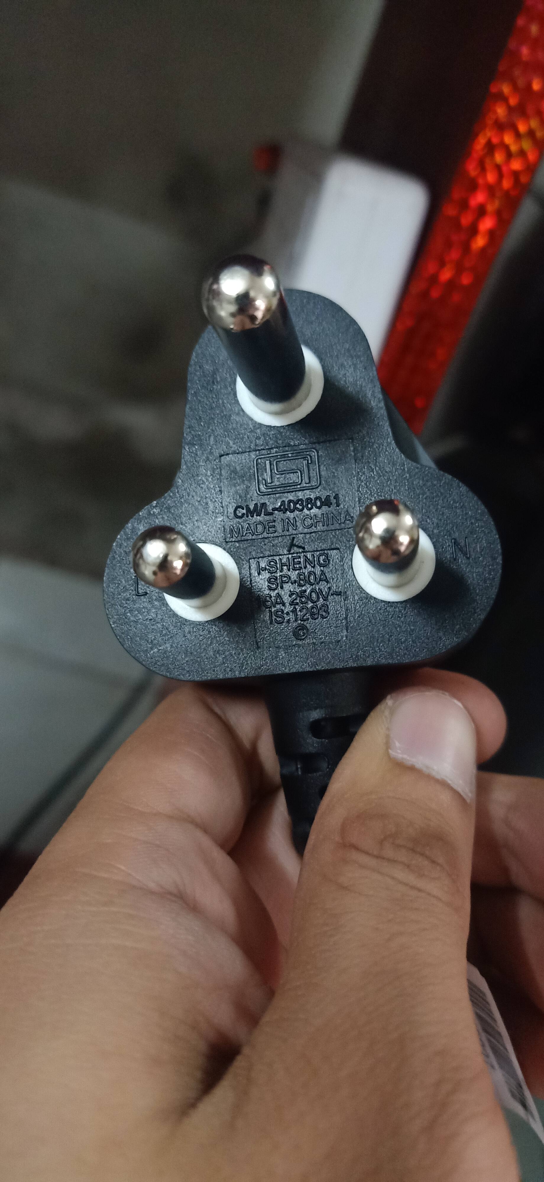

this one from the old psu
the big has 16A 250V (socket outputs 220-240V probably)

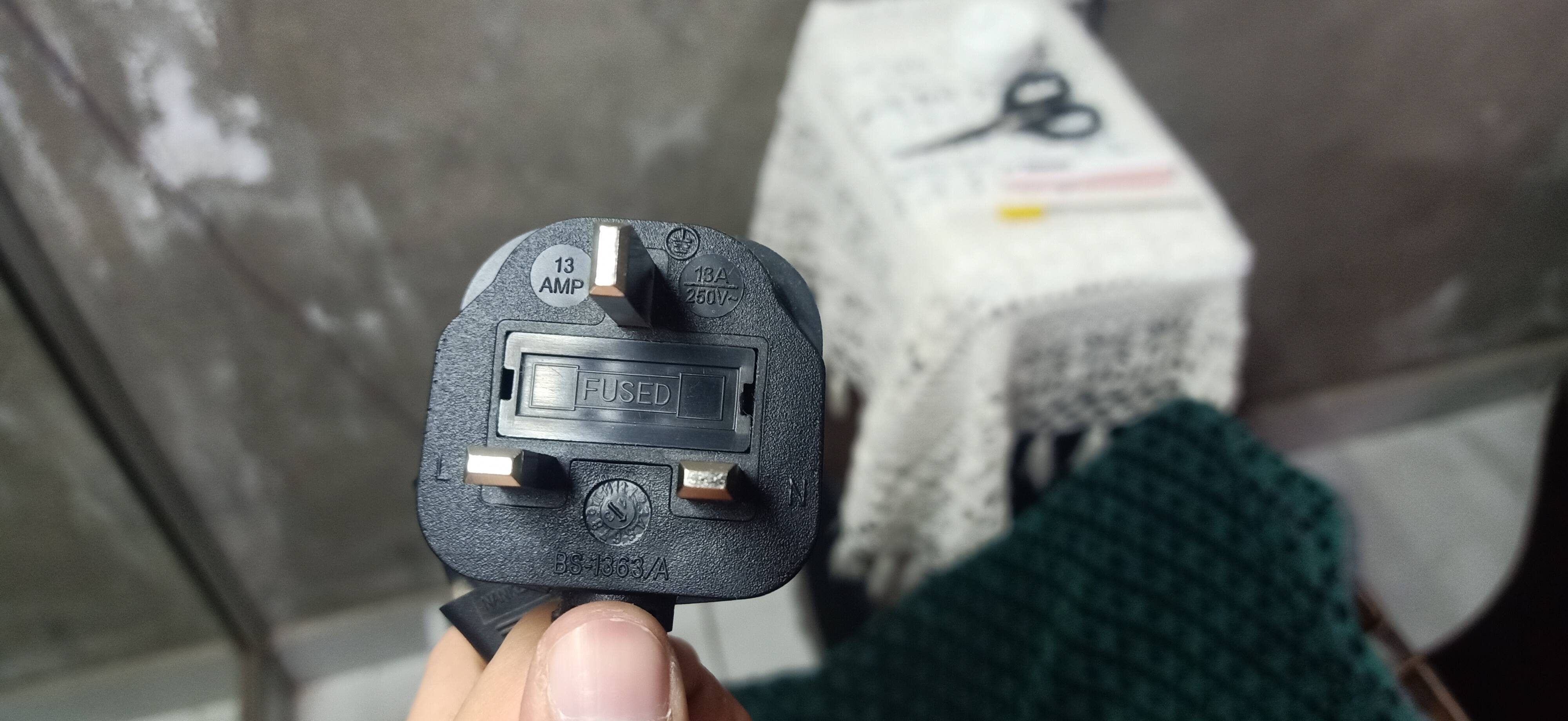

and the other is 13A 250V
please keep in mind that both PSUs are not modular
only the power cord
