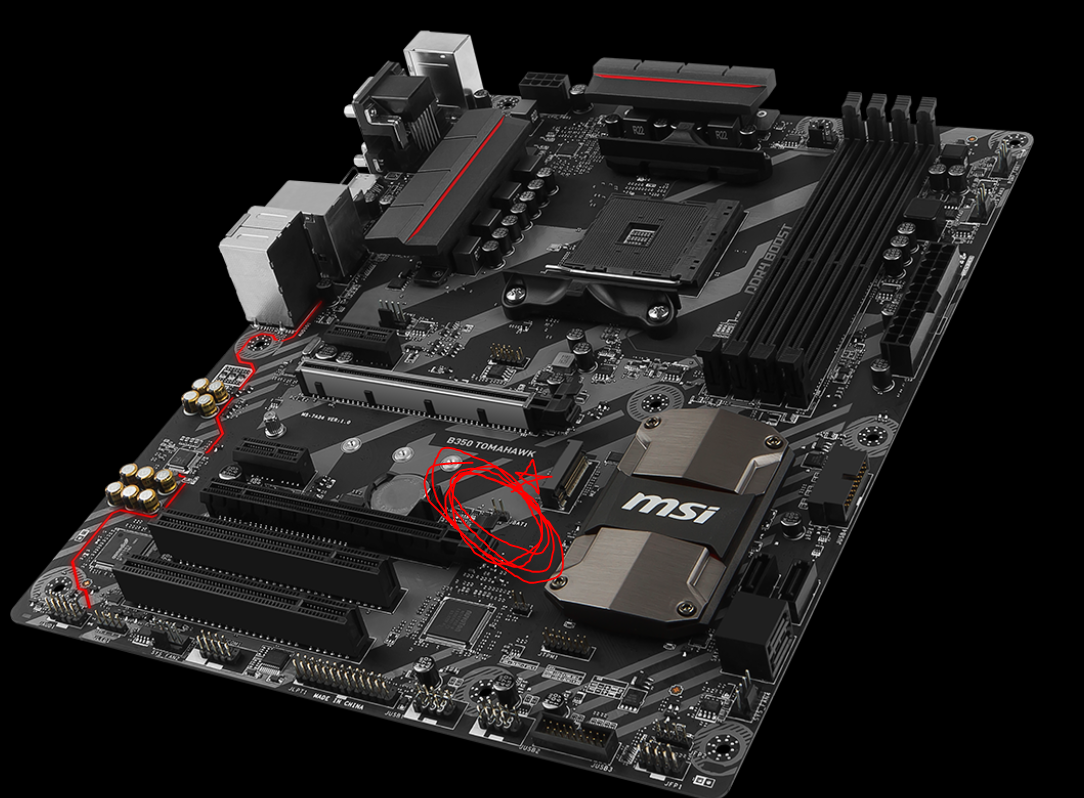

I recommend clearing the CMOS.
Connect these two pins together with a screwdriver, or other small piece of metal, for more than 10 seconds
