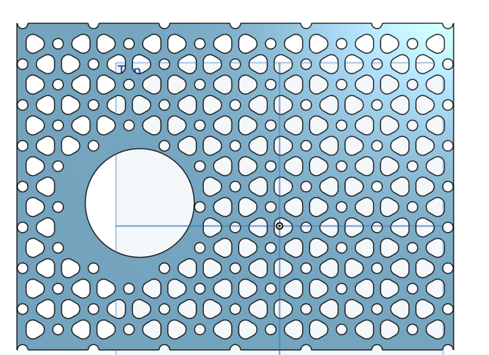

this is what I have so far.

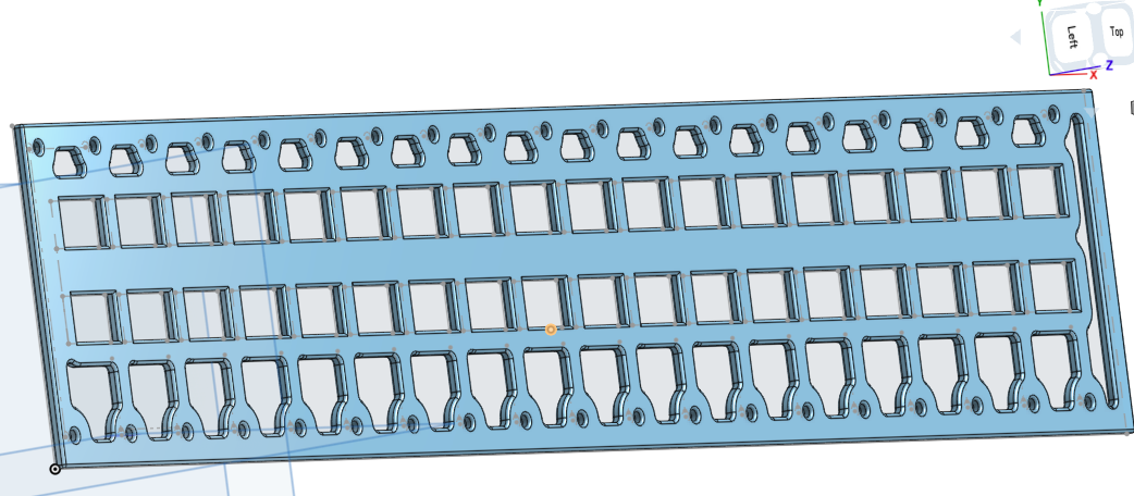

it's 19 inches long, 3.6 inches tall, the holes are 1/8 inch in diameter and spaced apart 1 inch, the ethernet holes are 0.5 inches tall and 0.75 inches wide, and every edge is rounded. I also made a lightened version.

here are the step files for the two. I use Onshape with is browser based
server cabinet panel.step server cabinet panel lightened.step
