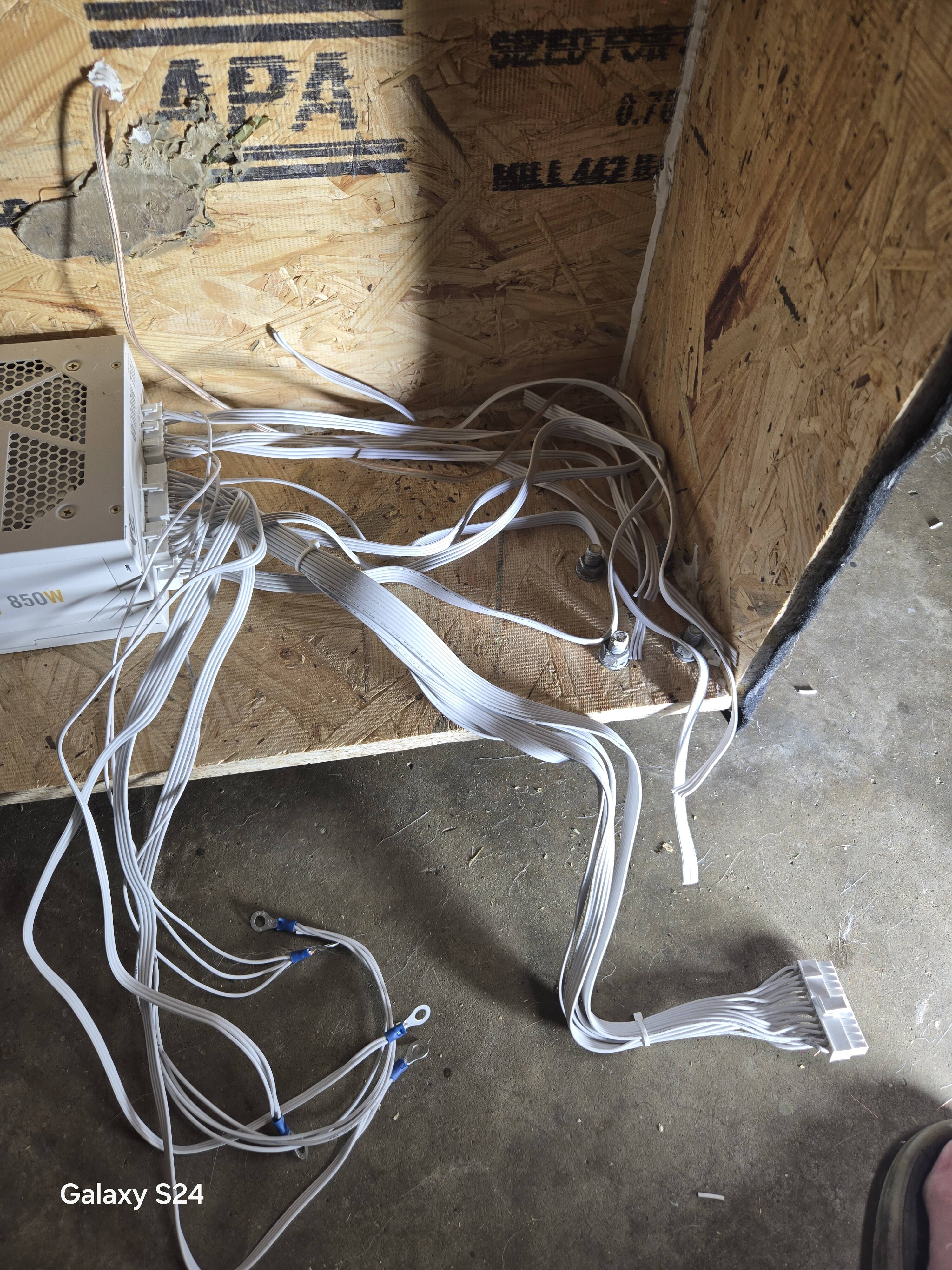

I am using a 750w Single 12v rail power supply as a 12v source. I have isolated all +12v circuits from their respective plugs(pci-e/molex/IDE, etc.). I will use all these to make a 12+ terminal to power 3 speakers and an Android Auto headunit.
My Question is. What can i do to create or tap into as a ground terminal for these 12v items(Head Unit, a small 300w Subwoofer Amp.) I may also try to tap into other rails for USB charging ports. Will that also require a ground?

To turn on the power supply, you need to connect the PS_ON pin to ground, any ground.
You shouldn't have damaged your power supply connectors. You could have bought pci-e extension cables and cut them in half to get access to the wires, for example : https://www.amazon.com/Pin-PCI-Power-Cable-Include/dp/B08ZRX37GF/
