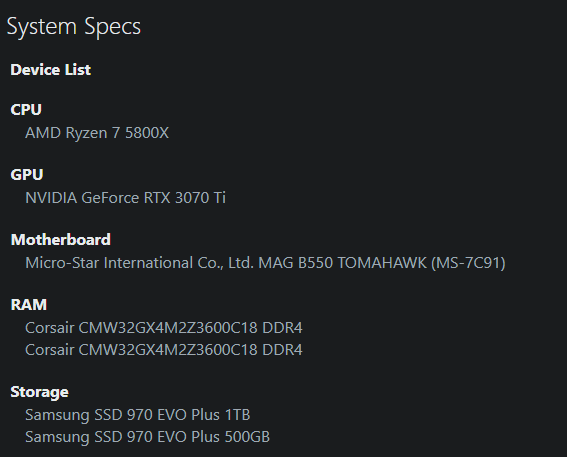

I just bought myself another M2 NVMe from Kingston and wanted to put it inside my PC. As I already have 2 M2 SSDs installed.
I bought myself a "Akasa M.2 SSD to PCIe Adapter Card" and tried to screw it into my PC.
The PC works fine, but the new Kingston M.2 does not show up in "Disk Management. Does someone know why, or what I can do?
Please see attached file/links of my PC and the new hardware.

On 4/26/2025 at 2:12 PM, shokraaN_TR said:
1 x RTX 3070ti (16x lanes)
2 x M.2 NVMEs (4x lanes each)
That should use all my 24 available lanes.
Only the GPU and first m.2 slots are using CPU PCIe lanes. The second m.2 slot is using lanes from the chipset.
You should really check your BIOS settings for disabled PCIe port, that's the most likely cause of your adapter not working at the moment.
