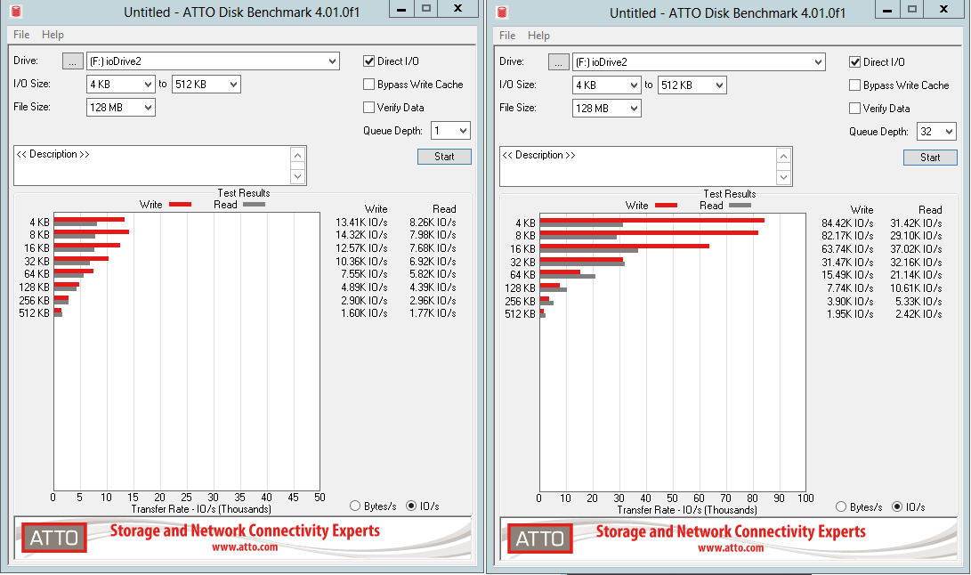

These are the numbers measured directly on the card on the server:

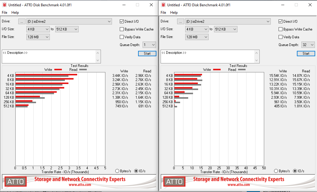

And this is the iSCSI performance:
Something's up with it because 4K QD16 read should be 250k, some measured even 330K QD64. Not sure what's going on, maybe a pci power problem, the card is not in a 75W slot currently, also the card is not set to pci power override (some FusionIo cards need that or a cable). I have to investigate a bit.
