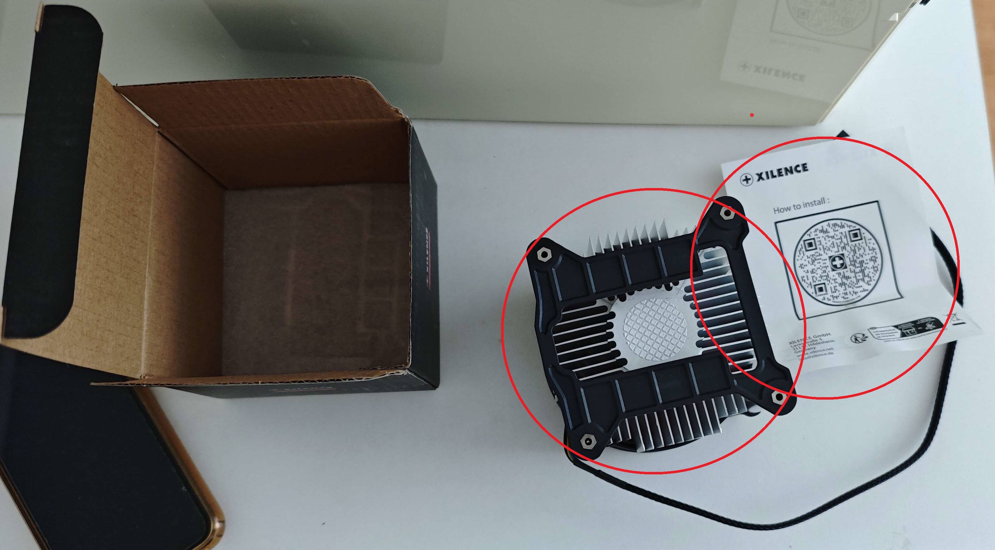

This one should've been easy because it uses screws but it wasn't easier, especially since there was no manual and I had to watch how youtubers did it in medium quality. The QR code links to this page: https://www.xilence.net/en/cpu-coolers
That's just a nonsense link and doesn't say how to install the cooler, if you scroll down to my cooler on the page and click on it, that link doesn't show a manual either. I searched for a manual but all I found was one for a different Xilence cooler and it was a really unclear manual, one page.
What I and the youtubers also received was four of the five things in the stock image, I didn't get the four screws in a plastic bag or anything else.
When I put the backplate on the motherboard it would fall out when I flip the computer so I had to put things under it to hold it up, I thought it would get attached to the motherboard tight enough to stay but you can pull it out (similarly to the AG200 backplate)
When I aligned the cooler on the motherboard and screwed in the pattern you know to screw in, only some of the screws actually got in, others wouldn't go in, I applied pressure onto the cooler and tried to screw 20 times and the screw was not in at all. The 32s video shows what it looks like.
Another annoying thing is that the cooler isn't in new condition anymore, they don't provide the thermal paste in a tube, it's pre-applied.

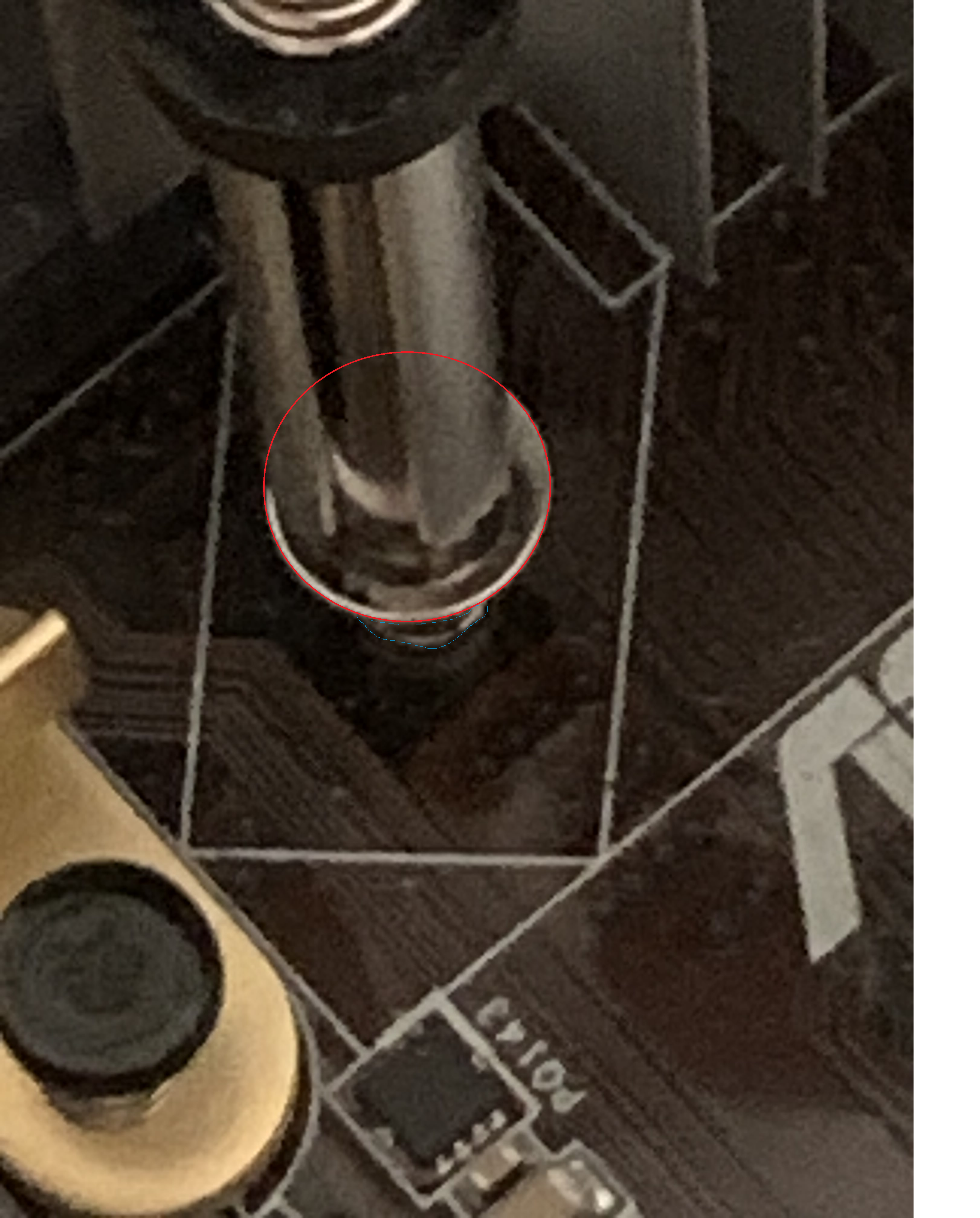

I wonder if my motherboard is blocking coolers from coming down as much as they need to, but I also wonder how the thermal paste is being applied to the CPU then, it has to be making full contact then, but I drew red circles around the ####s I suspect in the image.

image.jpeg.f513276b2c9827fbd53a7fbcf3e3f752.jpegbef3b1bf2cddddacb43ece41e5a97c27.png.ebbb1dd5fd1acb6fbd54f2ea44200cf6.pngIMG_20250425_142144.thumb.jpg.ba1bf57b0e5b1188bc8dc5bd3050475d.jpg
The cooler is also sitting on top of my CPU, is that going to make it stay usable? If the case stands up the cooler stays attached, probably forever but at least temporarily, but it's loose which will result in thermal throttle.
The area around the socket usually complies with dimensions that have been specified by Intel and third party coolers follow those guidelines. Those capacitors should not (in theory) block any cooler that is compatible with the socket.

I have an important update, I just tried screwing them on again and it looked better this time, I used a lot of force to get the loose screw in and I did it. My question is if all screws need to be completely down? I managed to screw one down using the same amount of force I used to get the other screw into the hole, so completely that the red part made the blue part invisible. I forgot to check what orientation the backplate is, but when I put it on I made sure it's the same this guy did:
I drew blue lines, you may need to look a little to see them.

49 minutes ago, PolishGod said:
Those who don't want to help may leave, the others can help by clarifying if the screws need to go down as much as possible or not.

If the heatsink is pressing on the capacitors and other components, that is an issue. Is there any space at all between the heatsink and components? Usually there is a cutout to prevent contact but that unit looks totally flat on the bottom.
Edit: I see there is a cutout. But is it deep enough?
I don't know, I think it is making contact with the CPU but that doesn't mean it's screwed tightly enough, my question is if I need to screw it down so much the part with the blue outline is out of sight, I asked Xilence this question and they don't know which is a surprise.
