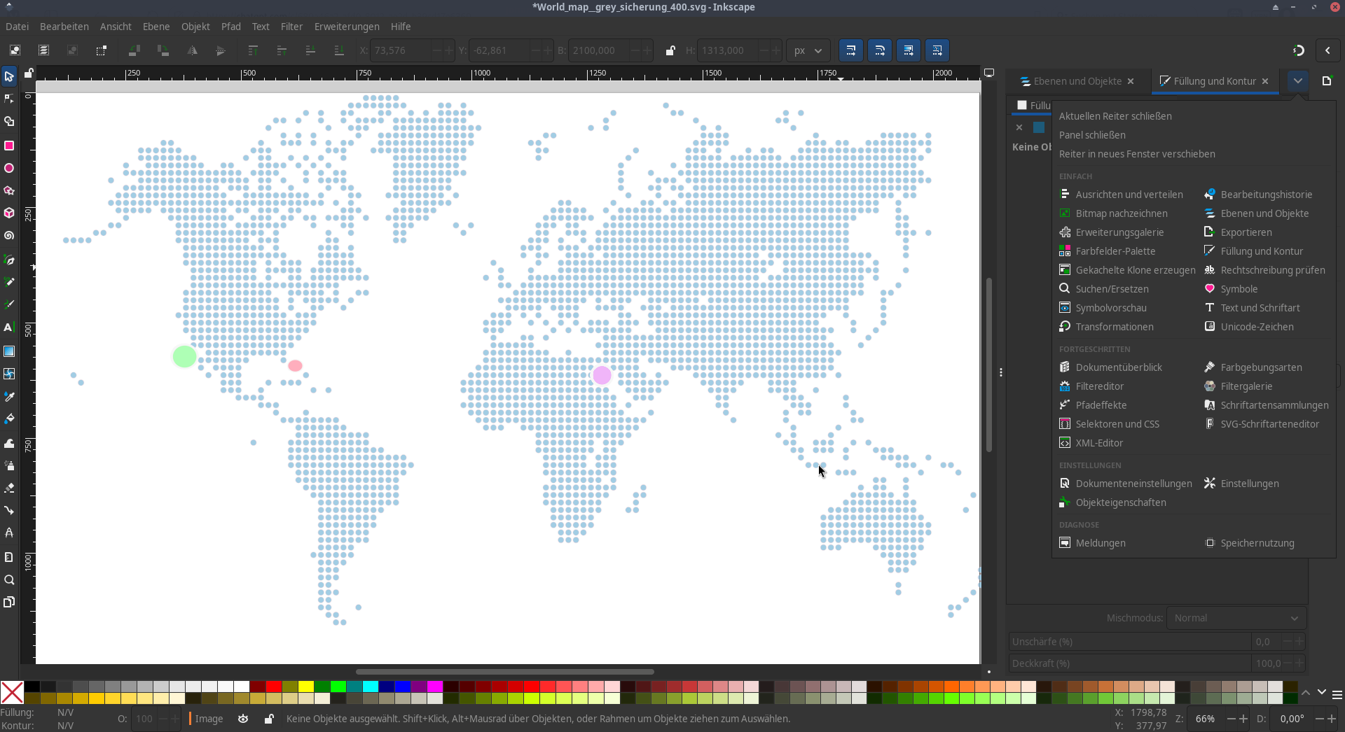

The tool you have selected in that image is select. The problem is that your image has been grouped as single object. You need to break it to parts first, then you can select individual objects. The tool right below it is to control nodes. If you use that, you can see all the nodes that object is made out of.
good evening dear Experts 🙂
well i currently dive into the Inkscape-program - and i still wonder - where i can find the tools to "select" a part of the image:  i am wondering which is the tioil to take
well dear friends - i am looking to find a solution - for the above mentioned probleme.
how on earth - can i find the tool that suppotts the "select? - look forward to hear from you

many thanks for your reply and the in - depth going explanation. Glad to hear from you. This is helping alot!!!

you mean that my image is a group: In Inkscape, a graphic can be grouped. This means that several individual objects (such as paths, text, shapes) are combined into a single unit.
When i select this group, i always select the entire group, not individual parts.
is that correct? Did i get you right here!?
hmm -  afaik:  a solution could be: Ungroup: To edit individual parts, i ll have to  ungroup them. Here's how:
first step - i have to select the image.
Press Ctrl+Shift+G (that's "Ungroup") or
then i lll have to go to Object → Ungroup in the menu.
Edit nodes: The "Node Editor" (a tool below the Selection tool) allows us to access the node level. Nodes are the small points that form paths. With this tool, we can change details of the paths themselves—for example, deforming curves or moving lines.
