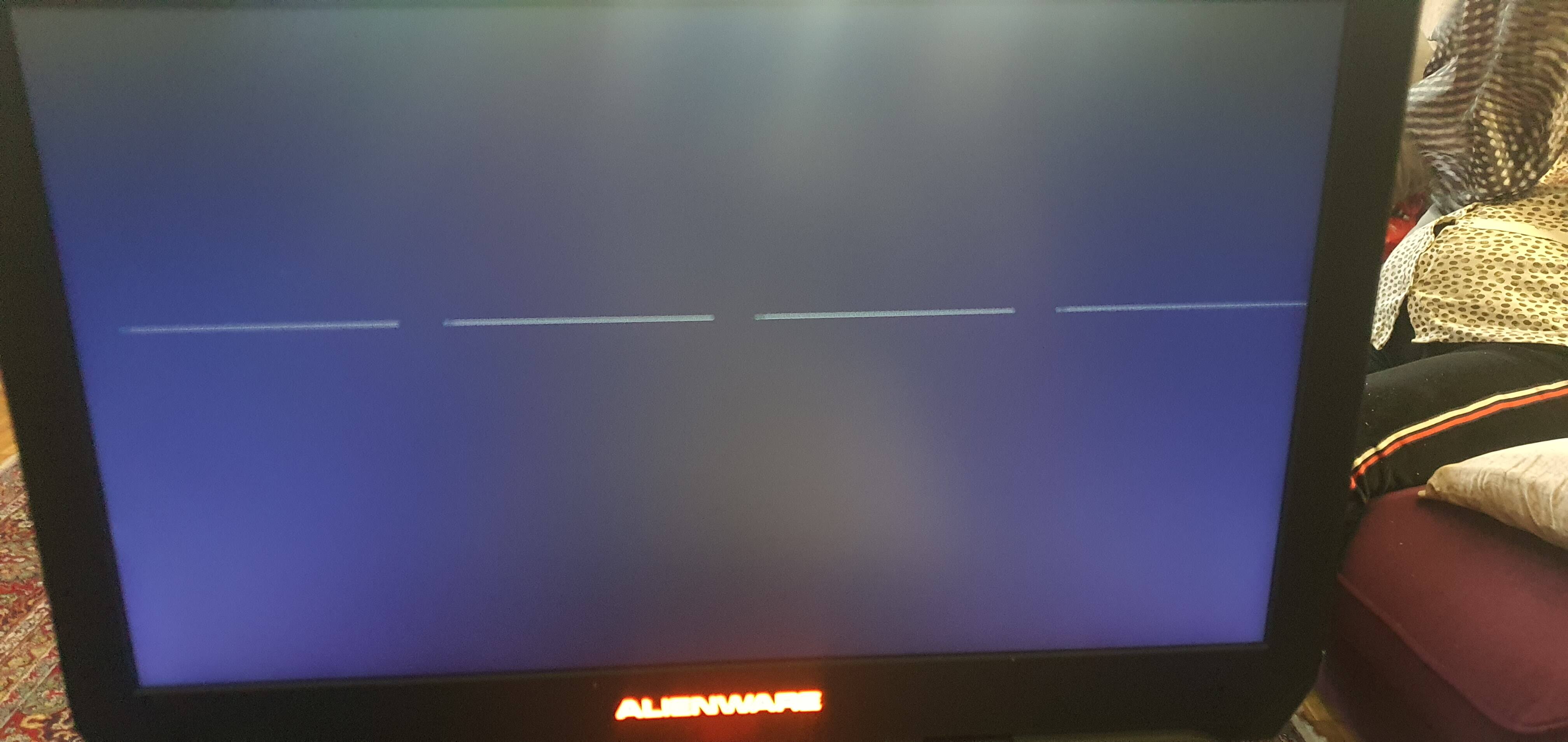

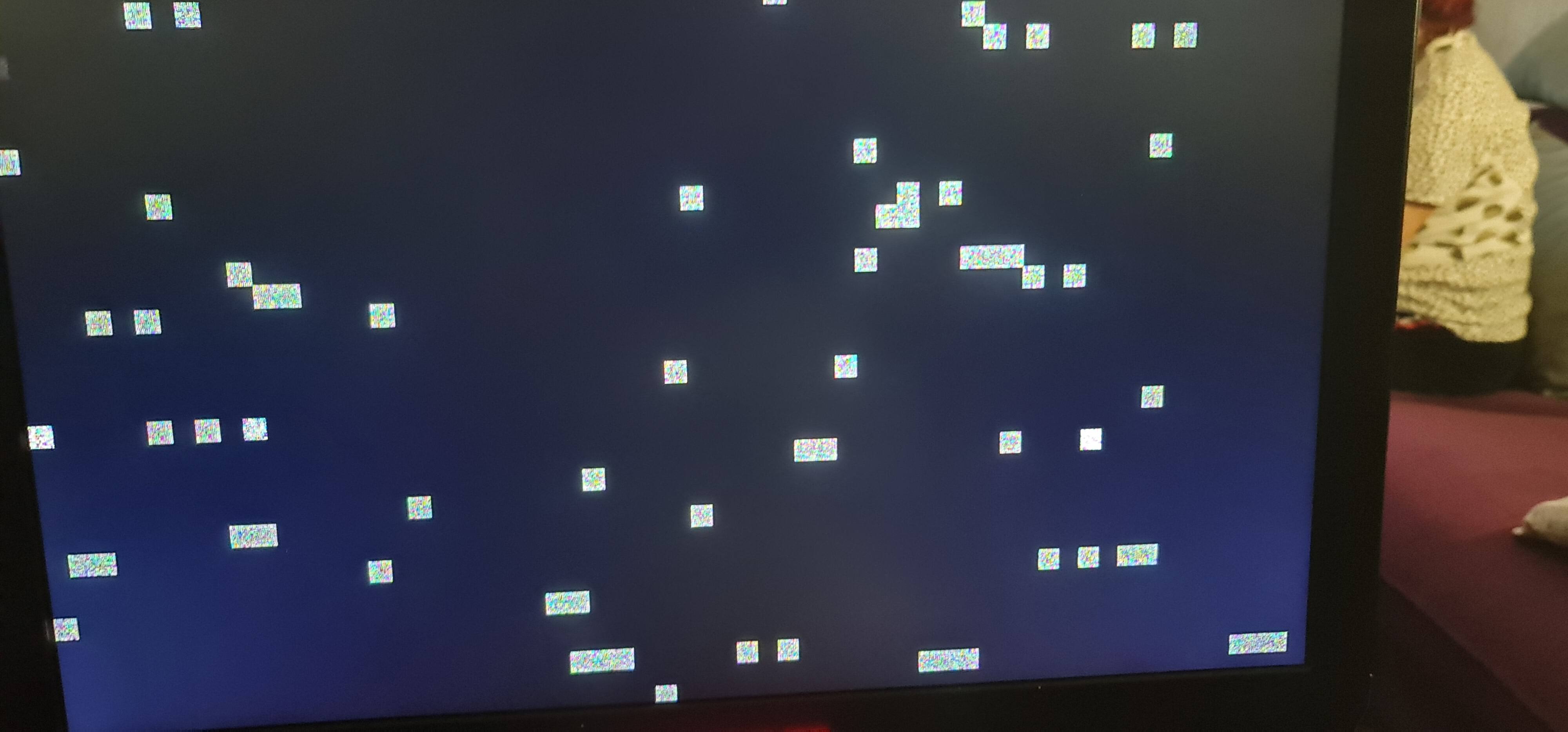

I am an owner of Alienware 17 R3 with 6820HK and GTX 980M.
This issue happen maybe 2-3 times in whole life while using laptop and it happens while gaming.
Today it happened many times, so I could not play games at all.
I switched it off, waited for like 5 minutes and all perfectly normal
I assume GPU is dying.
Is it worth to take it to local repair shop to replace the paste and clean the fans or too late.
Temps while gaming are "normal".
CPU hitting around 65 C , GPU 75 C, I think but will double check.

that's artifacting, you can try updating your gpu drivers but if that doesn't work then your gpu is most likely dying
https://linustechtips.com/topic/1609801-980m-dying-on-me/#findComment-16712076
artifacting is most commonly associated with gpu memory instability, you can try lowering the gpu memory clock/bumping up the core voltage (in case its a gpu core issue)
you may also be able to replace the gpu all-together ,if it's an mxm module (or maybe even upgrade it)
What settings should I put?
I am perfectly okay with it as long it will work normal, because I play older games.
Please do not take offence for my apparent confusion or rudeness,it's not intent me to be like that,it's just my BPD,be nice to me,and I'll return twice better,be rude and usually I get easly pissed of...I'll try to help anyone here,as long as it's something I dealt with,and even if you think I'm rude or not polite,forgive me,  it's not me it's my BPD.
Thanks for understanding.
https://linustechtips.com/topic/1609801-980m-dying-on-me/#findComment-16712088
im afraid i don't really know, but trial and error shouldnt hurt anything(start with -100 or sth on the memory and go from there)

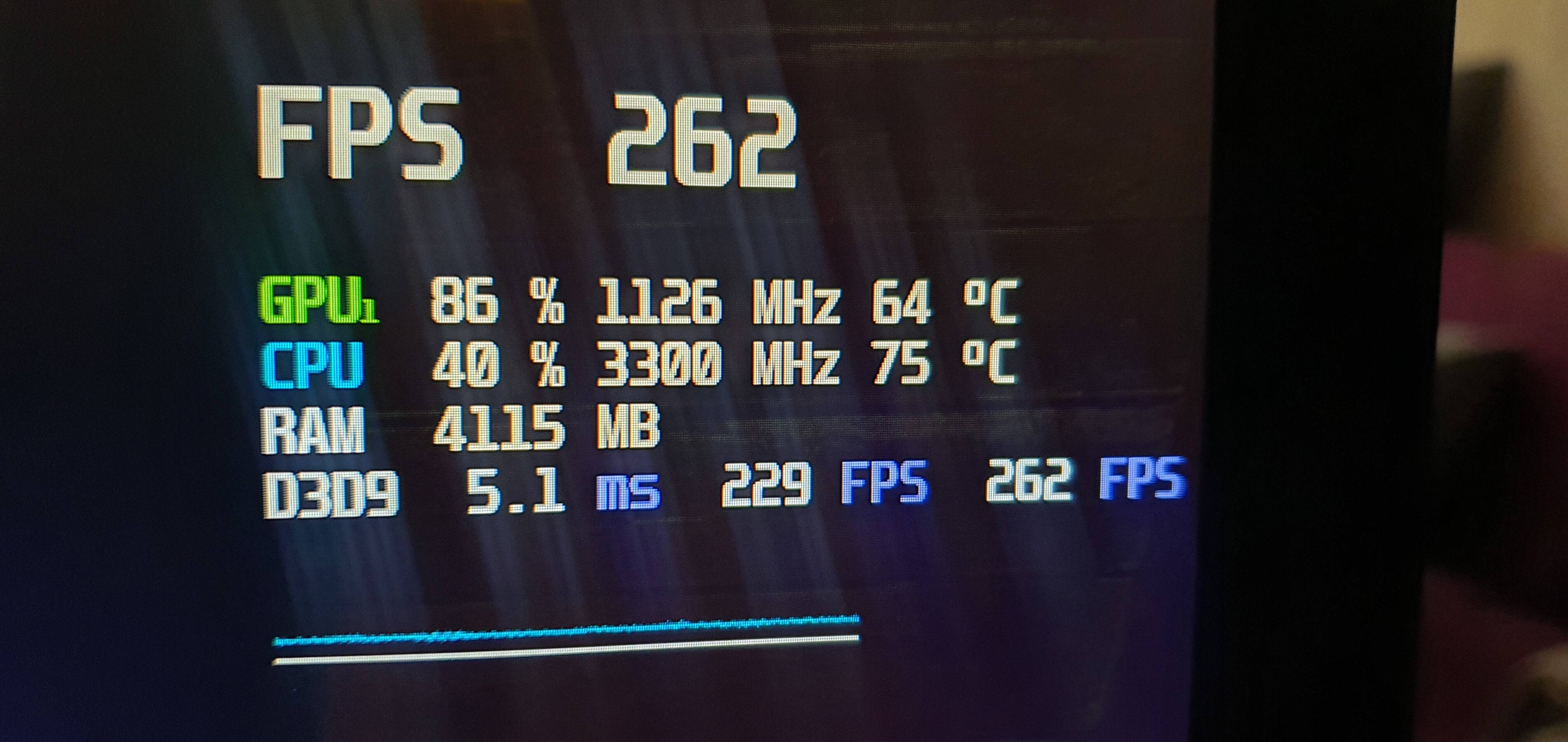

So I used laptop yesterday for like 2 h gaming, no issues, which is odd.
Most of the time , laptop works okay.
These are max temps  but wih cooling pad below laptop, otherwise temps are lot higher.
