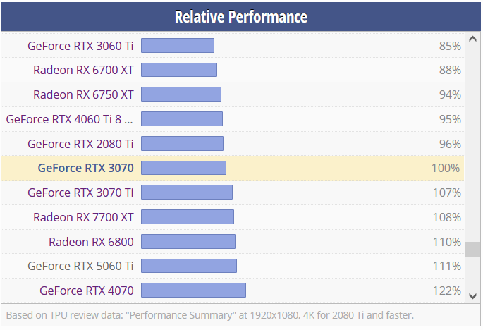

Of course you can use 3070 in new build.
  • The 3070 still scratches the mid-range area even in 2025
  • The only thing not going for 3070 is the 8GB VRAM
  • But still, if you don't overflow VRAM the card will just crank as it should
2 hours ago, ulookuglynoob said:
Is the 3070 still good enough in 2025?
Of course
