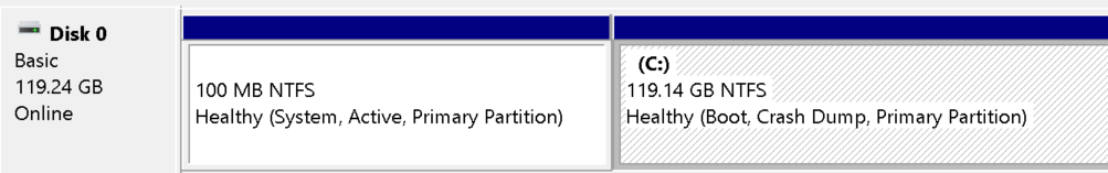

8 minutes ago, testcy said:
The reason I asked is not the 100MB of space, but the fact that the disk is not using GPT, so I thought that it was possible to have one partition.
I've had some weird MBR drives with 100MB GPT like EFI partitions, some of the transition machines I've seen that.
If you show Disk Management, there's a bunch of identifiers on the partitions to say what they're for. You can move those to different partitions with some command lines.
This is what I am talking about:
I believe you'd have to move the System identifier to C:, which should involve BCDboot type commands. Since its not a GPT type drive, it should be possible to remove that 100MB partition without breaking Window's boot.

This is an Active partition in MBR. LEAVE IT ALONE!
Do not play with partition, do not play with permissions, just don't, forget it and move on.
The names are correct, this is how it's supposed to look like, System and Active should be on that 100MB partition, and Boot on the C partition.
https://thestarman.pcministry.com/asm/mbr/W7MBR.htm
