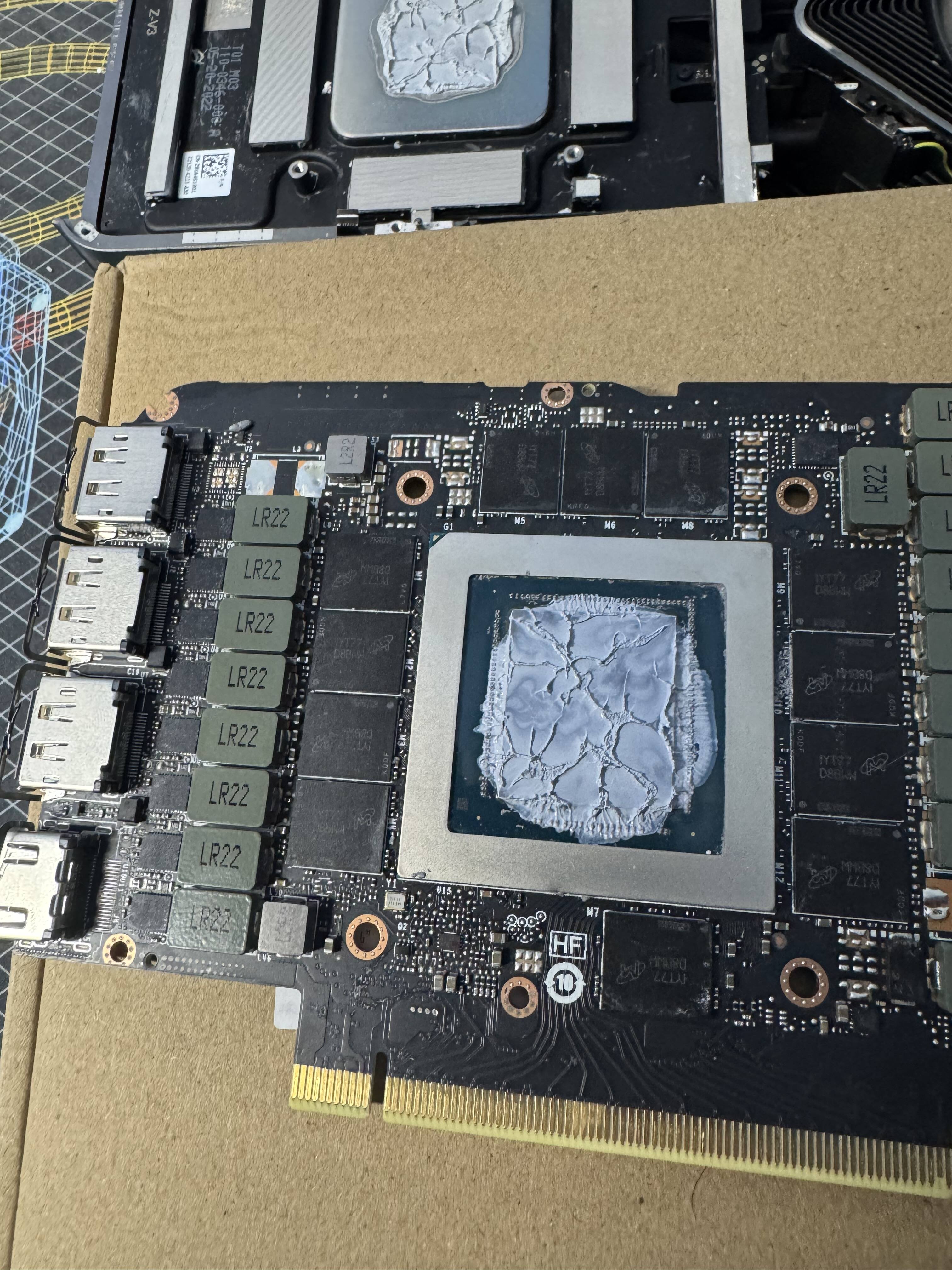

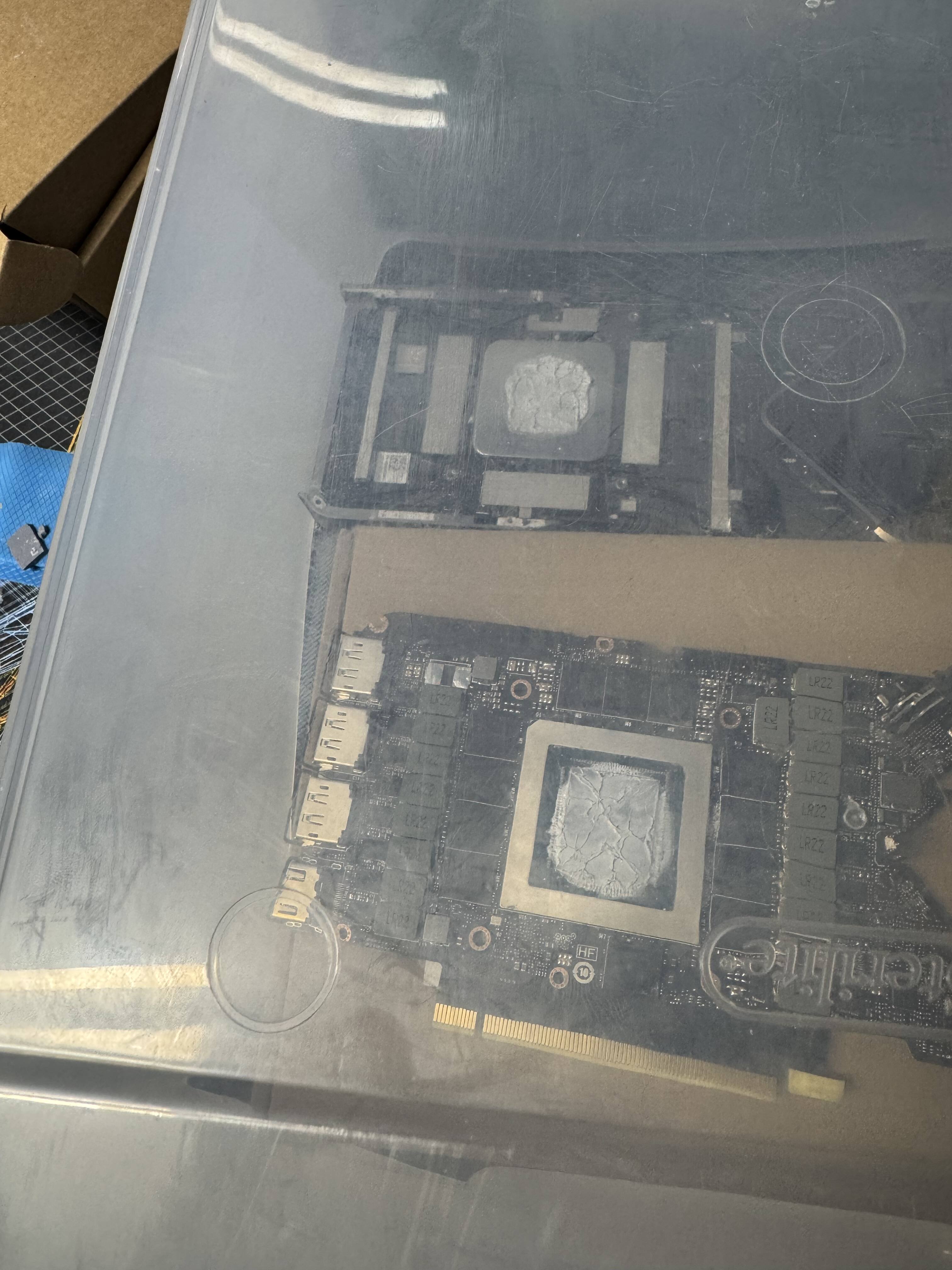

So I’m doing a thermal pad mod to the 3080ti. I essentially used the wrong pads for the front side (dye side) which 2.0mm which it was hitting 85c while the hot spot was 97c while before the pads mod it was hitting 82c at most. I had already repasted it a few days ago but I wanted to do some modifications for how did the backside too but won’t be getting the 1.5 mm pads until later today. So since the thermal paste isn’t that old along with putting a plastic box on top of it will it be safe to use the same thermal paste or should I just reapply it? lol I know I should probably just reapply it but this thermal grizzle kryonot stuff is not cheap 😭
I would heat it up with a hairdryer or something to get it gloopy again, but I have NO IDEA IF THAT IS SAFE TAKE IT WITH A PINCH OF SALT, thats just probably what I would do to re-use it

Like I have 1 and a half grams left but it’s the fact I spent $20 for 3 grams 😭😭 it feels like such a waste to use it all on the gpu because I gone goofed. I was considering to use it on my cpu but idk at this point I may just repaste the gpu cause I’d rather not have the heat hurt the gpu or or melt a solder joint or something
It will be good for probably 5 years in the open as long as you don't let dirt get to it and it isn't thermal cycled.
Yeah at most I’m mainly just benching it to make sure the temps are in line along with undervolting testing with a oc once it’s put back together. Hopefully that’s not a terrible amount of thermal cycling.

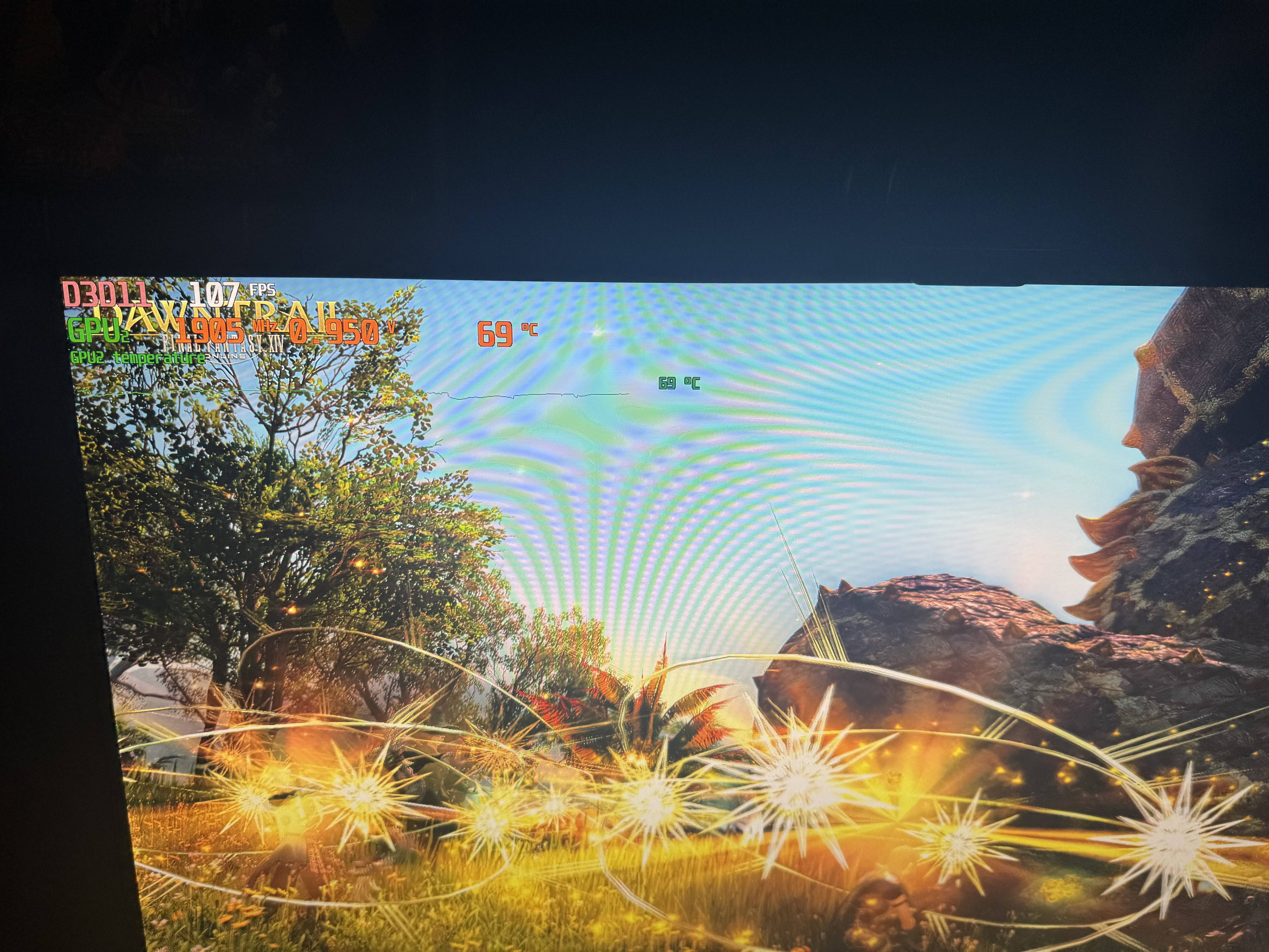

Both of you were right now sadly the vram runs 88-96c which I believe is in spec but the dye is SOOO much cooler now! It’s running 67c-69c on the Heaven benchmark and on the FFXIV dawntrail bench mark
Overall I’m impressed and hopefully this gpu will last me another 3 years cause nvidia isn’t making it easy to get a new gpu.

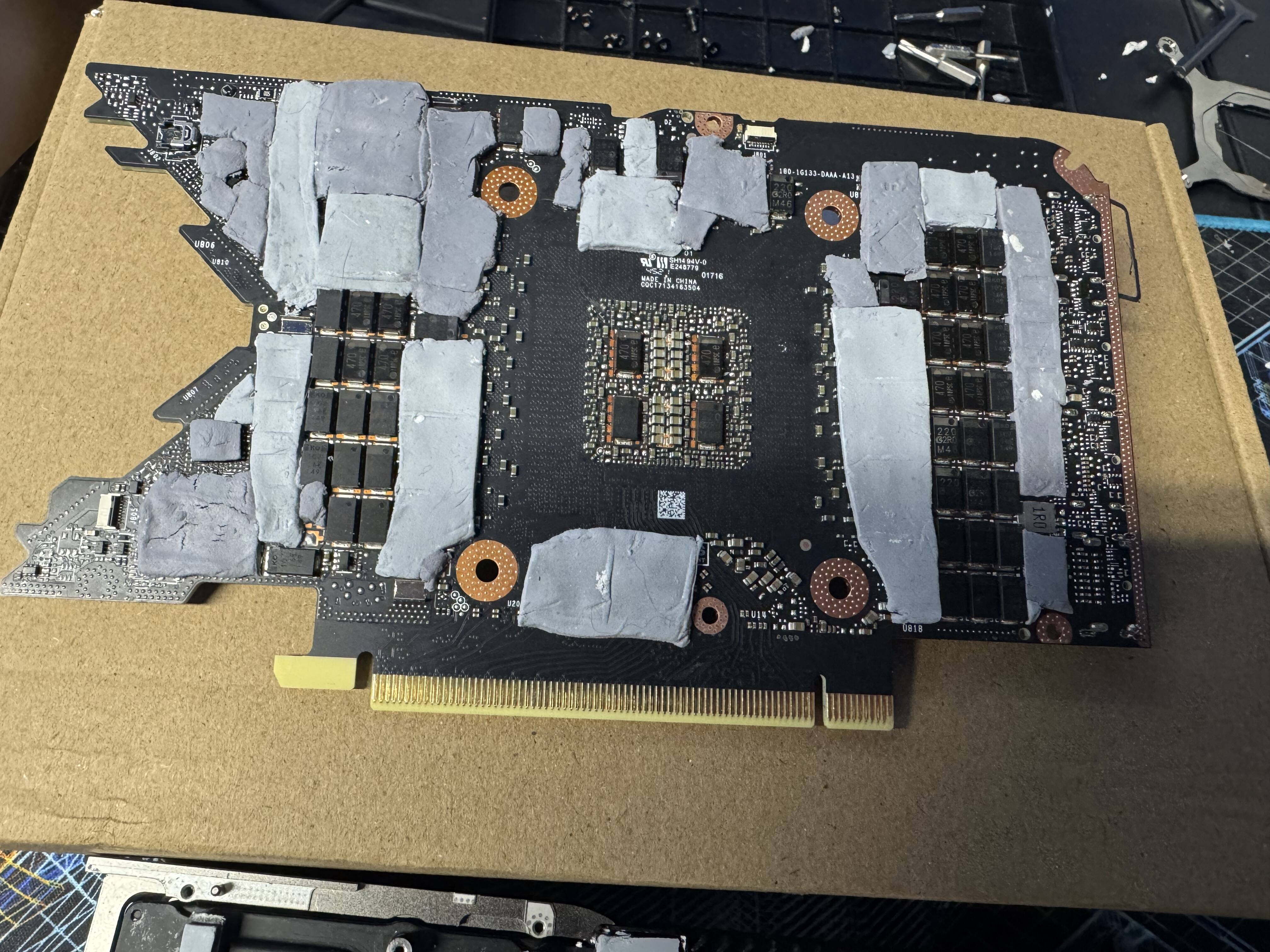

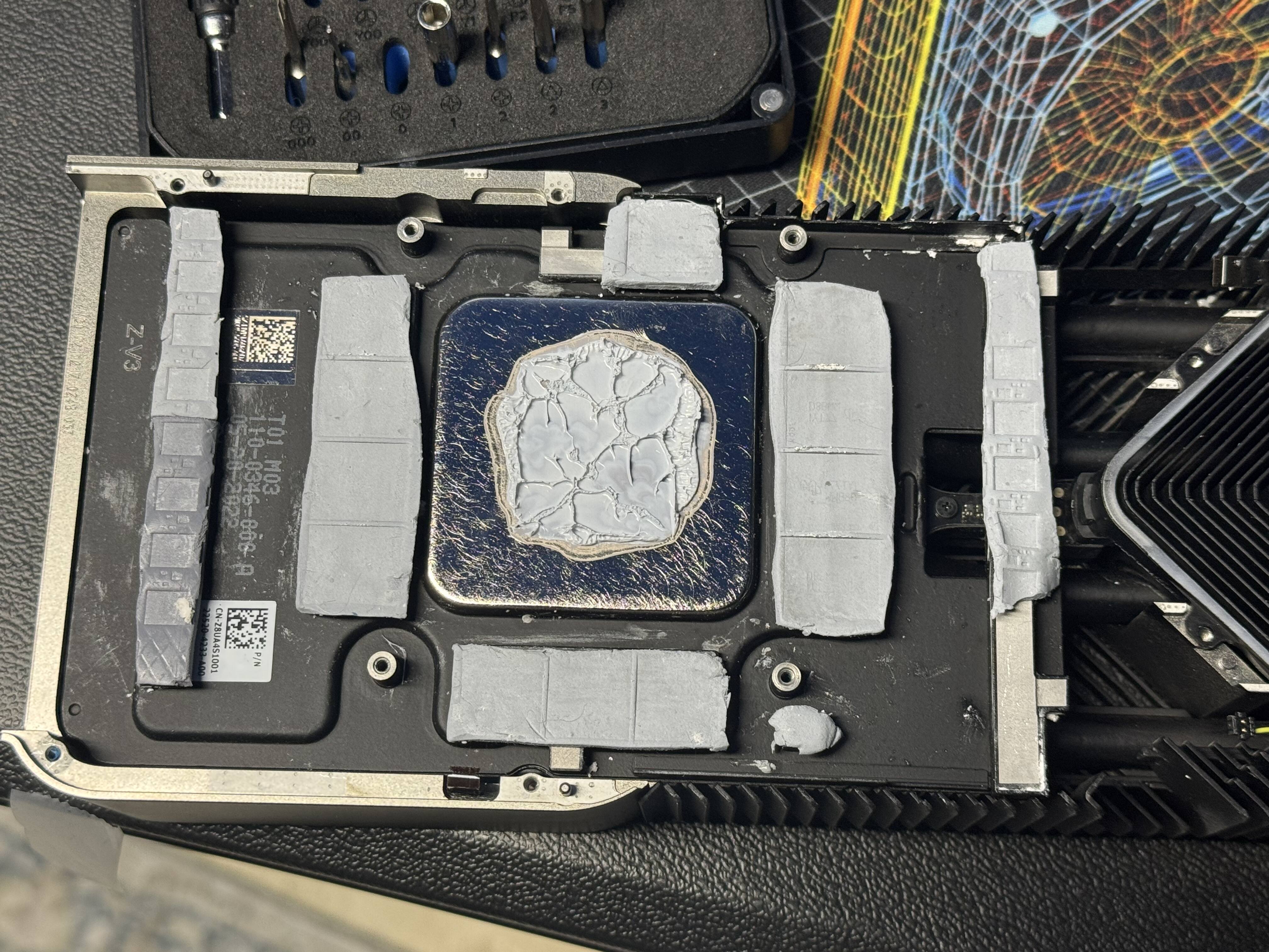

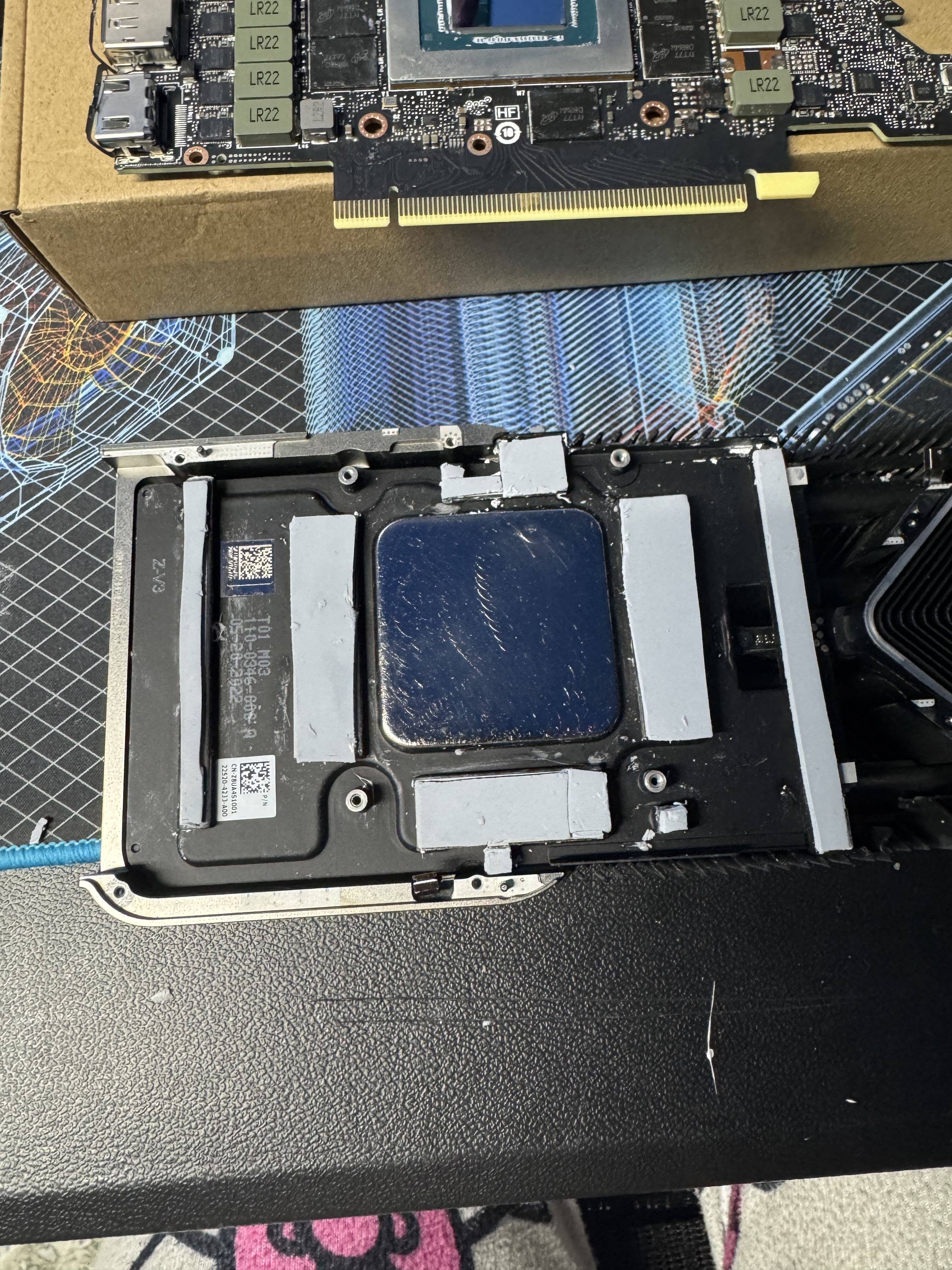

Additional images in regards to the thermal pads lol. I tried my best to copy someone I saw on Reddit who did the same. They got better results but I ain’t gonna complain with my dye temps being that low. sadly no thermal paste pics XD
