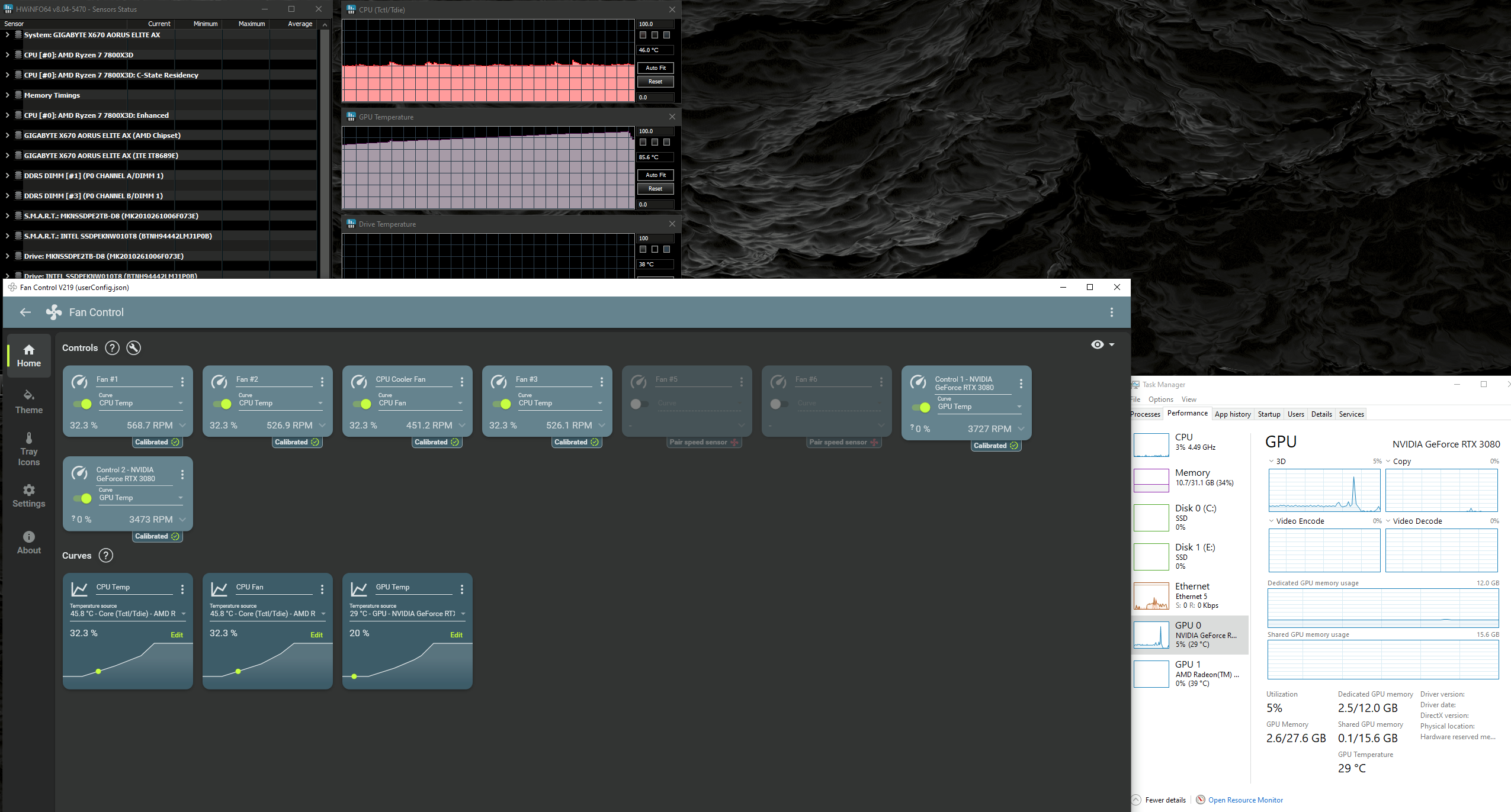

After the 576.02 driver release, I've had issues of with GPU fans suddenly ramping to 100% for a couples seconds before going back down to idle.
Opened up Fan Control, HWinfo, and Task Manager  and oh boy does it look fun.
The spike in GPU activity in tasks manager was at 95.5 C, when the fans finally decided to activate at 100% and bring the temps down to ~81.2 C.
The temperature then slowly climbs back up to 95.5C until the fans decide to spike to 100% again. Rinse and repeat.
I recalibrated my GPU fans with Fan Control and am still getting the error seen above.
Anything under 38% fan speed results in a speed of 0 during manual control.
Temperature monitoring is obviously not working properly in Task manager or Fan Control.
Only HWinfo is giving me accurate results.

I left my computer unattended for about an hour and the display output had shut off on its own. The GPU fans were maxed out.
Turned the computer off/on and Fan Control/Task Manager are reading temperatures normally. Fan Control also had an update.
Fan Control can now control the GPU fans again, but when the fan % control drops below 38%, the GPU fans shut off entirely.
This is what my GPU fan curve is effectively stuck at:
It seems the driver is forcing 38% fan speed minimums or something?

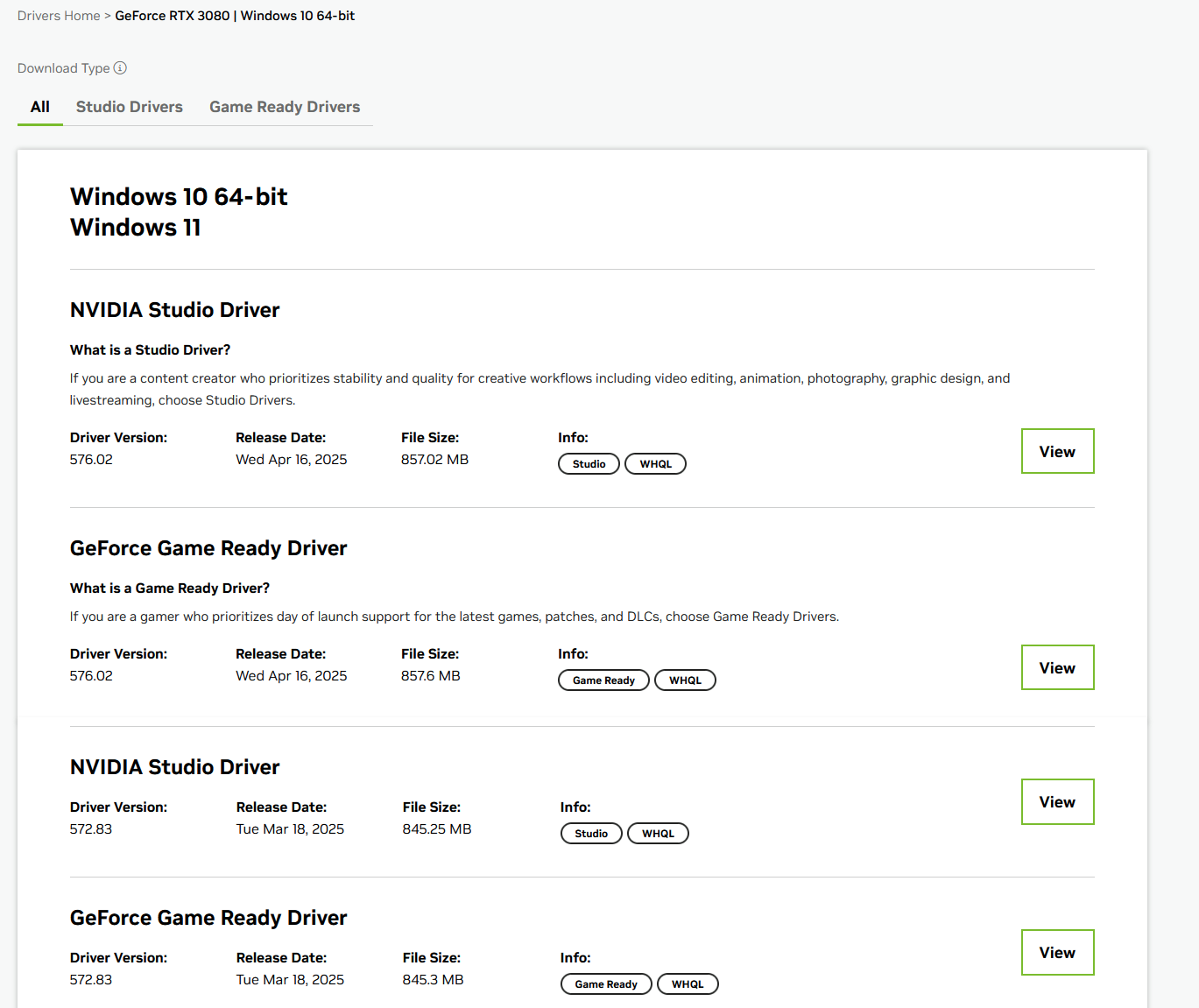

https://nvidia.custhelp.com/app/answers/detail/a_id/5650
There's a hotfix driver update including a fix for the issue with incorrectly reported temperatures after resuming from sleep.
Not for 30 series cards.

One of the reasosn I'm doing this up is that Jay's video mainly covered the 5060TI and 50 series. Nvidia's patch "fixing" this issue hasnt been released for any other series other then the 50 series. I think its worth bringing up that the issue is more widespread than initially reported and I'm happy to be a bit of a test bench in the meantime.
I do appreciate you including the last stable version of the drivers for anyone who needs to switch back.

Mine is starting to get weirder the more I look at it.
Going into Fan Control after automatic calibration:
At 100% RPM is ~3100
At "40%" RPM is ~450, which is ~15% of the max.
GPU is idling at ~60C
Here is what the Autocal points look like:
It semes like limiting the fans to 38% minimum before going to 0 RPM is causing issues with the calibration, and manual editing cant fix it.
What the values should be for reference:
Going to edit my curve to account for this new issue for the time being.

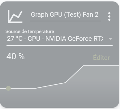

If I understand you correctly, below 38% the fans stop and your card gets hot.
So can't you make a curve that stays above 38% (let's say above 1000rpm) ? which should be alright noisewise and temperaturewise
This is indeed what I did.
Since % is meaningless, I based this curve off of approximate RPM values.
