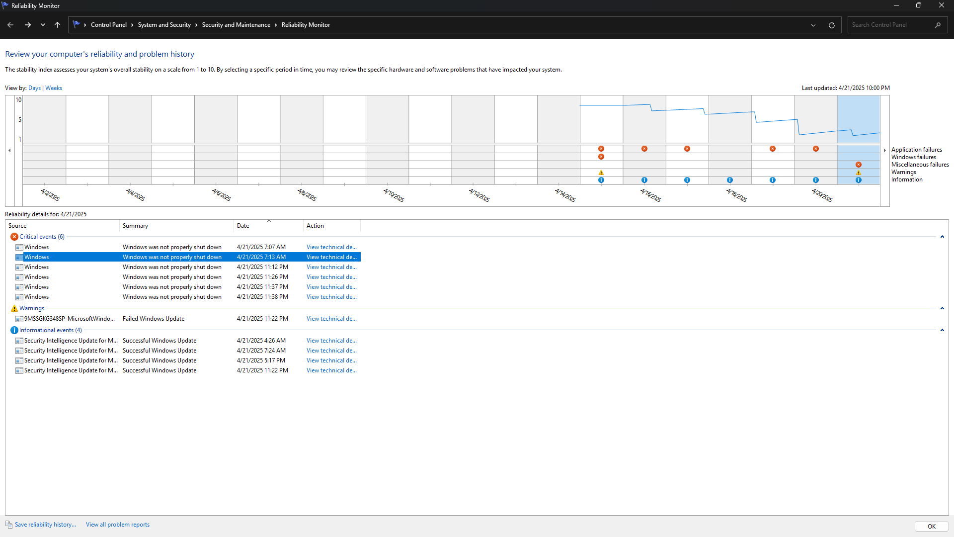

Not exactly sure how to diagnose this. Windows Reliability Monitor just lists all of the crashes as "Windows was not properly shut down" rather than a crash, leading me to think its a power issue, but simultaneously why would it suddenly work perfectly fine for almost a week with heavy daily use after simply formatting the drive and reinstalling windows? I'm not sure where else to check for more imformation on the events leading up to the crashes.

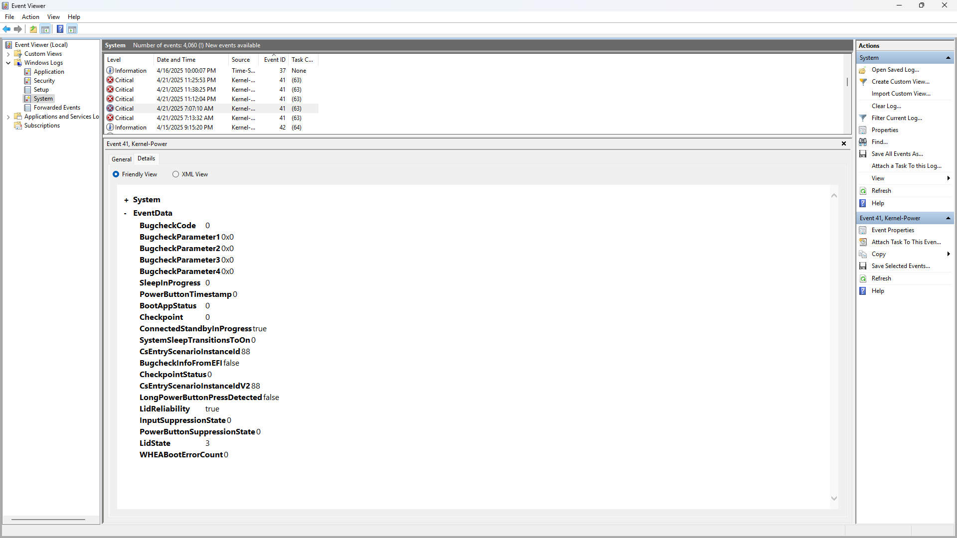

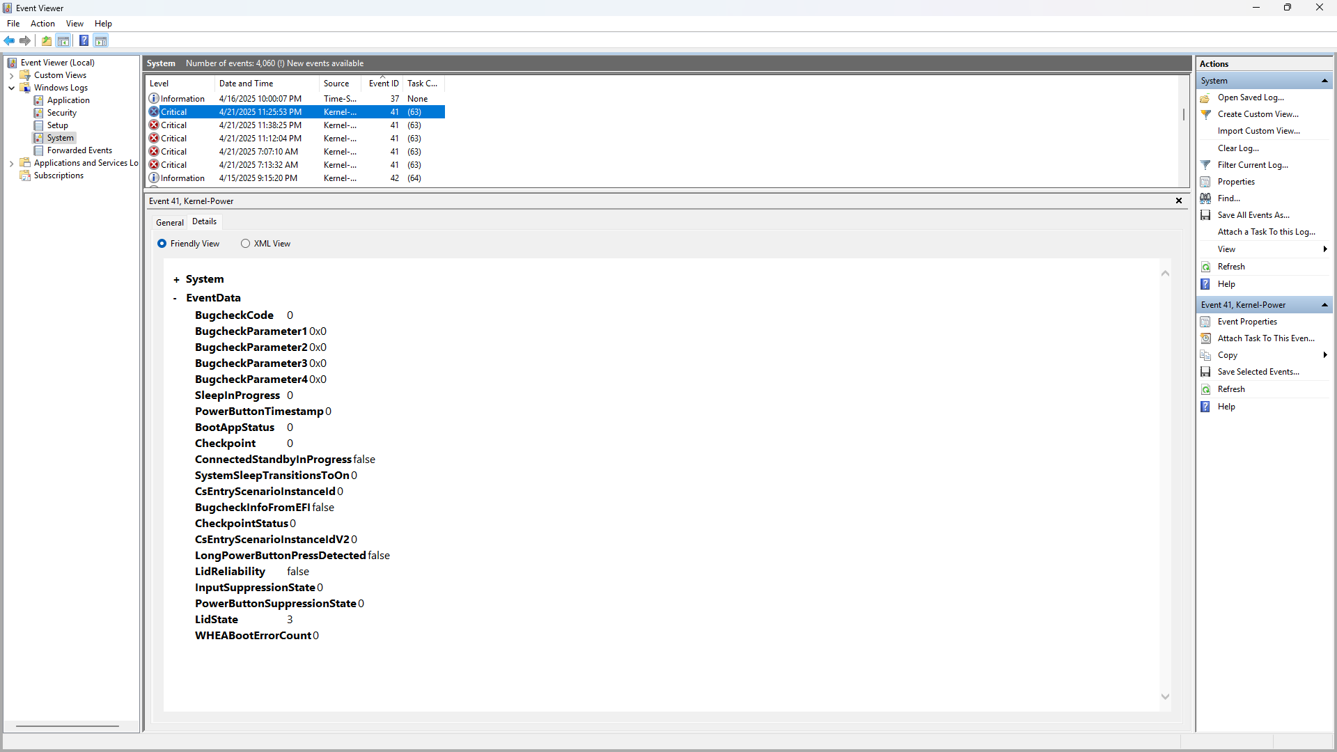

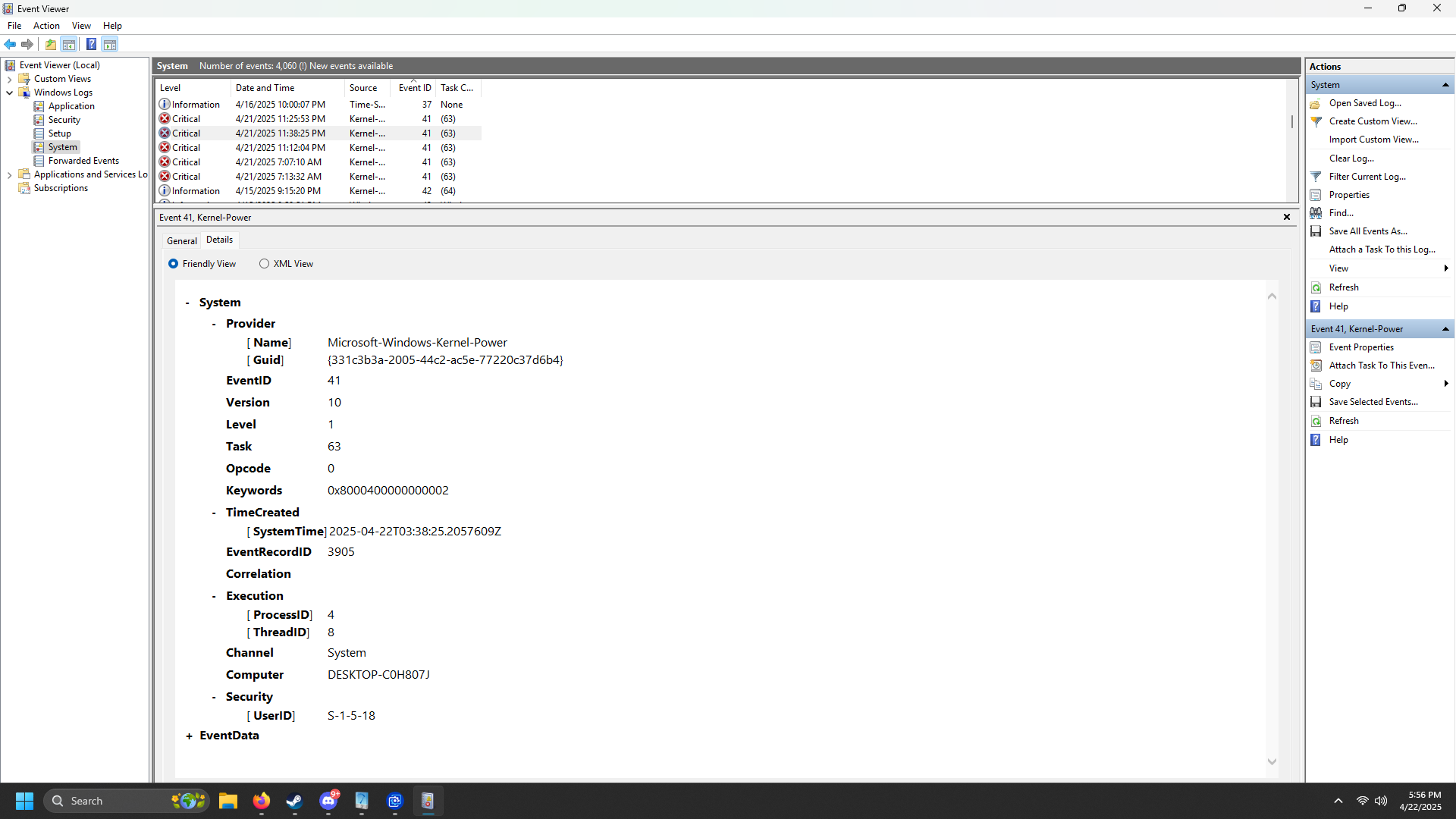

Open Event Viewer → Windows logs → System and scroll down to around the timestamp where the previous crash happened. You should have a Kernel-Power event here with the event ID 41. Select it and right above where it gives you info about the event, click the Details tab. Screenshot/copy paste this.

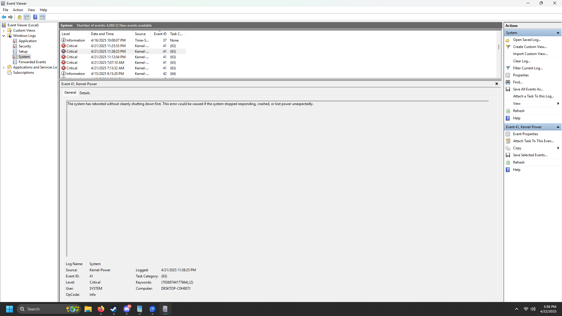

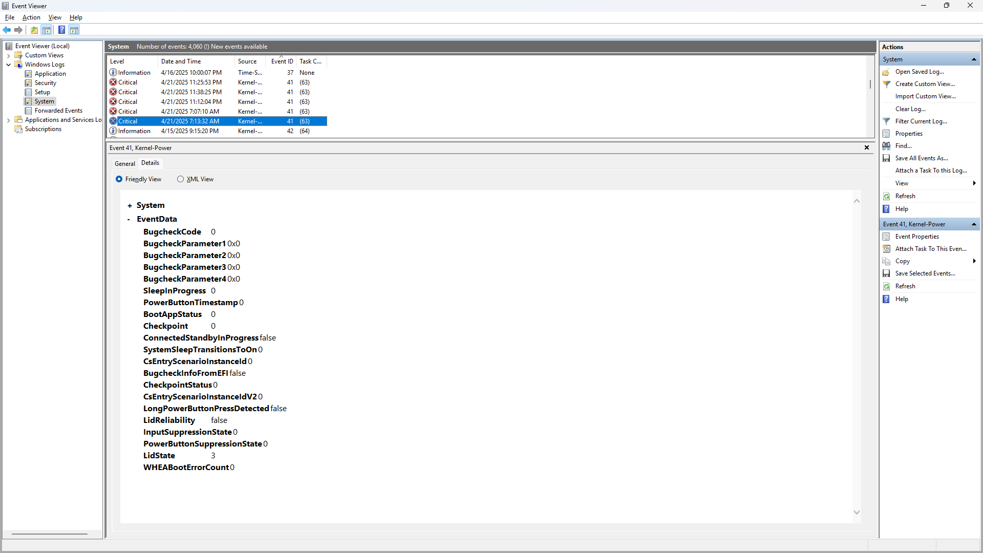

image.thumb.png.5f8b5eb66f9b8960bd9a53310aa413fe.pngimage.thumb.png.44f269f8179108c17a174d64c9d2db18.pngimage.thumb.png.19e113c8b796acf0232d392c5268dcff.png
Fr
om the last crash

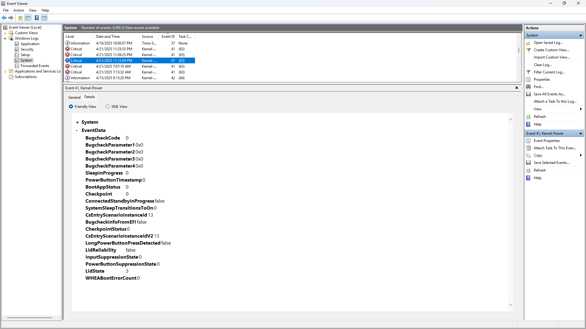

The rest of them
4 hours ago, Beary said:

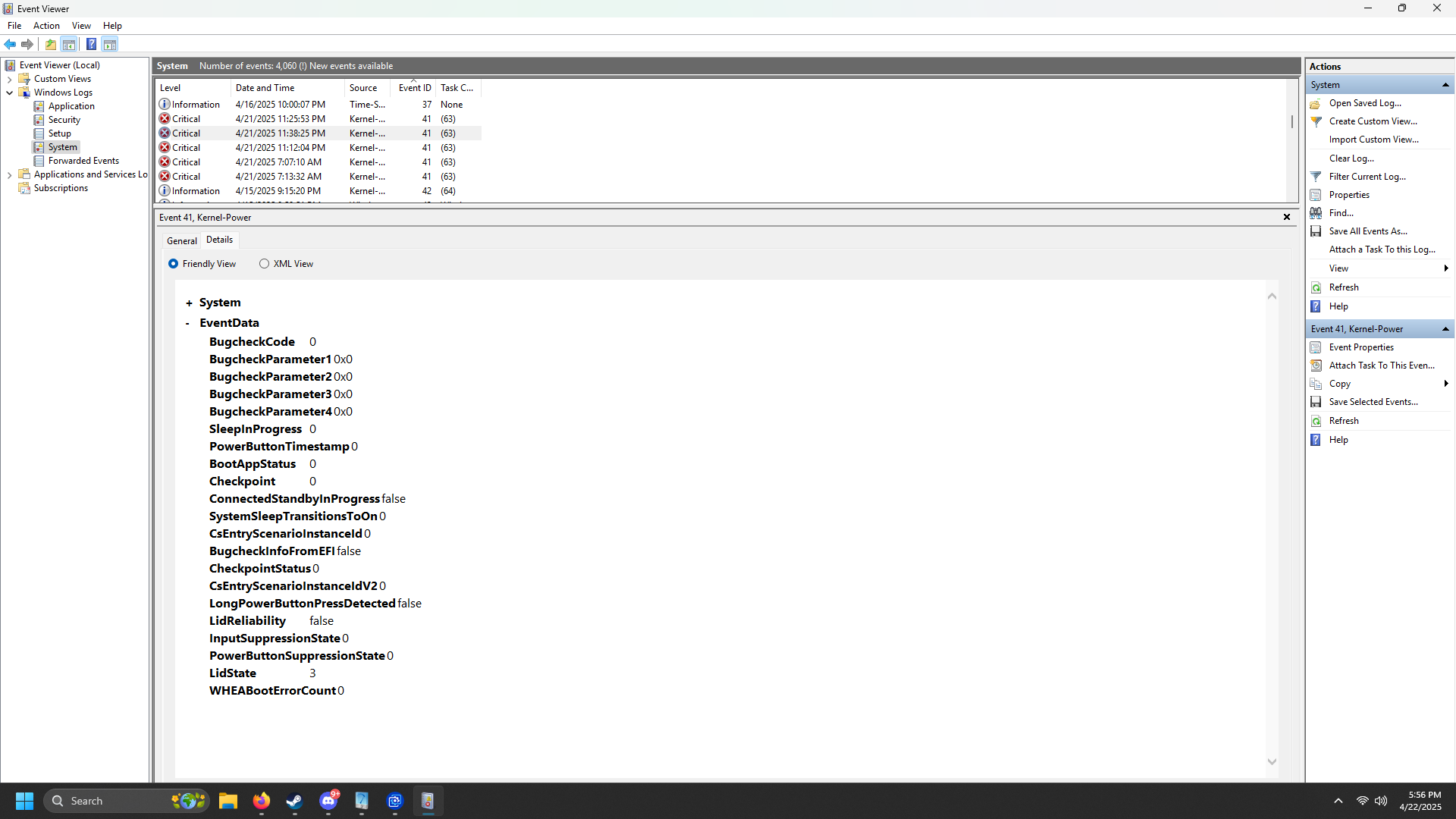

I was hoping that the black screen was hiding a BSOD, but it doesn't look like that's the case. Any WHEA events around the time of the crash? If no, my main suspect would be power. The PSU would be the main suspect, but it could be the power cable, if it's plugged into a power strip/surge protector or even unstable power from the wall.
And if you have any WHEA events, copy paste the content from the Details tab or right click → save and upload them. I need the long RawData section.

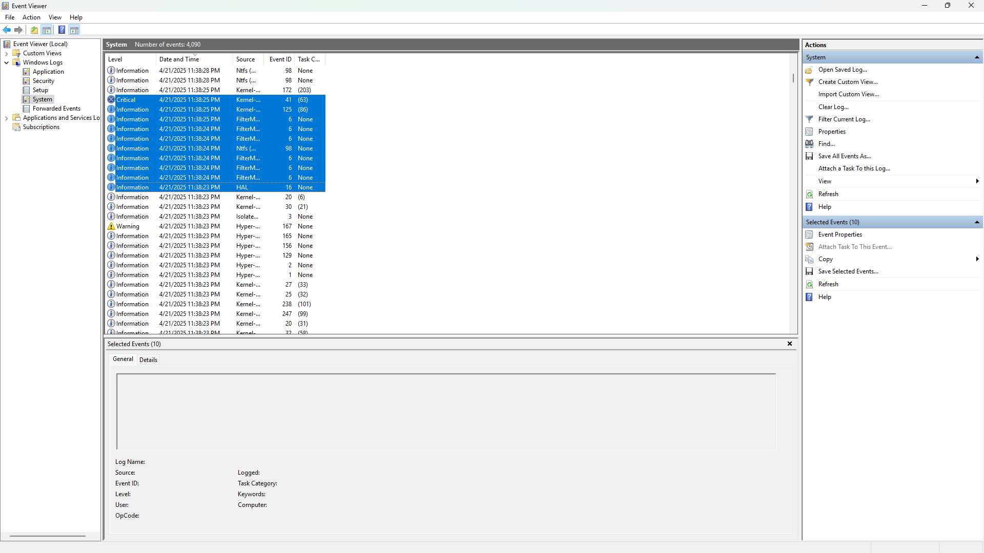

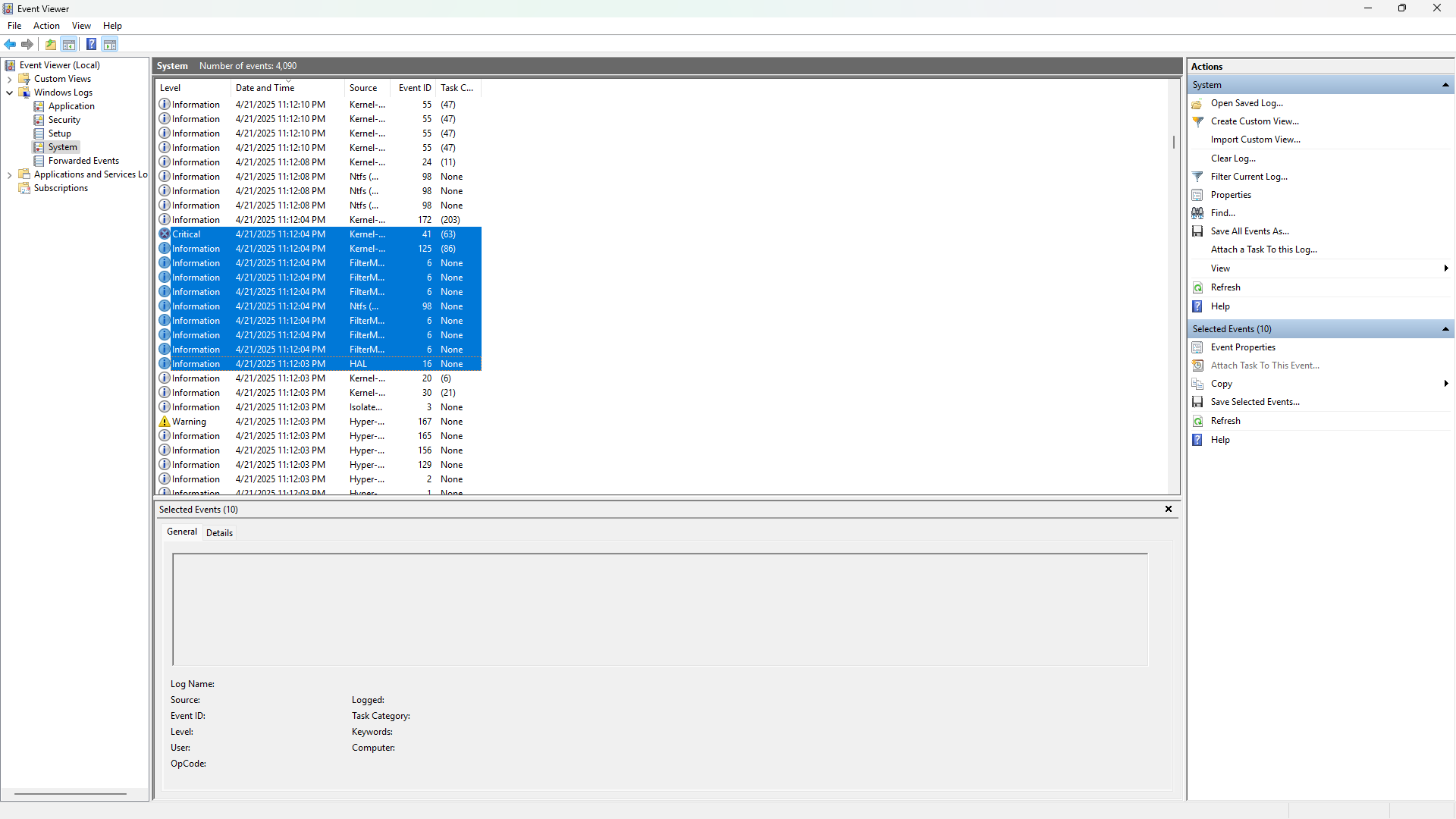

Unfortunately nothing from WHEA in the Event Viewer. However, it looks like the exact same events happen at the same few seconds leading up to the crash, though I'm unsure if this is normal as I'm not familiar with Event Viewer. Is that anything of significance?

Informational events are as a rule of thumb ignored because they are just informational. If you get a very clear pattern it could be worth looking into. HAL is the Hardware Abstraction Layer, it works with pretty much all hardware, but is usually more seen with CPU/PCIe device issues (And just to be clear here, this is when you have errors). The Filter Manager makes sure that files are handled correctly. This together with HAL and NTFS could indicate a storage issue.
Again, informational events could mean nothing. We don't have much to go on here so this is just if you want to go looking.
