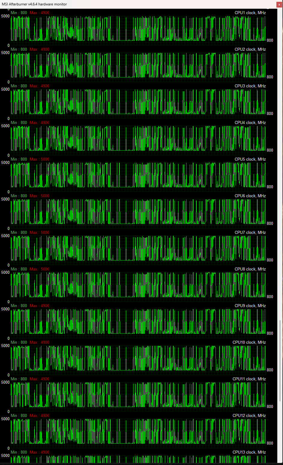

According to msi afterburner, it looks like my cpu is actually constantly boosting all the way up to 4900mhz even when I'm just browsing. Never thought to look at that before. How can I fix that?
If the CPU fan is responsible, you can change the fan curve so that it allows more time for the CPU to heat up, before the fan increases RPM. If the PSU fan is doing it, you can't change the PSU fan curve I'm afraid, so you'd have to curb the CPU's boost behaviour instead.
I'm not sure if there's an easy way to do that, you could try changing Windows power plan.

I've tried everything possible with the cpu fan curve, makes no difference. It looks like I have to figure out why my cpu is boosting so much and how to curb that behavior if it's even possible. I have a msi motherboard and didn't see a MCE setting, only a 'lite' load configuration that I'm not sure I want to mess with. Even so, looks like my cpu power is only maxing out at barely 60w when browsing chrome, usually between 30-50w. GPU power hovers around 40-50w when browsing, sometimes hitting 150w when I click through a 4k youtube video. But if all that's enough to trigger the psu fan then that's just stupid. I got a little money coming back from taxes this year and a little bonus from work that I'm thinking about just putting toward a new PC at this point.
Hmm. You can make changes in the BIOS to curb that, but I think they would also impact your performance. For example: if you turned off the turbo (or the higher turbos), that'd also limit your performance in apps that aren't browsing.
Ideally you'd want two profiles or something conveniently switchable, which you could maybe do with something like XTU or Throttlestop.

On 4/21/2025 at 10:36 PM, mwagen said:
Yeah, thinking I could probably just try another psu to start with. But, I typically upgrade every ~3 years anyway, and being a gaming enthusiast, the 14700k seems like pretty good value right now, and I can still sell my 11700k for a decent amount, so might be worth it to just move on to a more current platform for a little bump in fps. I really don't feel like messing around with this anymore, trying to tweak bios settings or having multiple profiles, etc. I just want it to work.
You could try ThrottleStop. You should be able to modify the SpeedShift. The higher the value, the more the CPU will refrain from boosting. The default is 128 where it behaves just like it usually would. At 0, it's always gonna run at max frequency and at 255, it's gonna run at idle clocks. I sometimes use this on my laptop and setting it to 135 results in around 200-300Mhz less frequency, drastically reducing power draw
