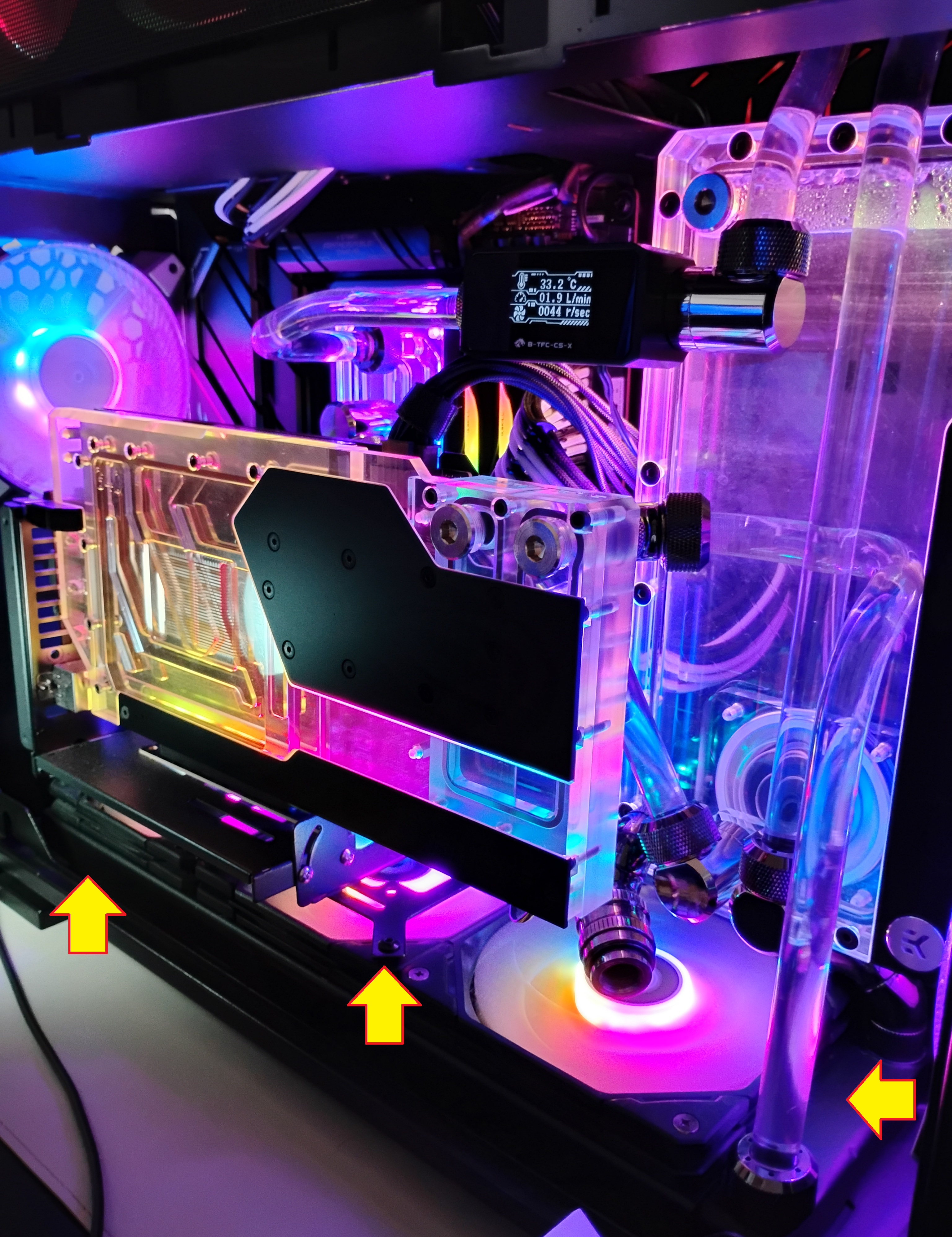

And as you can see it's a little busy inside my build:
With a rigid custom loop, it's not really easy to move things out of the way to access the CMOS reset pins. The GPU is on a vertical mount sitting on 2x 120x120 metal fan brackets with spacers for clearance so that the weight of gpu doesn't push the brackets down to touch the 15mm slim 120mm fans underneath it and then underneath those 3 slim fans is a slim XSPC TX360 radiator (this is my secondary 360mm radiator in this loop, the primary rad is a EKWB PE360 mounted on the top of the case not shown in the pic)

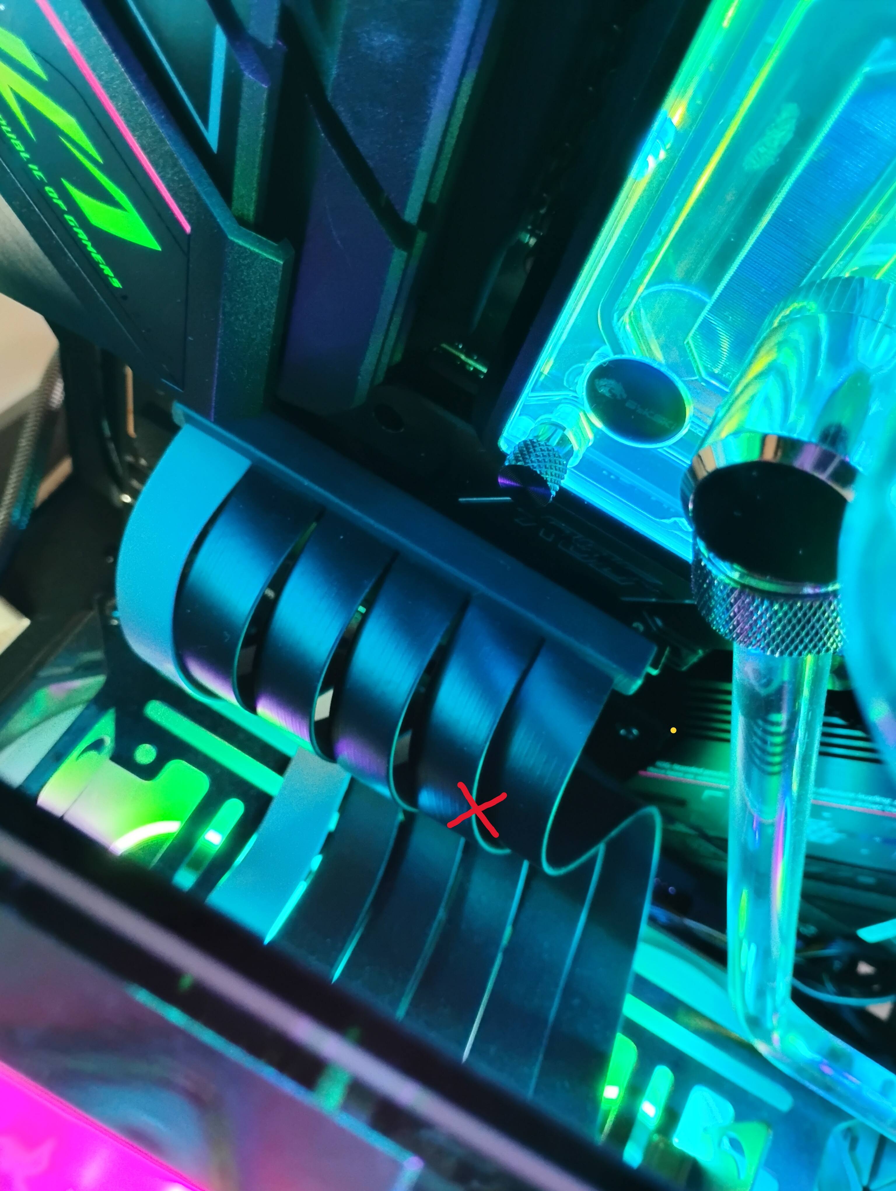

As you can see behind the GPU it's not even the riser cable that's in the way it's the radiator+slim fans on the bottom and all the cables tucked down there is the problem.
Here is a pick without the stuff in the way, the main problem is the motherboard sits with a millimeter of clearance from touching the bottom ceiling and my gpu vertical mount+radiator+fans are in the way of accessing those pins. So it's gonna be a huge hassle to clear CMOS because this motherboard model doesn't have a convenient clear button on the rear i/o. I'd have to drain my loop and disconnect everything which is something I'm trying to avoid doing.
