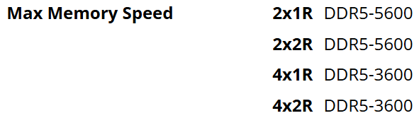

https://www.amd.com/en/products/processors/desktops/ryzen/9000-series/amd-ryzen-9-9950x3d.html
This is AMD's spec for the 9950X3D. They guarantee you can run 4 sticks at JEDEC 3600. Anything above that is not guaranteed by AMD. Mobo/ram makers might make claims above AMD, but that's not AMD's problem any more.
7900 XTX is connected to rest of world by PCIe 4.0 x16, for about 32 GB/s bandwidth. Compare that to 960 GB/s VRAM. Even dual channel 6000 ram is about 94 GB/s. It might be more than "a bit".
Huh, fair. I suppose XMP is taking the piss a bit now you mention it.
