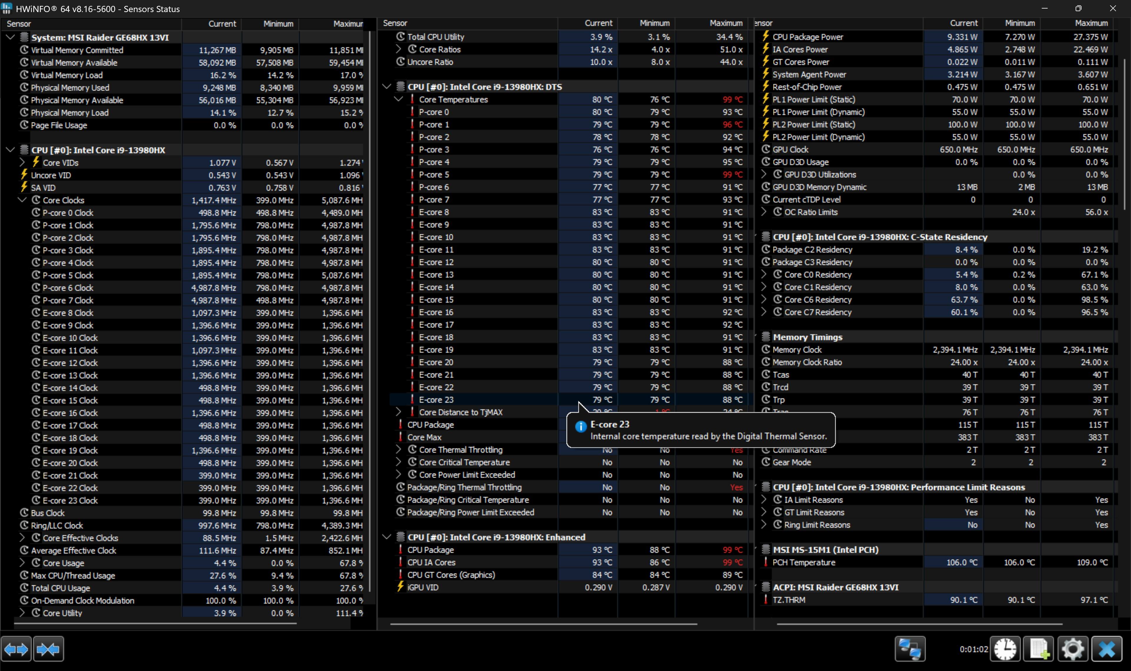

Hello,
I've bought this laptop end of Jan, 2024 with upgraded ssd & RAM from official MSI store. From day 1 it was running hot (reaching 95 c during cinebench r24 multi core test) causing thermal throttle, but remained around 80-90 c during my usual tasks/gaming after some undervolting. But from December, 2024 the thermal throttling started and from Jan, 2025 crashing/restart began frequently. I've undervolted both core and ring by 100mV, underclocked to 3.7ghz for 4 p-cores and 2.8 ghz for the remaining 4 p-cores, reduced the PL1 & PL2 to 60W & 74 W respectively, did thermal re-pasting via MSI certified service center (because there was a clipped screw in the heatsink) and it still didn't resolve the heat and performance issue although reduced the restart instances. So, last night it again restarted due to high temp, and today while having a closer look at the HWinfo I noticed that the PCH temp is too high even at idle. It's reaching 90c and only going down to 80c if I use coolerboost. Attached is the HWinfo readings.
At this point I'm not sure what else can be done from my end. So any help would be highly appreciated.

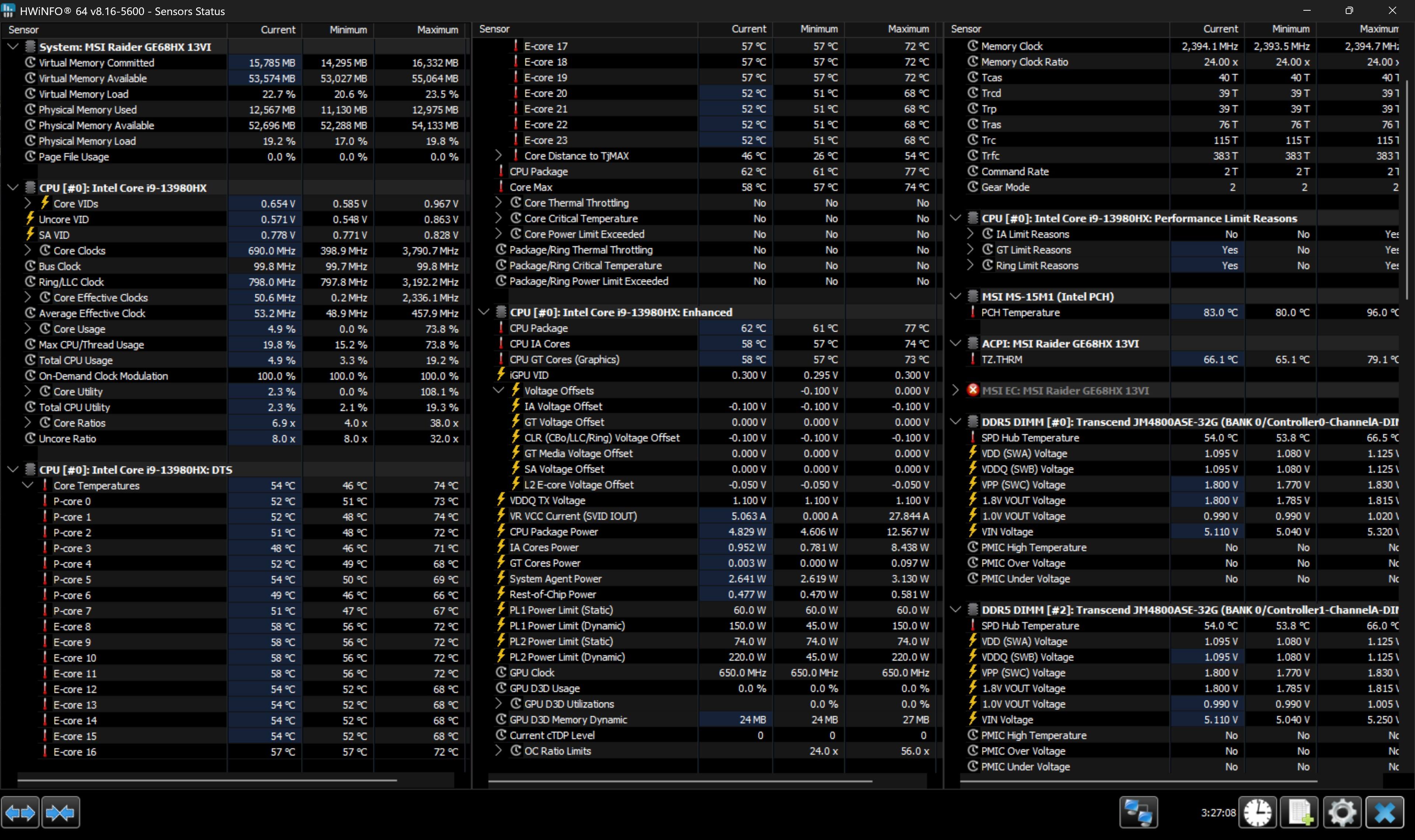

I've bought this laptop end of Jan, 2024 with upgraded ssd & RAM from official MSI store. From day 1 it was running hot (reaching 95 c during cinebench r24 multi core test) causing thermal throttle, but remained around 80-90 c during my usual tasks/gaming after some undervolting. But from December, 2024 the thermal throttling started and from Jan, 2025 crashing/restart began frequently. I've undervolted both core and ring by 100mV, underclocked to 3.7ghz for 4 p-cores and 2.8 ghz for the remaining 4 p-cores, reduced the PL1 & PL2 to 60W & 74 W respectively, did thermal re-pasting via MSI certified service center (because there was a clipped screw in the heatsink) and it still didn't resolve the heat and performance issue although reduced the restart instances. So, last night it again restarted due to high temp, and today while having a closer look at the HWinfo I noticed that the PCH temp is too high even at idle. It's reaching 90c and only going down to 80c if I use coolerboost. Attached is the HWinfo readings of idle with high PCH temp and post restart after playing Doom eternal for 5 minutes (filename: HWinfo_scrnshot3.jpeg). Note for the 2nd screenshot, since this was after restart, the frequencies were rolled back to their default settings. But at the time of playing/restart, 4 P-cores were clocked at 3.8 ghz and the rest were at 2.8 ghz.
P.s. since the whole Intel 13th & 14th gen fiasco, MSI did provide an update bios for this laptop, but the updated bios is still using microcode 113 instead of 129/12B.
