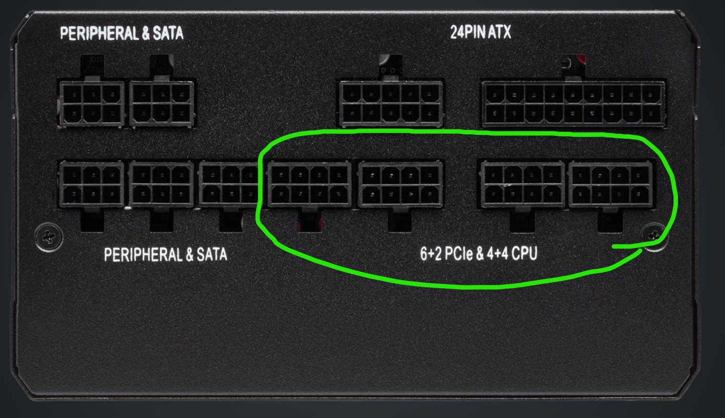

The circled ports are identical.
Please understand that what you're trying to do, plug in a GPU to a Corsair PSU, is a solved issue. Its routine. We've kind of done this before.
PCIe 8pin and 12V EPS 8-pin are different but on the component side, NOT the PSU side on the generation of Corsair PSU's in question here.
Should be pretty clear given the label says "6+2 PCIe 4+4 CPU"

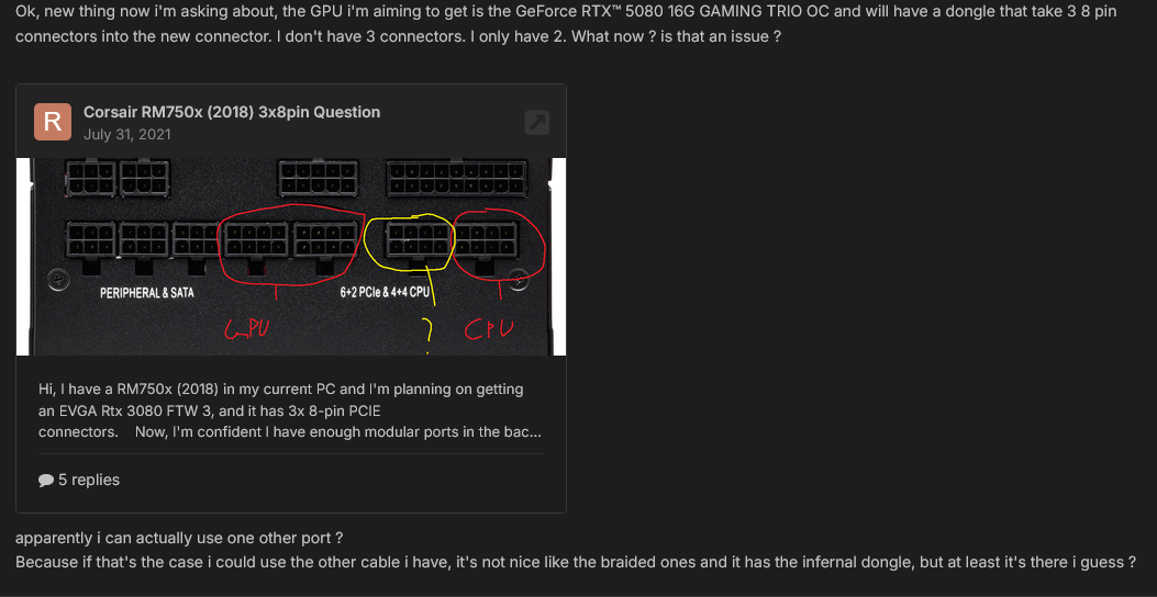

Should i just connect 1 extra 8 pin cable ( i have 2 nice braided ones connected to the card right now which i bought after buying the psu and i also have the original cables, so i would uyse one of the original ones( less beautiful but wethever )in the psu in the spot where the yellow question mark is ? because my psu is the same as that and tha slot is not getting used.

ehm... i thikn there is a misunderstanding... using 2 of the 3 plugs for the convertor is of course what i'm going to do, what i'm asking if it's better if i pull out the old base cable and put in the yellow spot and link all 3 3->1 to the psu.

All of these are exactly the same, use whichever you want.

OOOH, ok so, they do the exact same ? meaning : right now i have the 2 on the left occupied with 2 gpu cables and the one on the right with the cpu cable. I can use the spare GPU cable i have to plug it in the final free slot and connect all 3 of the slots each one with a dedicated cable for that slot to the 3 slot of the 3 to 1 convertor. The reason i would od this is to put less strain to the 2 cables giving the gpu an extra cable. Does it make sense ?

Yes, they're all labeled either PCIe or CPU so yes they all do the same thing. Use any of them for either of those two purposes.
You can do that if you want, sure. Unlikely to make a difference but I understand it makes people feel better.

It seems like you're either misunderstanding what you're reading or not describing what you're trying to do correctly.

ok, back from the weekend away, so, indeed i got confused by other old articles on non modular psu, tried it with my 3080 and indeed i can switch them all up freely, neat. Thank you for the help
