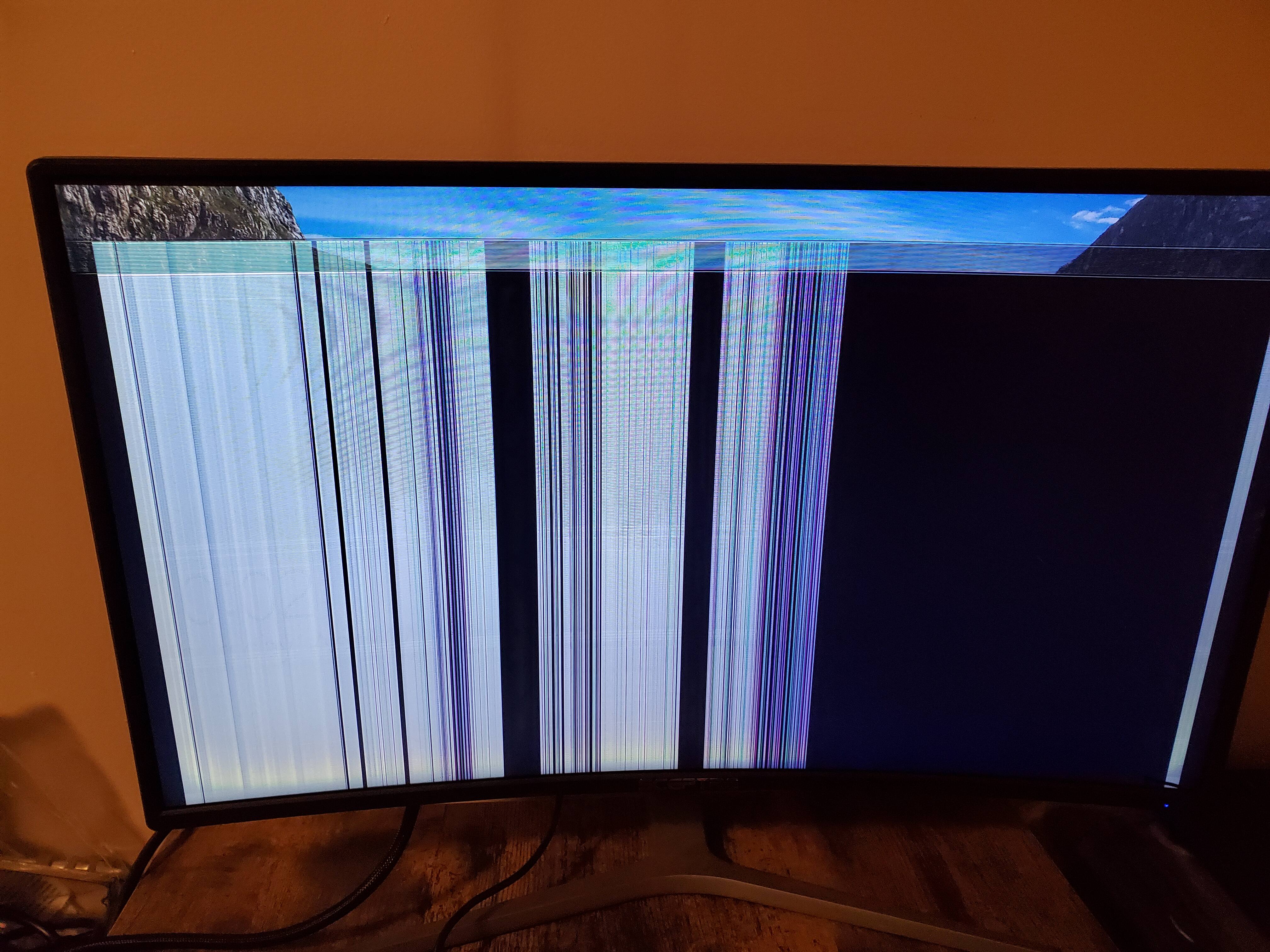

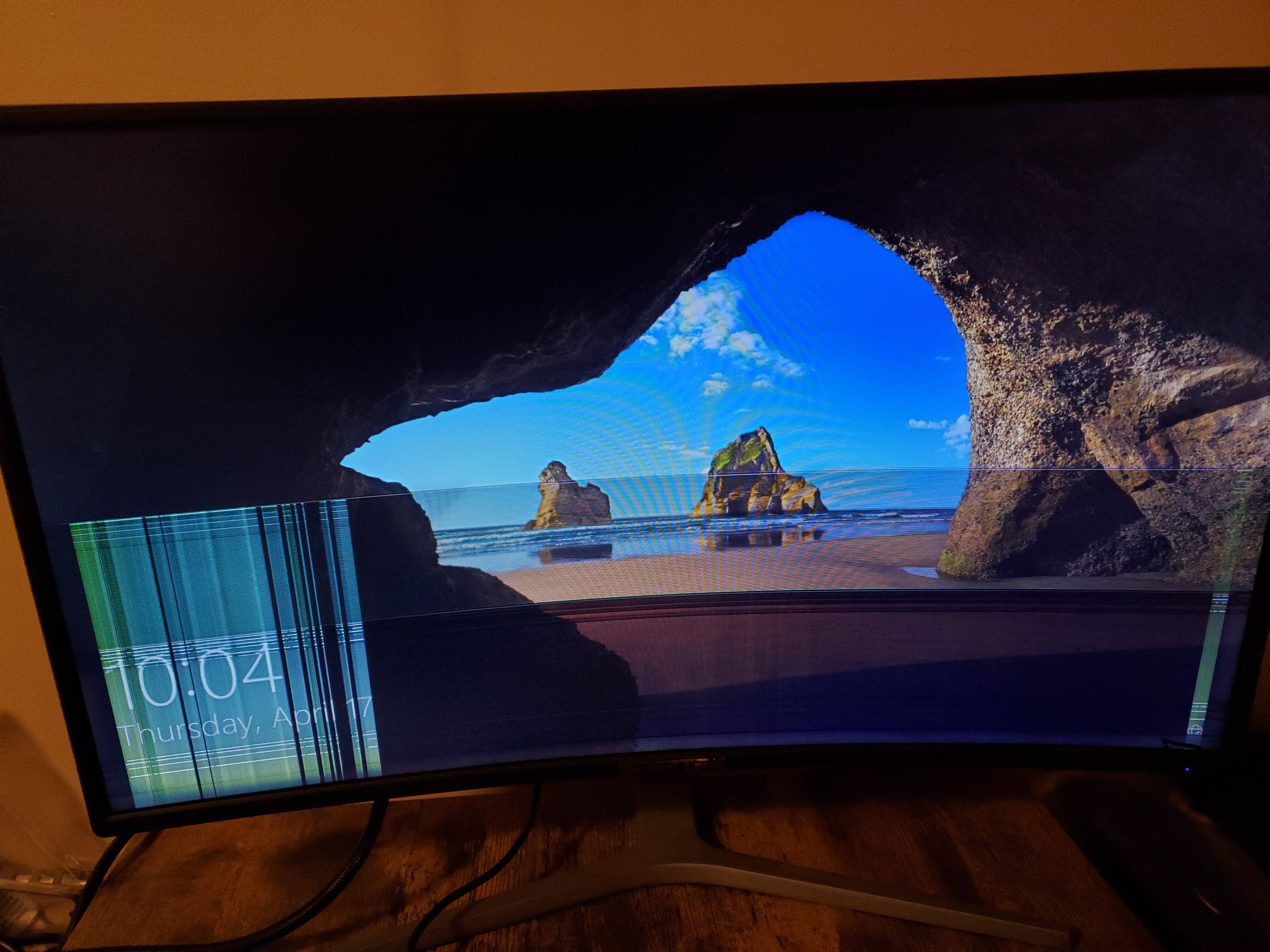

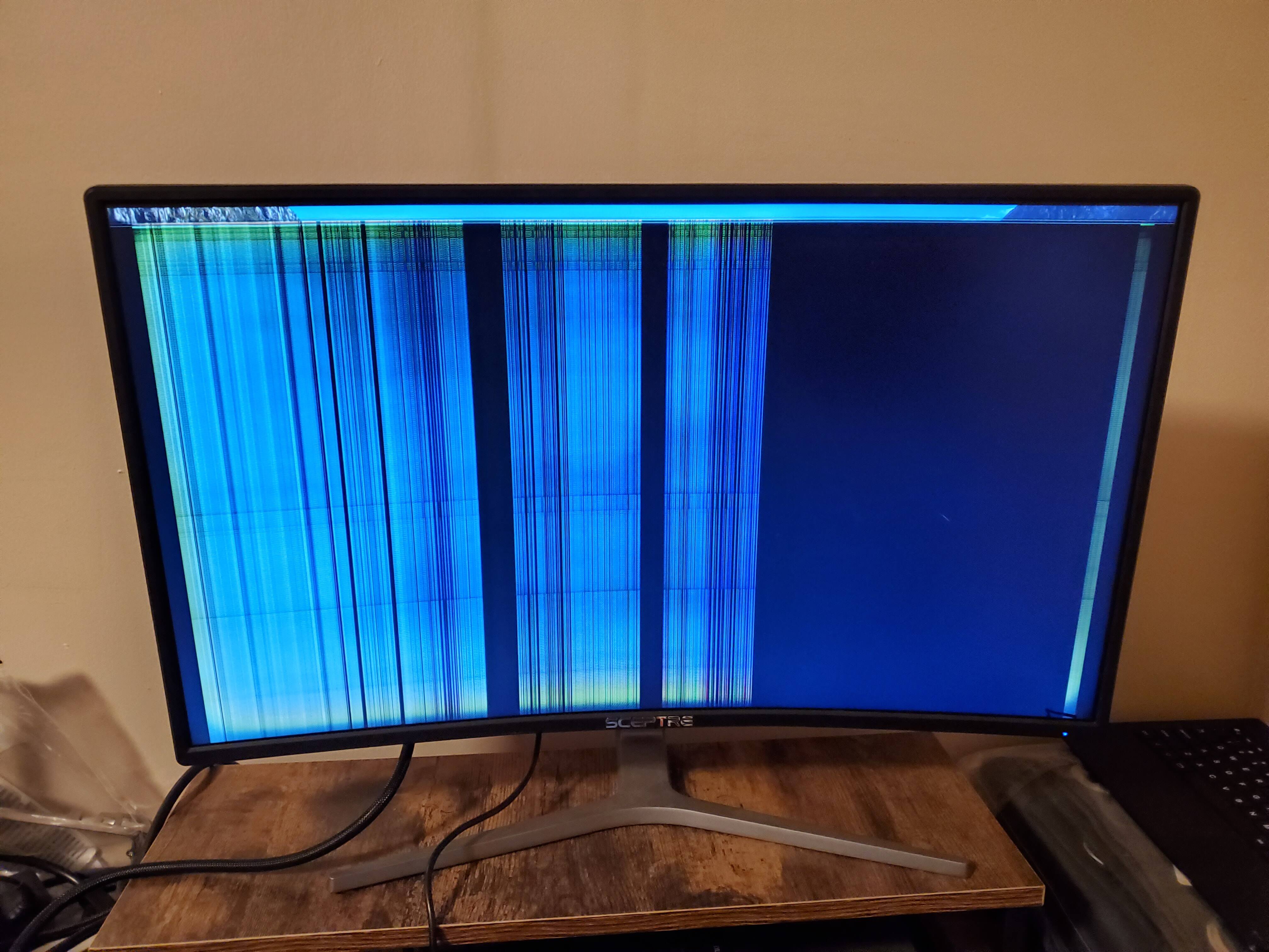

Build I've been running for years, 5600x, 32gb, rx6650xt on a msi b550. Took it apart for a case swap, can't get it to post. Mobo vga light is on and no signal. Try the second slot, computer does boot but see pics, it slowly morphs. I went and got my old 1060, boots in top slot just fine. Is it my card or something else? I don't see why a worse slot would give me an output if the good one doesn't boot at all and I don't see any damage to the board
Don't have another monitor at the moment, plugging that cable into my series x works fine though. Now that I think about it though, my monitor back home did do 1440, this one doesn't. That wouldn't have anything to do with it would it?
well, this looks like a "my GPU is dieing a really bad death and i can't do much if not simply watch it melt down into a puddle of my tears" kind of situation.

Tried a different hdmi cable, no dice. Before I jump to tearing apart a card I think I paid like 300 for, do you think a pc repair shop would test it for me? Could just be nothing, but the fact that it will boot in a slot (I assume is x8, spec sheet says they're both 16 but the bottom one only has half the pins on the back) but not the other gives me just enough hope to not be jumping straight to a reball. Last thing I reballed was a 360 and that was like 6 hours of my time, only for it to die again around a month later
