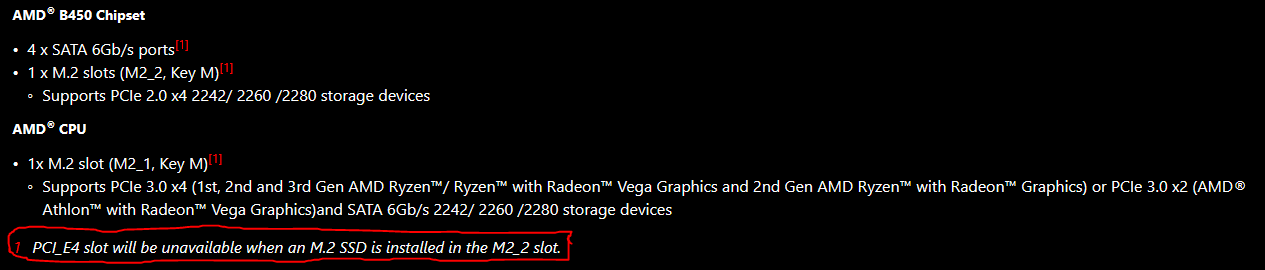

1. Will both SSDs work with my motherboard? I am aware that they will not reach their highest speed (especially as one of the M2 ports is slower, IIRC). I'm more interested with whether both of them will function (without significant slowdowns); I should point out, that only one of them should be used at the same time (I'm planning to have Windows partition on one, and Linux on the other).
2. Can using both of them slow down my GPU in any way? I'm asking, because of this (I hope that this PCI slot is not the main PCIe one, on which my GPU is mounted?):

Both ssds should work, they shouldn’t slow down your Gpu, and it depends on the ssd for if you can remove the heatsink.

just do note you have only pcie 2.0 x4, and pcie 3.0 x4 m.2 slots.
Yes, I know that one of the slot is slower anyway, and that I could buy practically any SSD and it will still throttle.
