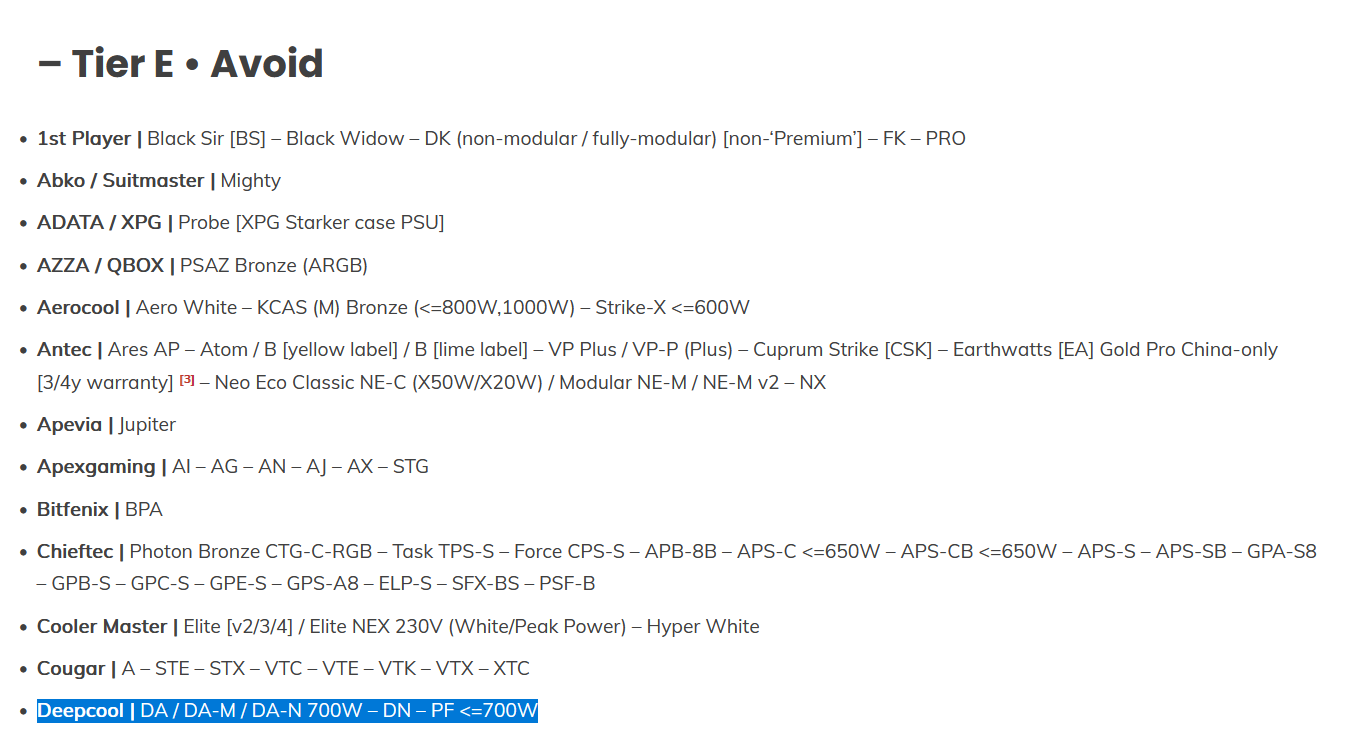

The Deepcool PF700 is a terrible PSU!  Please pick something else.
Its on the E:Avoid tier on the PSU Tierlists we use.

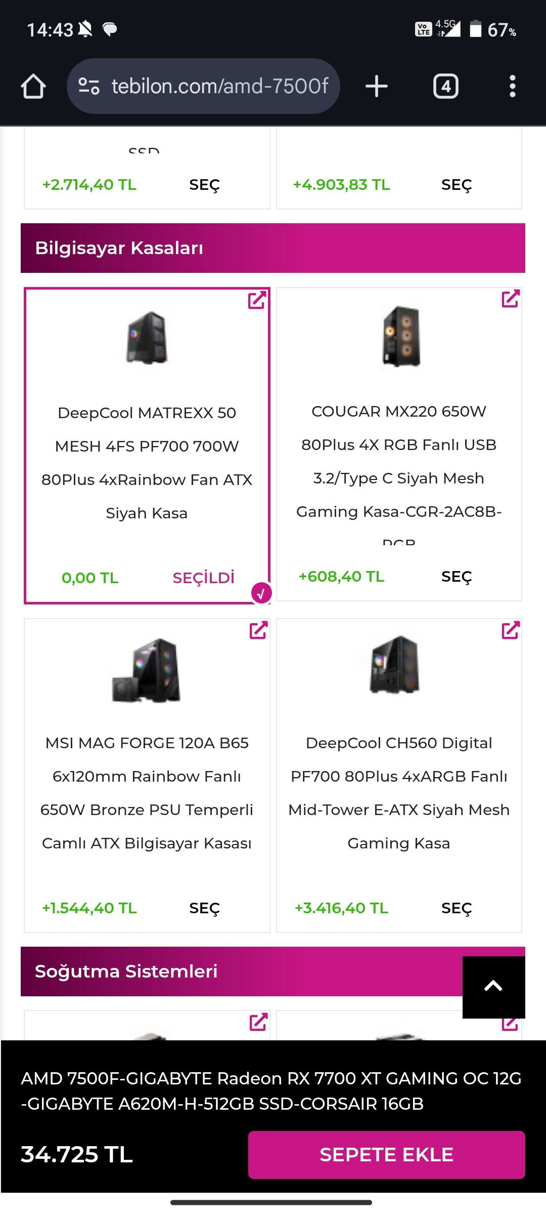

the site my friend is buying from only has these cases and you can't change PSU but change only case
Okay.  Thats unfortunate.
I dont know what else to say, the DeepCool PF700 is not very good.
I have however seen many people use this without issues.

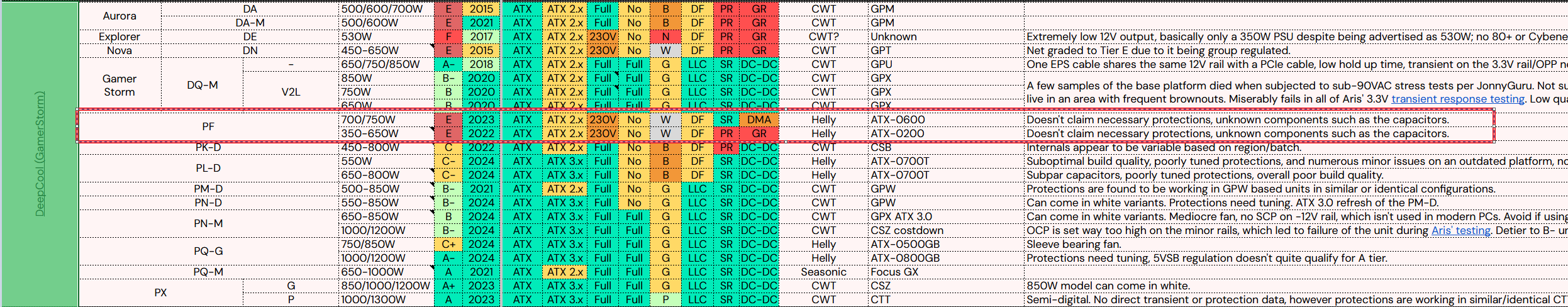

Remember to try and look at the PSU Tierlists for PSU's. Its gives a good indication of the PSU's Quality and reliability.
700w is plenty for a 7500f and a 7800 XT but the PF700 is not good.
Can confirm, RMx is a good PSU.  I personally ONLY use Corsairs RMx  🙂  I have 5.
Here is the link to the updated PSU Tierlist for future reference, bookmark it 🙂
https://docs.google.com/spreadsheets/d/1akCHL7Vhzk_EhrpIGkz8zTEvYfLDcaSpZRB6Xt6JWkc/edit?gid=1973454078#gid=1973454078

But the DC CH560 is pretty good
https://www.igorslab.de/en/deepcool-ch560-wh-mid-tower-review-all-white-deepcool-build-ensures-a-white-and-cold-christmas-even-without-snow/
4 minutes ago, PDifolco said:
The Deepcool PF700 is a power supply, not a case.
Haha apologies , got confused as OP posted a pic of cases amongst them a Deepcool 🙂
