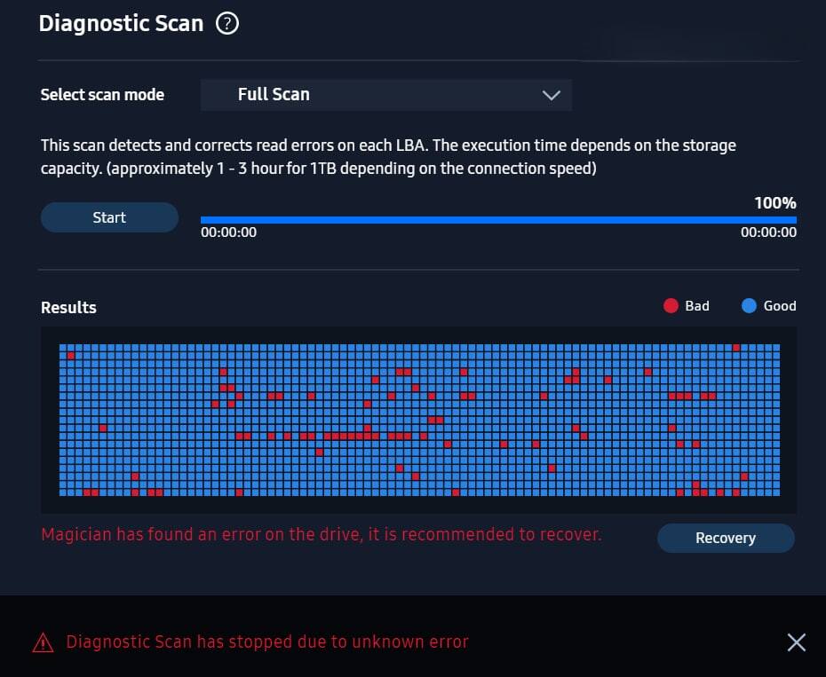

I then tried launching a full scan overnight, and when I woke up it had found some bad sectors/blocks/LBAs. It also told me that "Magician has found an error on the drive, it is recommended to recover" with an option to do "Recovery", which however failed with the message "Recovery failed, Check the disk connection and perform a diagnostic scan again".
photo_2025-04-15_18-55-34.jpg.2fb42a1299edbdf2842a886351b88e70.jpgphoto_2025-04-15_21-00-00.jpg.7cc5248711d0dbd184f4c01e5e4c20d3.jpg
Since I had to turn off the computer, I also clicked on a Windows notification saying something like "Problems found with the disk, reboot to fix the problems", which seemed to kick off a slightly longer reboot that printed some messages about "fixing" these issues.
After the reboot, I launched Magician and got the same result after another full scan;

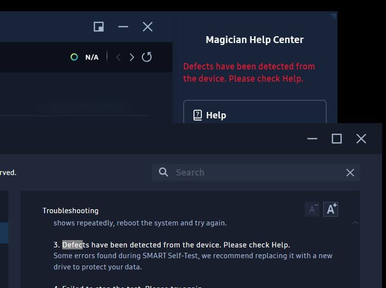

I decided to the run a "full SMART self-test", which ended with another error message logged by Magician, "Defects have been detected from the device, Please check Help.", and after looking at the "Help" section of Magician I found a bit of text that just said "Some errors found during SMART self-test, we recommend replacing it with a new drive to protect your data".

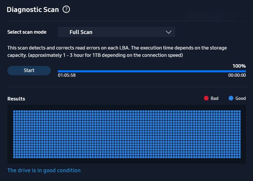

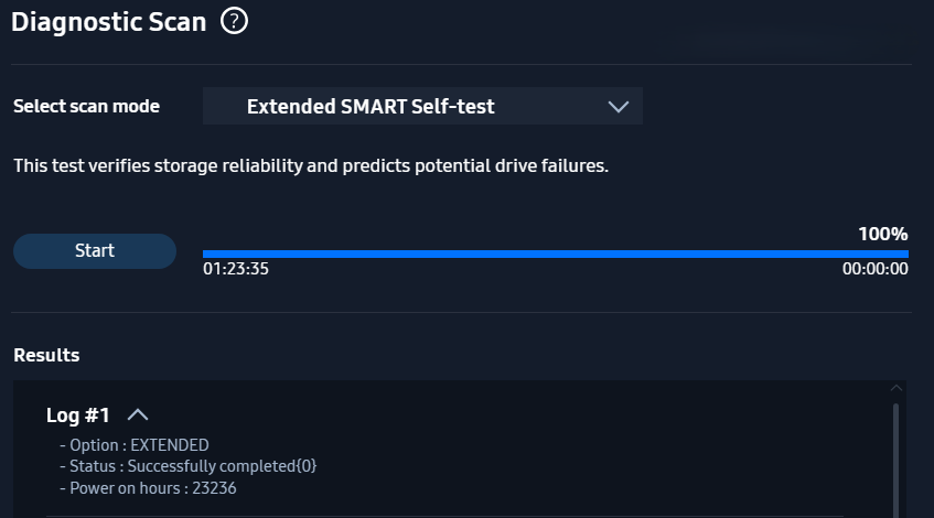

After formatting I decided to relaunch the same tests, just to check if anything more could be done to maybe section of the bad sectors and keep the drive alive at reduced capacity, but to my complete surprise the "full scan" found no bad sectors whatsoever, and the "full SMART self-test" finished without any errors.
photo_2025-04-15_21-00-24.jpg.8f096fd13f56bf4c68f08d9edc303219.jpgScreenshot2025-04-15210342.png.666aafe43d7fd2fbce2cb93d8ef3be72.png
I am now wondering if the full formatting of the drive automagically did something that either fixed the problem the drive was having and/or removed those bad sectors I was seeing earlier, and I guess my question is: is this drive safe to keep using? all metrics and tests seem to indicate so, but given how much trouble it was having not even ~12 hours ago I am not sure if I can trust it.
