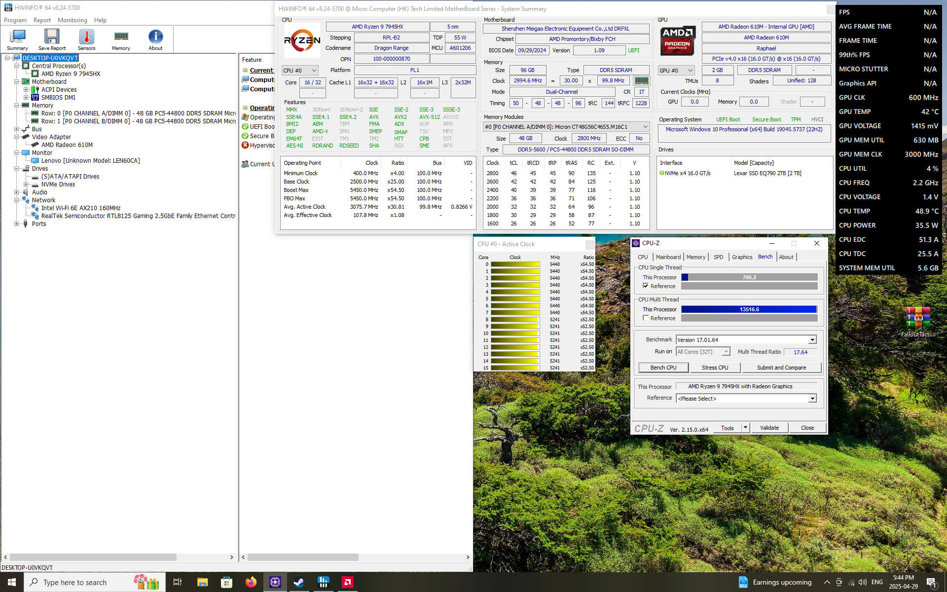

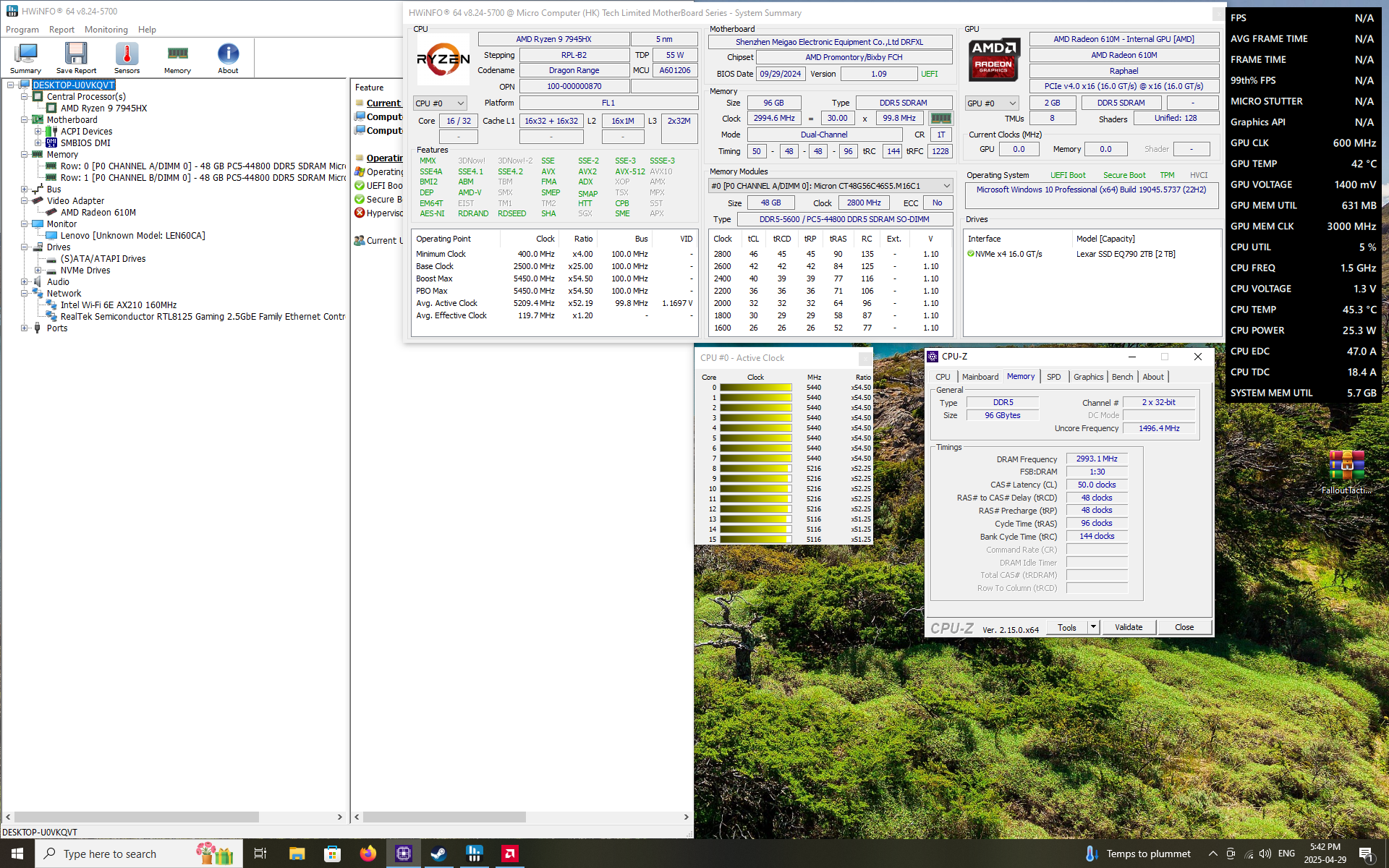

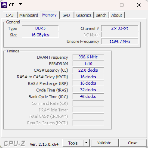

I've just gotten a new to bd795i se with a ryzen 7945hx processor but performance is lower than others in geekbench 6 even after taking steps to tune system. Theres a 20% difference in multicore performance between mine and others which is a bit too much
https://browser.geekbench.com/v6/cpu/compare/11505047?baseline=11524201
Tuning steps include
PTM7950 pad, original paste was a hardened pad(not good)
30mv undervolt in UXTU
Windows power profile better performance
AMD chipset drivers and graphics drivers installed
Tried running with a PCIE gpu and no performance difference

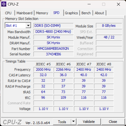

I got two ram kits 2x8gb samsung and hynix with the board
Screenshot2025-04-15101142.png.0d1762bcc5f90c6e7a8e6312ef5b6708.pngScreenshot2025-04-15103406.png.624f4bfd2f64caf1e0816cbba56487f1.png

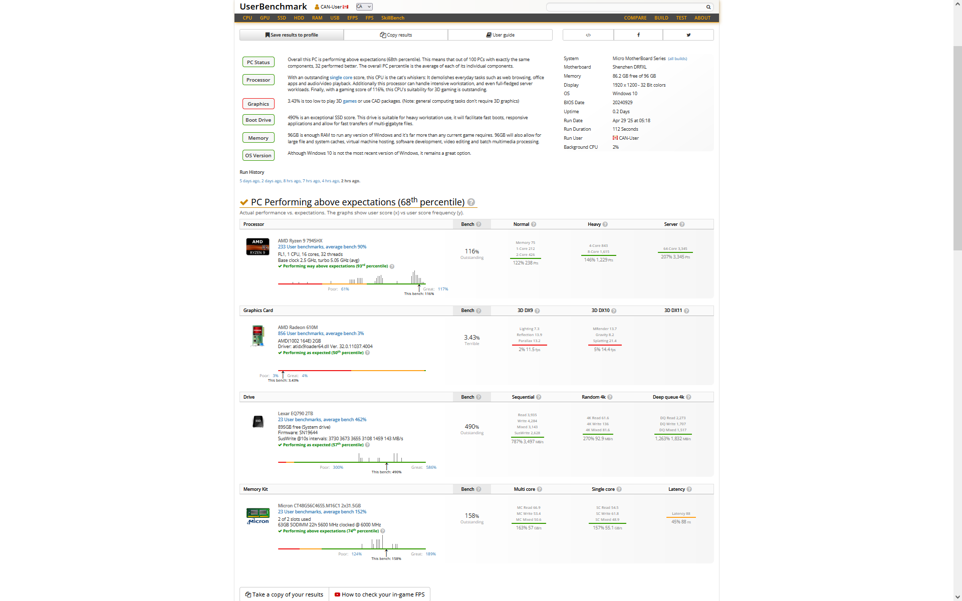

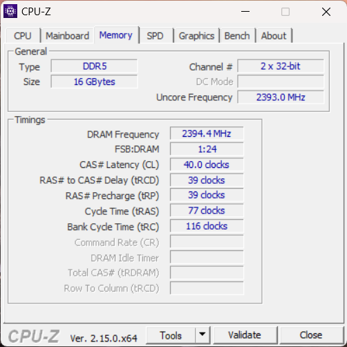

everyone was buying crucial ram so thats what i went with, runs stable at a 6000 oc for me but i spent days reading about it before i tried and i used some information i found on a few reddit fourms, i wont guide anyone on how to do this because a mistake might be fatal im running at 5200 with my settings all the same in my bios now and my pc rips... im worried about about my onboard gpu since i dont have a gpu installed but i played kenshi for an hour and this little poc amazed me..... go on discord there live help there, might have to wait abit but i got a respones almost instantly... theres a 7945hx sub post in there

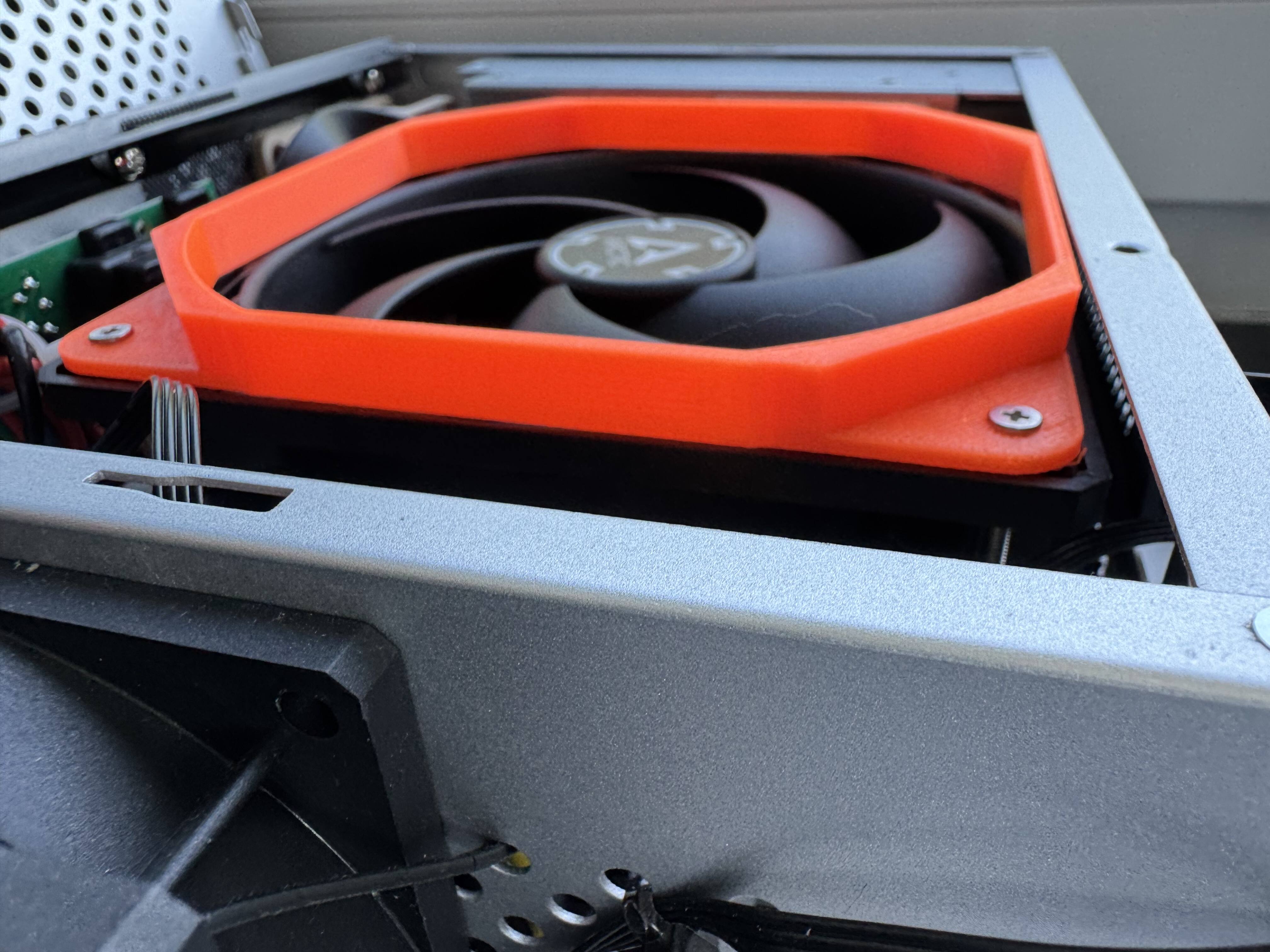

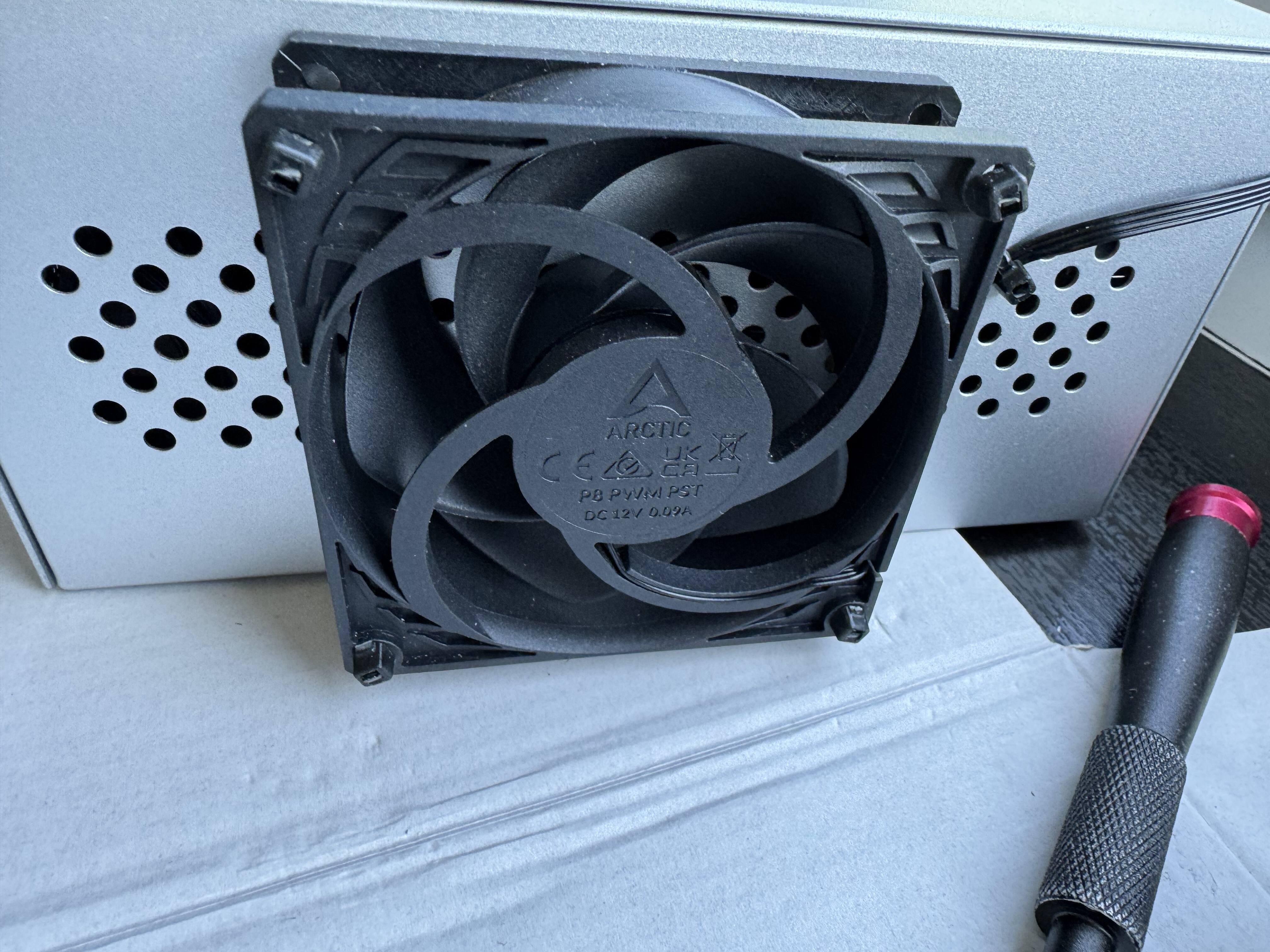

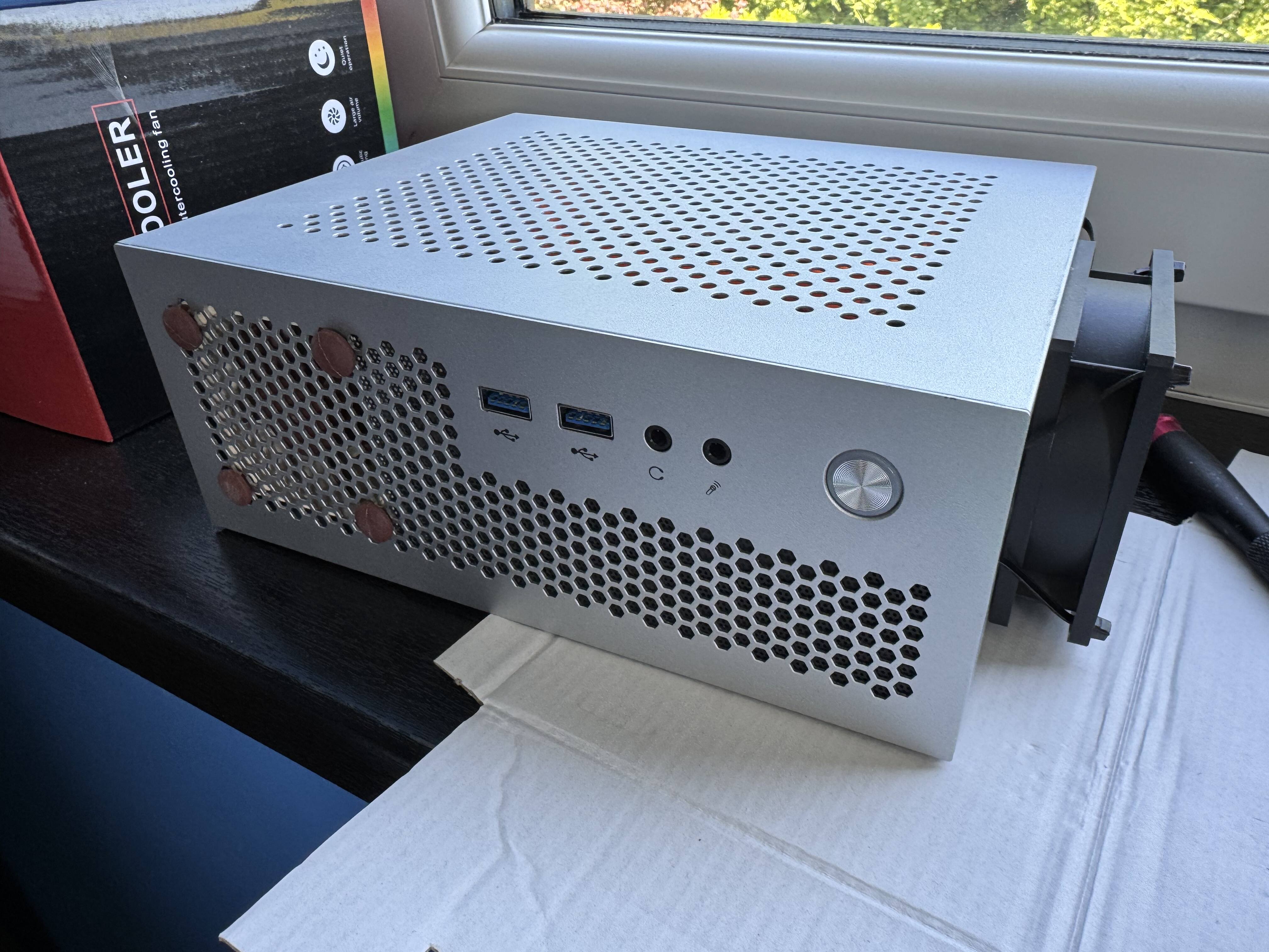

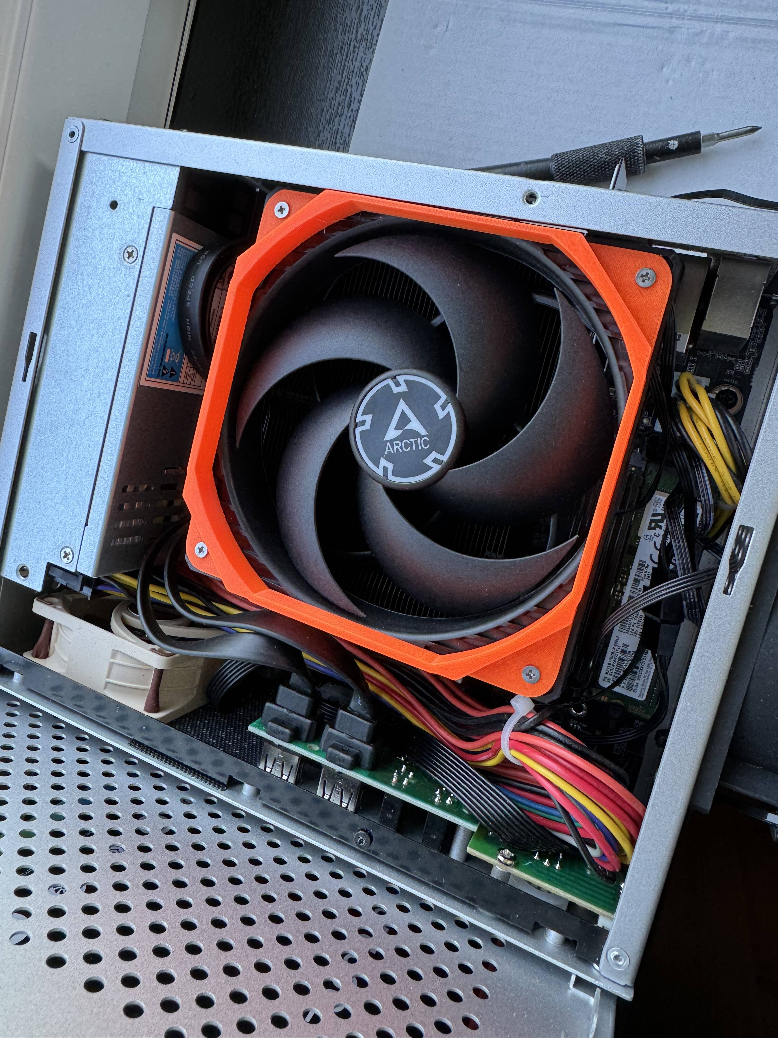

No geekbench improvement yet but I’ve printed a fan shroud so air is pulled from outside my a09 case, noctua 60mm front intake by seasonic SSP-300SUB power supply runs to loud and hot otherwise and 80mm exhaust fan.IMG_1993.thumb.jpeg.25279d540cfd0e8df6653d7bd8a96359.jpeg

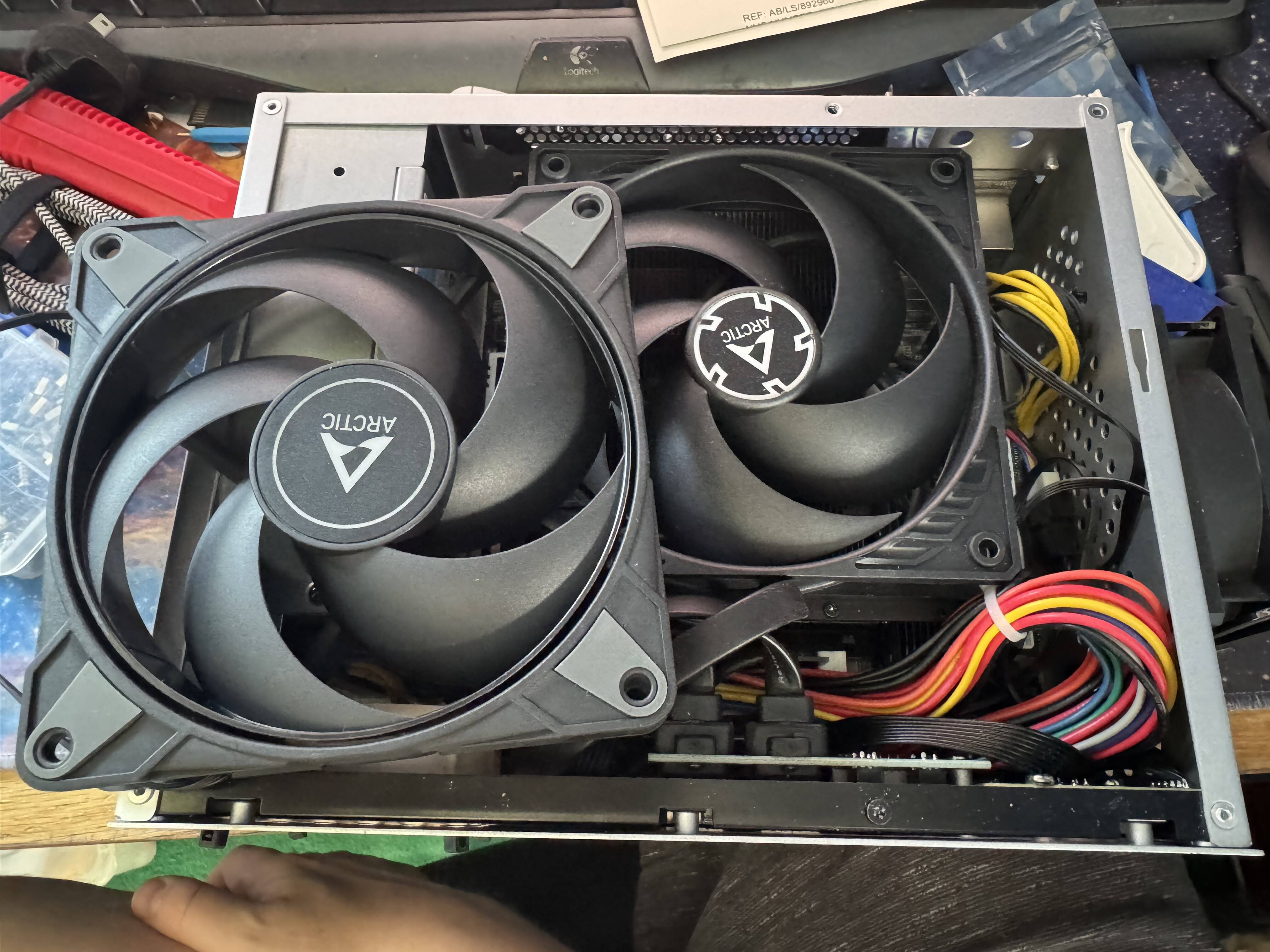

Still no improvement. Build update to Arctic p12 max to see if higher rpm fan makes a difference. 1750rpm to approx 3300rpm
