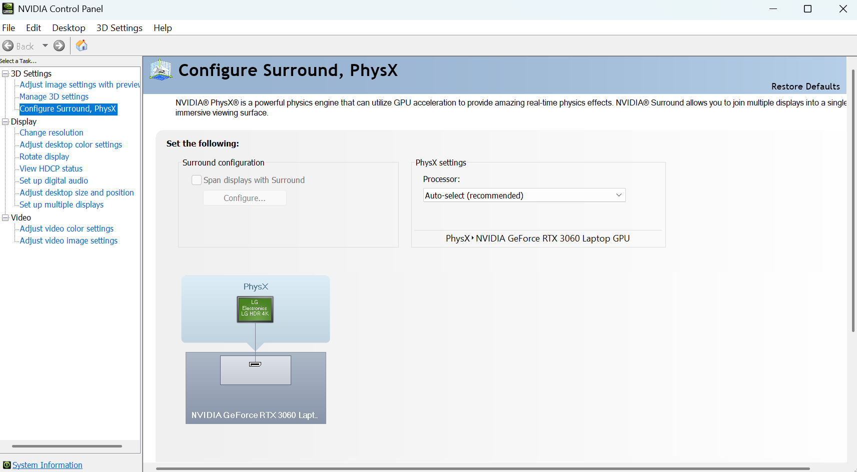

The HDMI port isn't always wired to the dGPU in a gaming laptop. If you plug it in and go to Nvidia Control Panel's PhysX section, it'll show where outputs are wired to.
Optimus does have a latency and performance overhead, small, but it does exist. The vast majority of gaming laptops in the last decade have it though.
