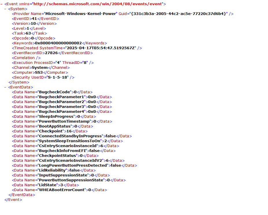

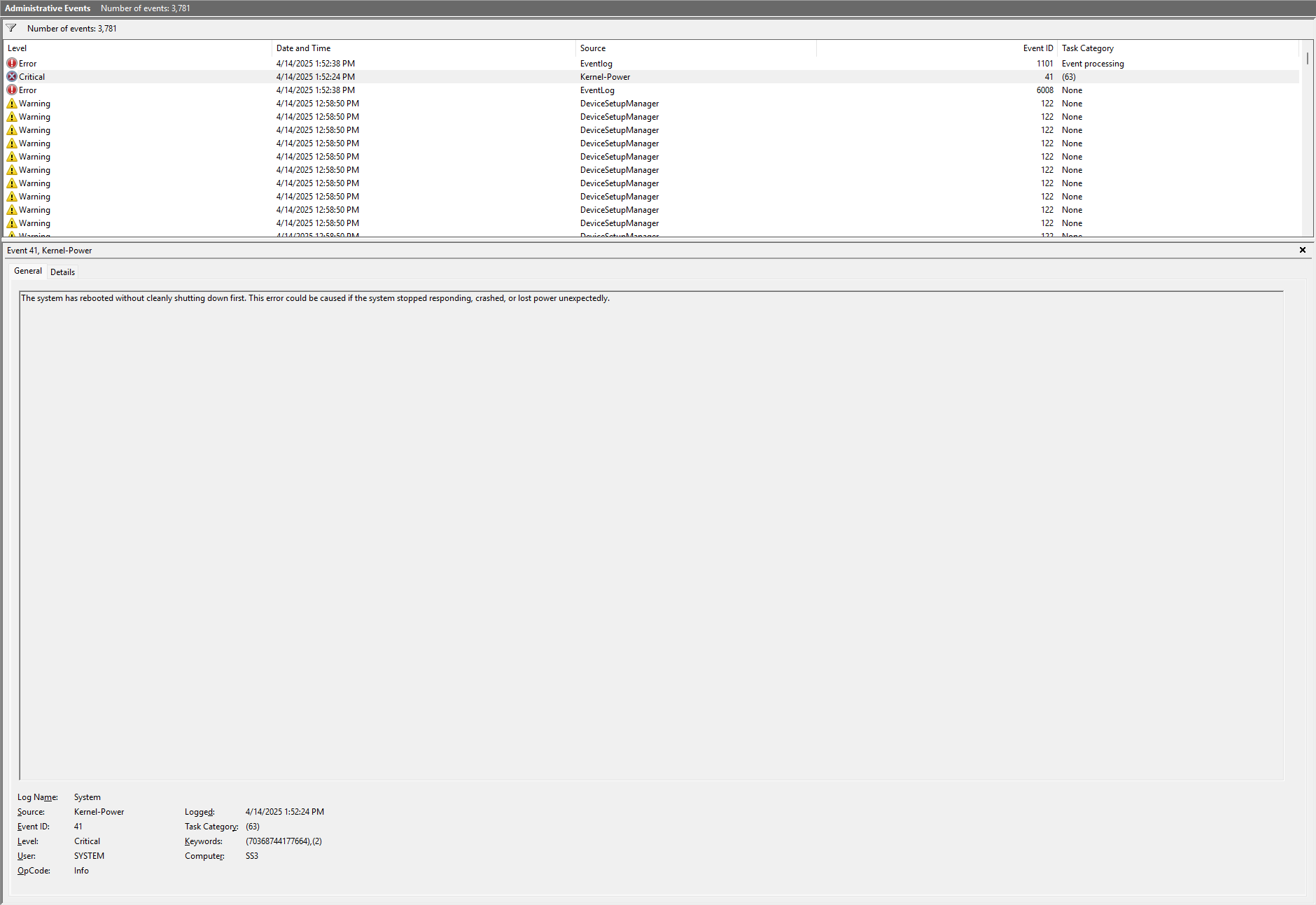

check event viewer and see what it says, and are your gpu drivers up to date?
Yes, my GPU are up to date. Here is the screenshot of the event viewer right when the PC monitor goes black.mmc_jo4YcBEmWT.thumb.png.2a6554ed18a3cc87097e0f0690706db1.png

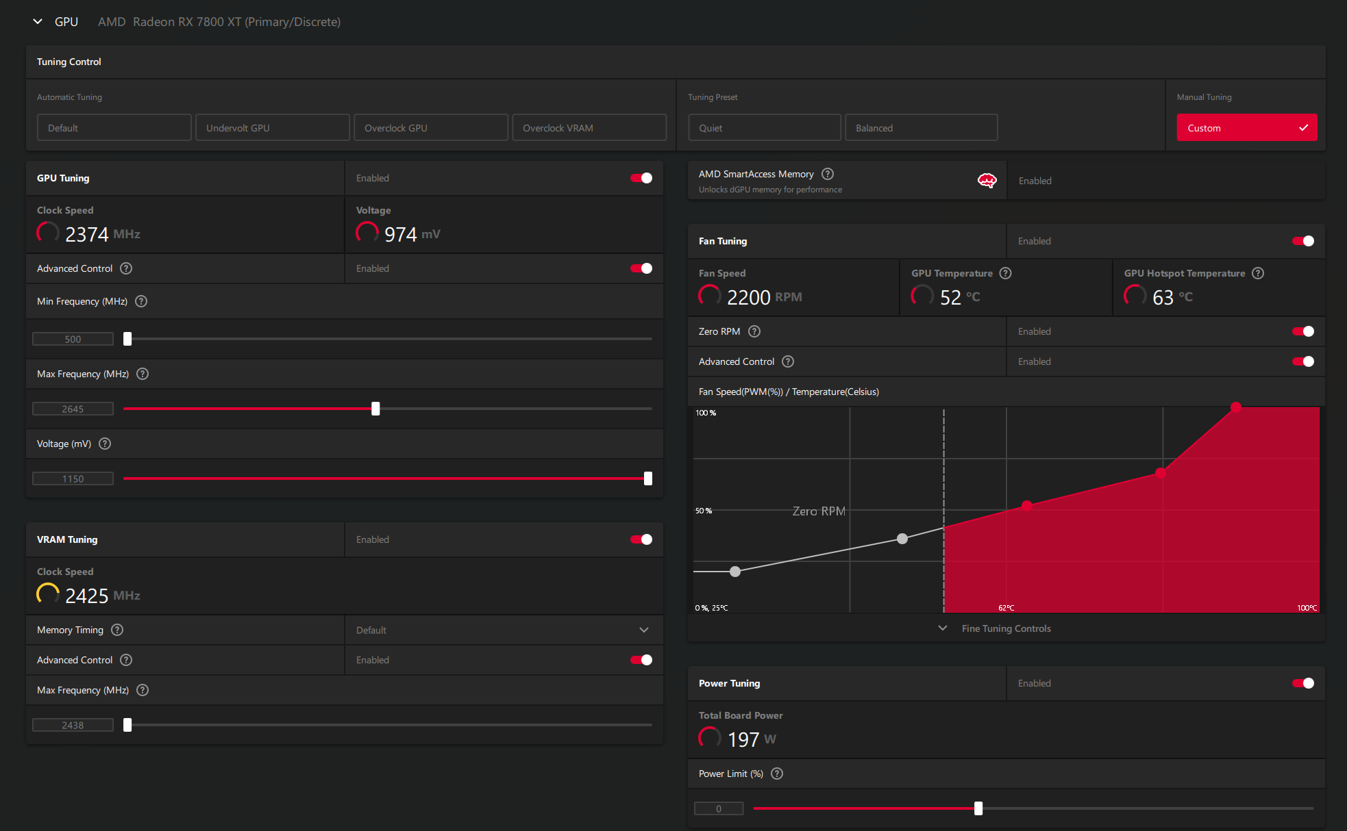

One thing i just found, go into adrenaline, set GPU tuning to 'Custom' and enable tuning on every setting, but don't change the default value, like this:
Mine went from 2 minute crashes to perfectly stable, playing BF2042 since your last message
Do you have any PBO setting running for the CPU side? Also how was the temp? Is it still normal?
42 minutes ago, NotMaxLee said:
PBO off, haven't tested with it on although I doubt there'd be an issue, Max hotspot on GPU was 70c, CPU max 65c so easily within expected range
I see. Same here but it crashed again after I tried your solution. Both with my custom cable and the original PSU cable. But at least it didn't crash and went black again. It just reboot right back up.

I have a temporary fix for now. I just use the undervolt option in the AMD Adrenalin Tuning section and keep it that way until there is a new driver update.
