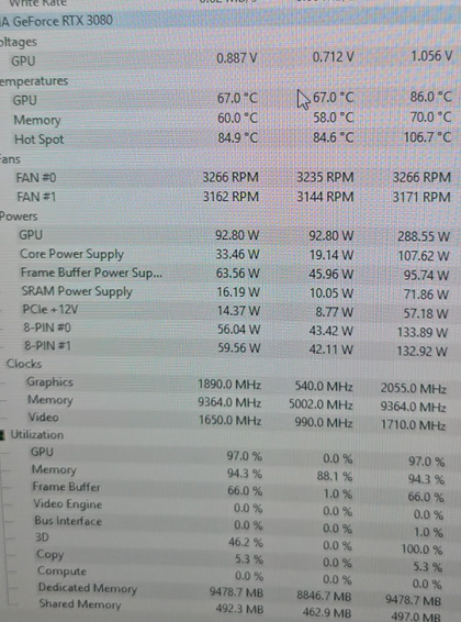

I attached a picture of HWInfo underload.
Is it normal for the hotspot to go to 107'C?
And is it normal fot it to go to 288W? Because on google it should actually go to 300-400W
You know, I personally have some thoughts of it, either it's a faulty GPU or Driver issue or Thermal issue that it crashes when it gets hot.
If it's GPU faulty, I'll return the good.
If it's Thermal or software, I'll keep it.
Tonight, I will try to test Cinebench while undeclocking it, limiting temp, and probably undervolt with Afterburner to see new information.
Please share your insight, thank you so much.

10 minutes ago, Tan3l6 said:
Hotspot is too hot. 288W is normal or even a bit low though, perhaps it's thermal throttling.
If possible, return it.
Well, it's possible... But if it is thermal problem, I'm going to keep it and replace the thermal pad and paste...
Up to you, just that the other temps are fine, not sure if repasting will relieve hotspot overheating.

20 minutes ago, tomjal said:
Do you have an insight of that hotspot? would thermal pad of the vrams do?
This isn't something that any of us can give insight on over the internet, unfortunately we can only see that high hot spot and say "hey that's an issue". Repasting etc MIGHT fix it, but there is no real way to know unless you physically try
Depends from GPU to GPU, this one might need re-paste, because usually the max is 105C and if it's going over, that can be a problem.

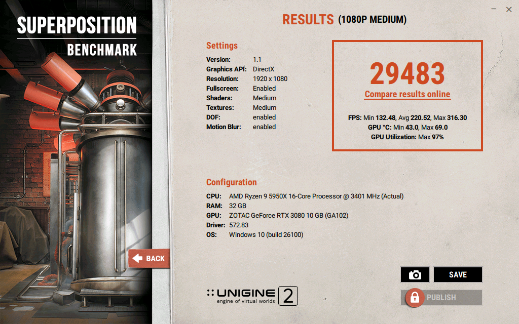

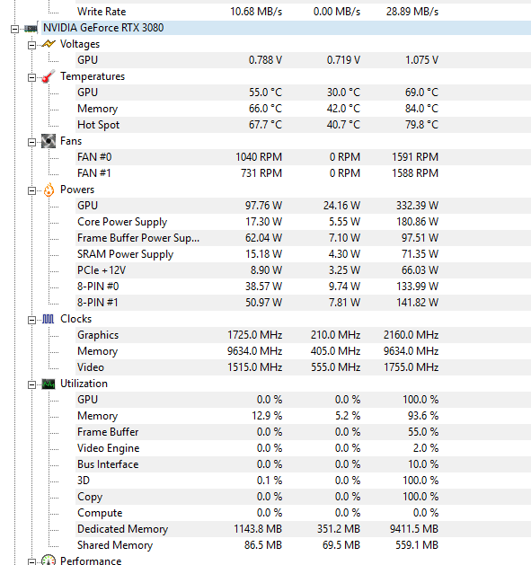

OMG I'm so happy, I just fixed it! It was thermal issue all along!!! Agatha All Along!! I just replaced the thermal paste using a new one, Kryonaut. And, it's boosting up to 2100 MHz with 70'C average! Yeay. The fan is so quiet now, before it was like a drone show here.
This is the result before
Superposition_Benchmark_v1.1_25062_1744537292.thumb.png.a0930f614b885c82e501eac2a7b8aaf7.png
This is now:
Superposition_Benchmark_v1.1_29483_1744637848.thumb.png.b67a5e128a26a07c45b552a0556d98d2.png

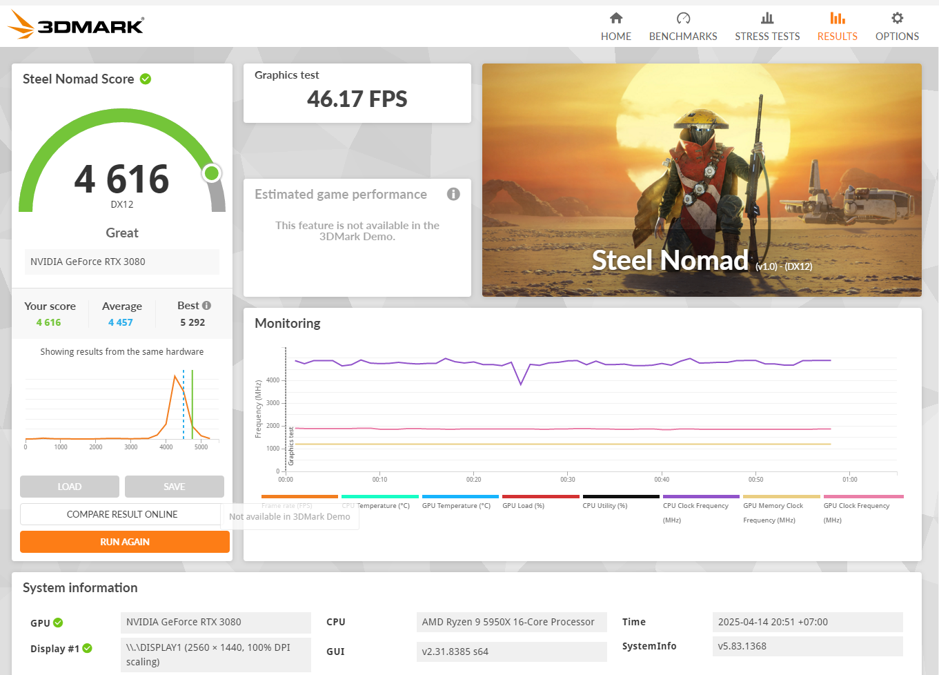

Imma respond to your messages:
I'm really glad that it's a killer deal, cause in the market it's still around 300-400 USD. And I have no Idea why the seller sold this honestly. I just found it and he showed that the benchmark was low, but he seems to be out of clues anyway. He has 720p monitor, and old CPU. So, at that moment he couldn't even give me a reason why his benchmark score was low. So, since the marketplace has a 3 days return warranty, I took the chance!
It's actually a big jump for me, Idk if my old 3060 Ti with dual fan needed a thermal replacement or not but the cinebench score is over 50% faster than my old one even tho it keeps crashing in the middle.
I'm still having an issue tho with the BIOS resolution. I'm guessing it's the VBIOS? Do you have any idea?
And the cinebench keeps crashing mid testing, but this time it crashes to desktop instead of black screen.
Thanks for responding tho!
