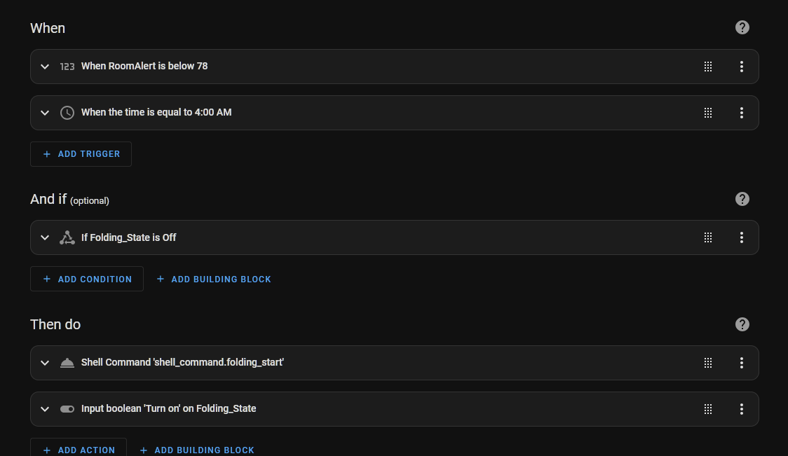

I recently got my network rack temp sensors working with Home Assistant and had a fun little project spawn out of it to start/stop folding on my server depending on the temperature in the rack and also time time. All of this is done on HAOS and might vary slightly depending on how you run Home Assistant

Example automation in Home Assistant:

Additional HA automation:
Plex runs on the same VM that does folding so if folding is active and plex is transcoding, pause folding. If transcodes drop below 0 then resume folding
