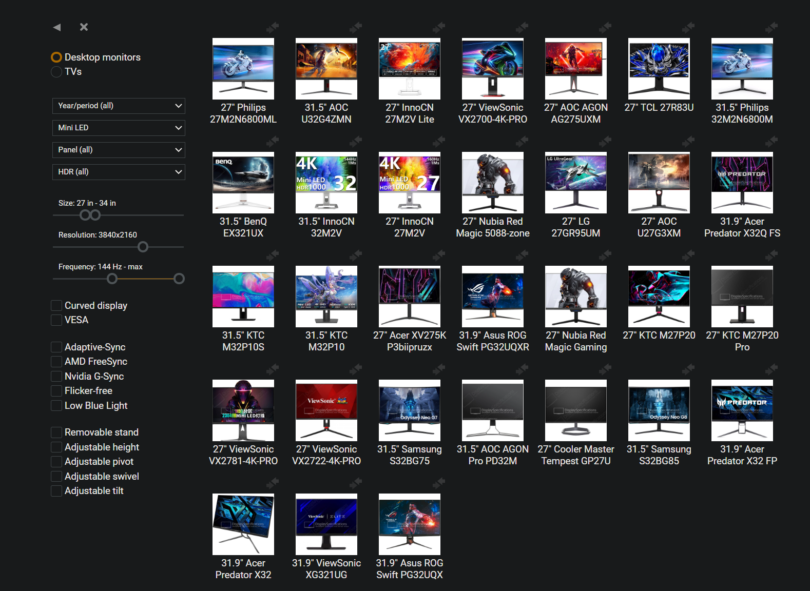

POSSIBLE OPTIONS
I used DS as recommended on Reddit to filter the monitors, and I also checked this rtings table
I've compared some of them and read rtings reviews too but I can't really understand what features I should prioritize for my use case. I think that these are the top ones that piqued my interest:
  • Benq EX321UX  - looks really promising, but is it worth 1100€?
  • Acer Nitro XV275K P3biipruzx - I can't find it for less than 800€
  • Acer Predator X32 - I can't find it anywhere
  • Samsung Odyssey G7 for curved option - I'm not sure I'm gonna get used to it

i'm going off this review the benq is better than the x32 if u go with unclamped colors, and respond time is also better (it's noticeable in all games since the x32 panel is slow.
Having used both a 27inch and a 32inch mini-led monitor, i actually recommend a 27inch if u can afford to sit a bit closer to the monitor, otherwise 32inch is fine, but 27inch options are usually alot cheaper.
It's between the benq and this ktc, or the 27/32m2v(i think ktc is available in EU), i would not try to save 100usd and get the x32.
https://www.amazon.com/KTC-Monitor-HDR1000-Speakers-Vertical/dp/B0CSKNXG4C?th=1
Well I sit about ~30cm from the screen. I was wondering if upgrading to a 4K monitor on a 27" screen would make a noticeable difference compared to a 32" screen, especially for watching movies and possibly coding / side by side. I can spend more if it's worth it 🙂
Also, I wish the X32 was cheaper, the starting price where I live is 1200€ o.o
4 hours ago, MC23 said:
at that distance 32inch is likely better, the cheapest option i can think of is the 32m2v (if it's available)
Okay thanks for the insight, I'l look into that. I don't understand something: with the same 4K resolution, does the available screen space (I believe the term is "real screen estate") change between 27 and 32 inches? In other words, if I place two windows side by side, what will the difference be? I’m not sure if this matters much since I can scale the size as I wish. I know that aspect ratio influences this, but I just don't understand if screen size does as well :s
the number of pixels doesn't change, the screen size is bigger for 32inch, it's the size of the pixels that change, the 27inch just has smaller pixels.
Another thing to keep in mind is the default scaling in windows, i should say i sit about 20cm from my monitor and at that distance i can barely use 100% scaling on a 27inch, everything looks sharper than a 32inch, but the 27inch is too small for me to not see my second monitor with my peripheral vision.
With the 32inch (only cause the 27inch broke) the default scaling of windows text is comfortably visible , and i can roll forward with my yoga ball toward the screen a bit to not see my second monitor if i choose not to.
There are minor annoyances with larger text scaling if you cannot read the text at 100%, some windowed app will also be scaled up even if you don't want it to be, i recommend staying at 100% scaling.
TLDR: the 27inch is sharper but a bit too small, smaller pixels. The 32inch is larger, more immersive, less sharp but not none of the things mentioned are deal-breaking for me.

I see, I'm also making some desk arrangments since I have a new library next to it, and in its current position (which might be the definitive one), the distance between me and my screen is ~60cm, so the 32" choice is increasily becoming the more probable. Although I just found the Acer Nitro XV275K P3biipruzx screen at 500€ which might be just too good of a deal to let it slip away >.<
