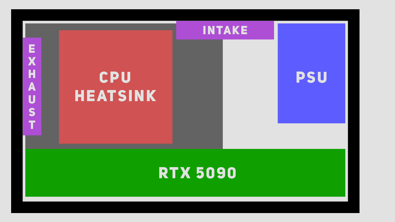

Is this case too small for good cooling with my specs?
Go to solution Solved by SorryBella,
Youve built it right? Well time to put it in the fire.
Run 3DMark Steel Nomad stress test loop alongside a CPU stress tester like OCCT, Prime95, or Y-Cruncher.
I built a PC for some fun AI projects and i recently got lucky and got a Gigabyte Gaming OC RTX 5090. My issue is that, I am using the Lian Li A3 Wood model, and im worried that with a 1000w psu, my Ryzen 9 9900X, and the Thermalright Royal Pretor 130mm Air cooler that the 5090 might make the whole system too hot under sustained workloads. My current airflow setup is pictured below

temps should be good in the case. gpu intakes from the bottom and out the side. not most ideal flow for cpu but its not the worst i guess as there mesh on the side.
could posably swap the cpu and case fans for some better fans but i dont no what your using so...
im using Arctic P12's but after a stress test, i noticed it was "okay" but ended up just getting a bigger case to be safe.
