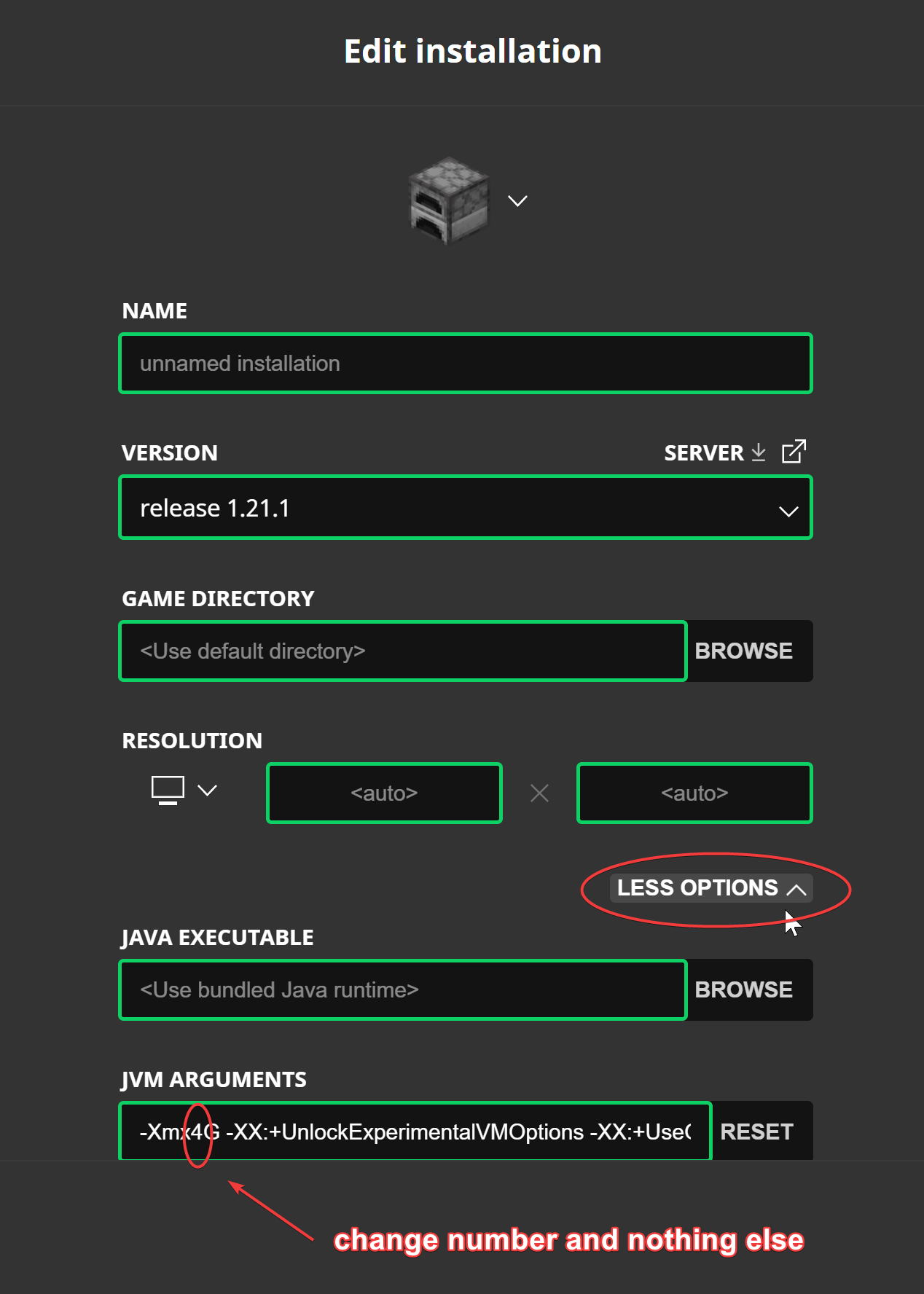

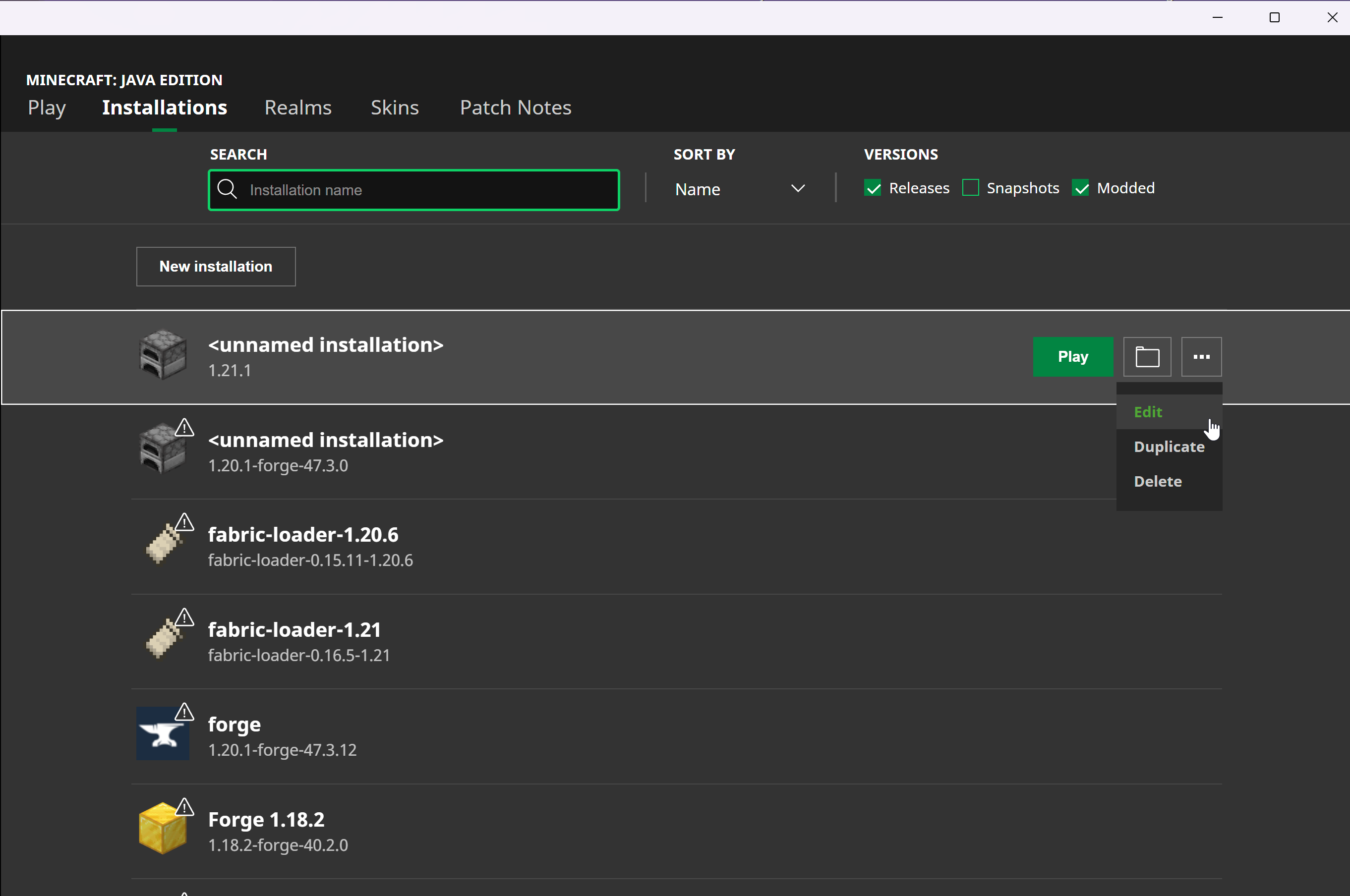

Ensure that your Minecraft installation can use more ram. Just having more RAM won't allow Minecraft to use it, you need to manually change a value to set your new max RAM, i am 99.9% confident RAM allocation is your issue.  Here's how to do it:
The number just means the max gigabytes of RAM that Minecraft is allowed to use. For most mudpacks you can do 4-8GB, but since I have 64GGB and I use a shit ton of mods, I do 24-32GB so I don't need to care about it. For 90%+ of people and cases 8-12GB max should be just fine. You can also see exactly how much RAM you need by tapping F3 and looking in the top right corner, you'll see how much Minecraft is using at any given moment.
