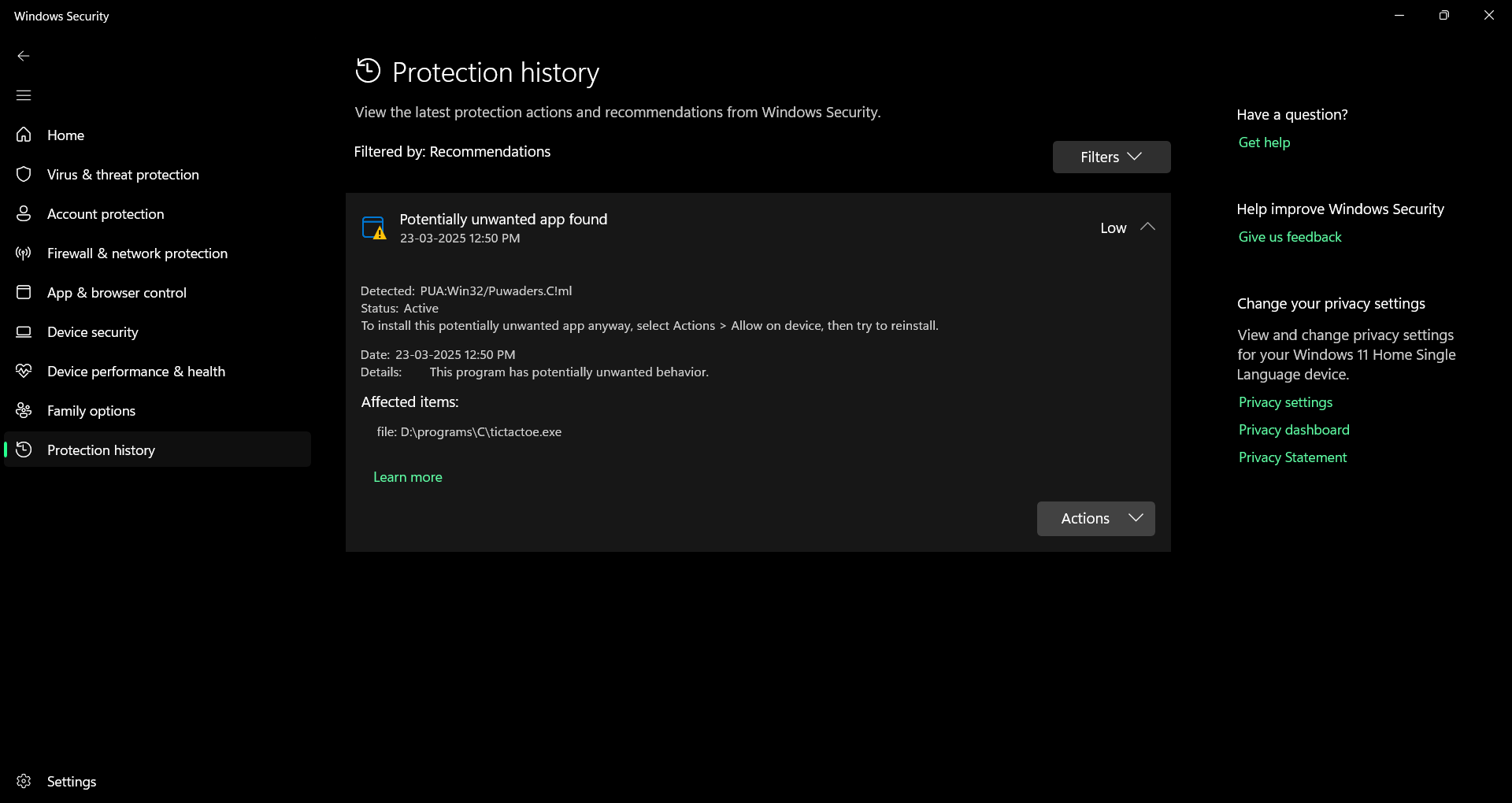

Why is Windows Defender is saying my failed C tictactoe project might be malware?
God dammit I know my code sucks they didnt have to roast me like this😭, anyways can someone explain why this happened like, I know it's false positive but it only happened with this programming did I fuck up and do a memoery leak or something, I use dev c++ with a tdm-gcc 4.9.2 64 bit
and this is the code, I actually wrote this when I was first learning C and didnt touch it that's why it doesnt really do anything apart from just exit, I'll fix it myself later own just need to know what I did here that would make it a malware

Most likely it's a combination of the app being unsigned, located in the program folder and potentially matching some heuristic about memory access patterns.
Defender can't see your source code, so it can't do any form of static code analysis and search for memory leaks or similar (nor is that its purpose in the first place). It just checks the binary against know virus signatures and different heuristics. A tiny executable that just writes to memory before exiting likely matches some bad behavior patterns.
First of all, the program throws a segmentation fault because at line 23, you are trying to print each value of the array as a string instead of a character, and so printf() is accessing something out of bounds of the memory and so the program crashes. Replace %s with %c.
Fix your includes, no need for stdlib.h and string.h, and include each only once.
And the rest of the implementation is not how I would write the game.
First using #define, to define characters like O, X, - (with added spaces so you don't have to print spaces manually) as the marks to print them. Once you print the empty board, ask player one (using a boolean value to switch the player turns) to enter the X and Y coordinates in integers of the board to at the place in the board, place player one's assigned mark. After this, you are going to need to write a function (or just inline it) to check if either player has won. Using loops, check each row and then each column if either player has their continuous marks, and also check the diagonals as well. And run this in loop (condition for a while loop can be a boolean value which will switch if the checking function declares a win) as also switch the boolean value for the next player.
As for the malware reporting, it's Windows, a Mi**osoft product, what do you expect? Grow up, use GNU/Linux.
It's just a false positive. Perhaps because printf was accessing out of bounds memory, it threw that warning.

It's probably because it's unsigned and more importantly unknown...
I once had it flag and *block* a mod I made myself on the very same PC, because I had downloaded it from the mod website to check as a "zip" file...
It kept doing this for several days, then stopped doing it...  (I also reported it several times for false positive)

also I declared i and j as char types then assigned int value to them in the loop, but yea i think it could be because of the printfs
that's not the main program folder, it's a folder i created in a different drive for saving programs which I code, and yea it makes sense it's my weird memory acess patterns

on topic, antivirus software in general is always very touchy about "unknown" things, and oddities like including the same library twice probably doesnt help that. in a very dumbed down view, antivirus software gives software a "score", and the higher it gets, the more "potentially dangerous" it is assumed to be. an executable it hasnt seen before is a point, some odd program behavior might be another point, the location might be another point, and at some point it has enough singular points to just barely hit the treshold. and what you see is your antivirus essentially saying "hey i dont recognize this, do you?" - that's why it's "potentially unwanted" and a threat level of "low".
i see this a lot when i play old games, because in the late 90s game engines often had weird ways of drawing 3D scenes, and they're not common executables at all these days so they're flagged constantly.

Patterns can raise suspicion, but is the program actually doing anything that could harm? In this case, it's a really bad false positive. The only way to know what caused it if @VirusDumb tells if fixing that printf statement made it go away or fixing the includes did it. Man, these are just rookie programming bugs, I can't believe that Defender could flag them as malware.
since you spend your day praising "GNU/linux" on a forum i assume you're very knowledgeable, and you know that malware these days does a lot of effort to "act as normal software" while deploying the payload as sneakily as possible. if a piece of software does something abnormal it makes sense to put the brakes on and ask the user for confirmation that they know what they're doing.
it's the same debate as REX (Request to EXit) sensors on automatic doors, do you open the doors at any movement at all, so that no one ever has to stand waving in front of a closed door carrying a heavy box.. or do you have sensors looking for a more specific thing that might occasionally not open a door for someone, but also doesnt let in bad actors using a can of compressed air. (look it up, it's hilareous)
security software has always tended towards the side of preferring occasional user annoyance over missing threats. unfortunately, in the example of rex sensors... some facilities are HILAREOUSLY insecure.

Yes that might be true, but just look at the innocent code above. It's obviously a false positive, and that is a bad thing but not a high priority to solve it and indeed better than comprising security. It is not playing with registry or trying to access memory of other program, or well, yeah that printf() function did access out of bounds memory which is why it could have been flagged as a malware. I don't know. Defender could be taking high precautions, and you security sensitive people running Windows can do whatever you would like with Defender, and I don't need to argue as well because I run GNU/Linux.

it's obvuiously a false positive to you, me, and OP. that's the point of the "allow this on my device" button. it clearly did something to reach the treshold of a flag, and if your response to this is "uninstall defender" you've completely missed the point. do you also rip out your car alarm when it goes off because some idiot with zoomies drove past?
Yes it did, but at the end it is a false positive. The code is right in front of you.
