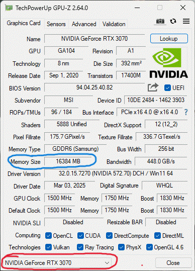

A bit of background here. I have an MSI 3070 that had been given to me because it had an issue. I figured out the vRAM was the issue. Sadly I don't have the funds to order the modules. Running in broke boy power. I can get the money but it's my card and I want it now. I might have to save up and order them I know but at this point it's the challenge. So I remove the vRAM and find that the pads are fine on the board but the pads on two modules are definitely bad. Because some of the pads are still with the balls left in the board. Great I found the issue. Checked the schematics that I found and they aren't ground or No Connection. Crud... Alright. Well looking at the model numbers they might be the same as the 2GB modules on the PS5. They are and I have plenty of those. My job is a microsoldering tech (at the time) so after a decade of soldering I've learned to save good components. Reballed and popped on, change the straps and boom working card. Well because it's been modified I have to run it in max performance mode under windows in the Nvidia control panel.

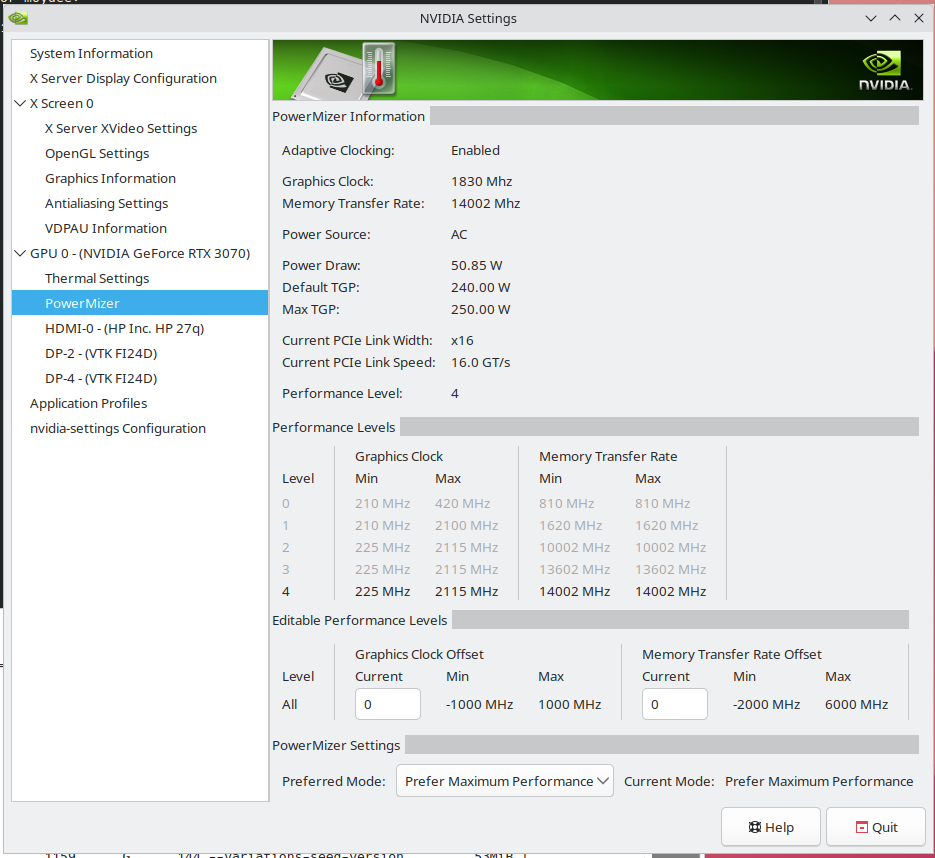

I haven't really been on the forms here so I don't know how text files show up, but here is the NVIDIA smi output from slightly before the crash. I also uploaded a screenshot of the nvidia-settings program.  No idea if this information is useful to anyone, but I'm happy to grab anything that I can.

Now you need to open Nvidia settings. Open a terminal and type
sudo nvidia-settings
This is why we need X11 bcause at the time of this post you can't change anything on the PowerMizer tab. You will want to change the Preferred mode to
[Prefer Maximum Performance] and set the Graphics Clock Offset to [-75]. The offset will likely be different for you. This is a strange mod that I did and while not uncommon it is not the norm. So your solution will likely have different requirements. At this point you will reboot.
sudo reboot
Now we want to check that everything is working right. We will need to look at the power usage.
nvidia-smi
You should get a screen that outputs a bunch of information like driver version and processes that are using the GPU. What we are interested in is the watts being used. For me it sits between 49-53W. The stock wattage was 21 for me.
