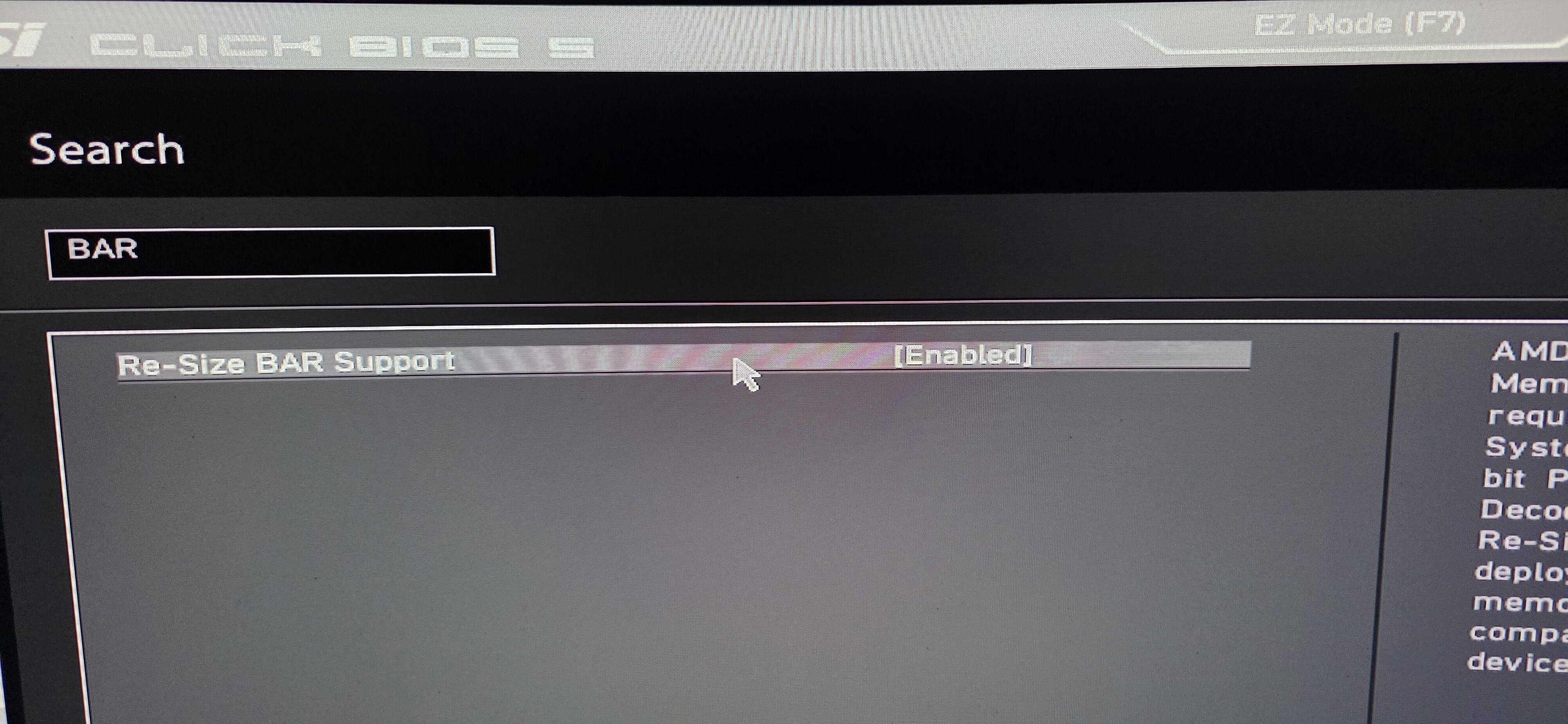

have you checked to see if AMD smart access and resizeable bar are enabled?

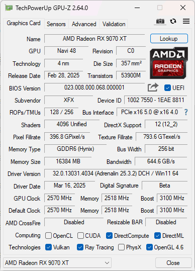

SMA and resize bar is enabled . I just downloaded HWinfo64 but i can find where it says on what pcie i run at the moment . and when i try to use DDU i says that i am not in safemode and i dont know how to reboot with safemode

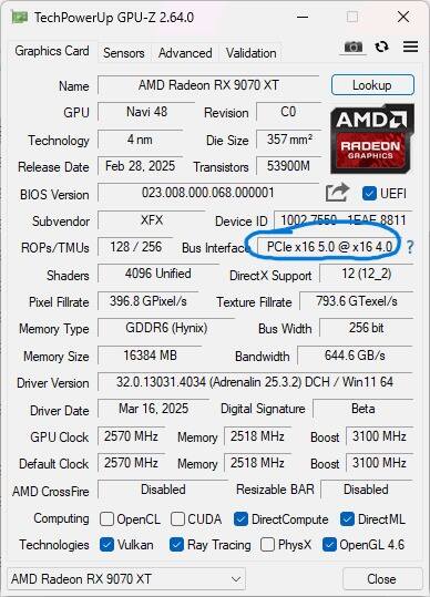

it says resizable bar is disabled- also i think i found your performance issue. the card is designed to run at PCIE x16 at Gen5 speeds, while you have it in a gen4 slot. gen5 is a theoretical 2x the maximum bandwidth, which can be detrimental to performance.
This is NOT hte issue. Current GPU's don't need all of the bandwidth of PCIe 4 let alone pcie 5.

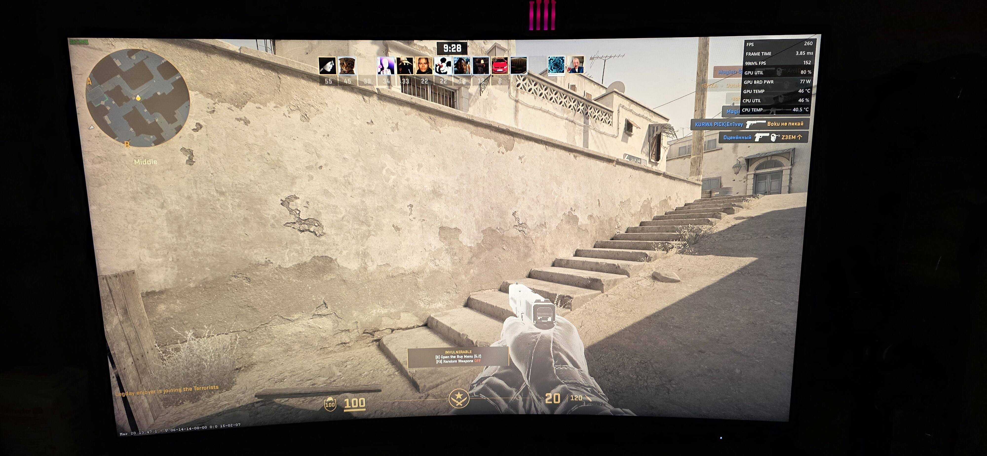

Check the per core CPU use when in CS2. You are likely CPU limited.

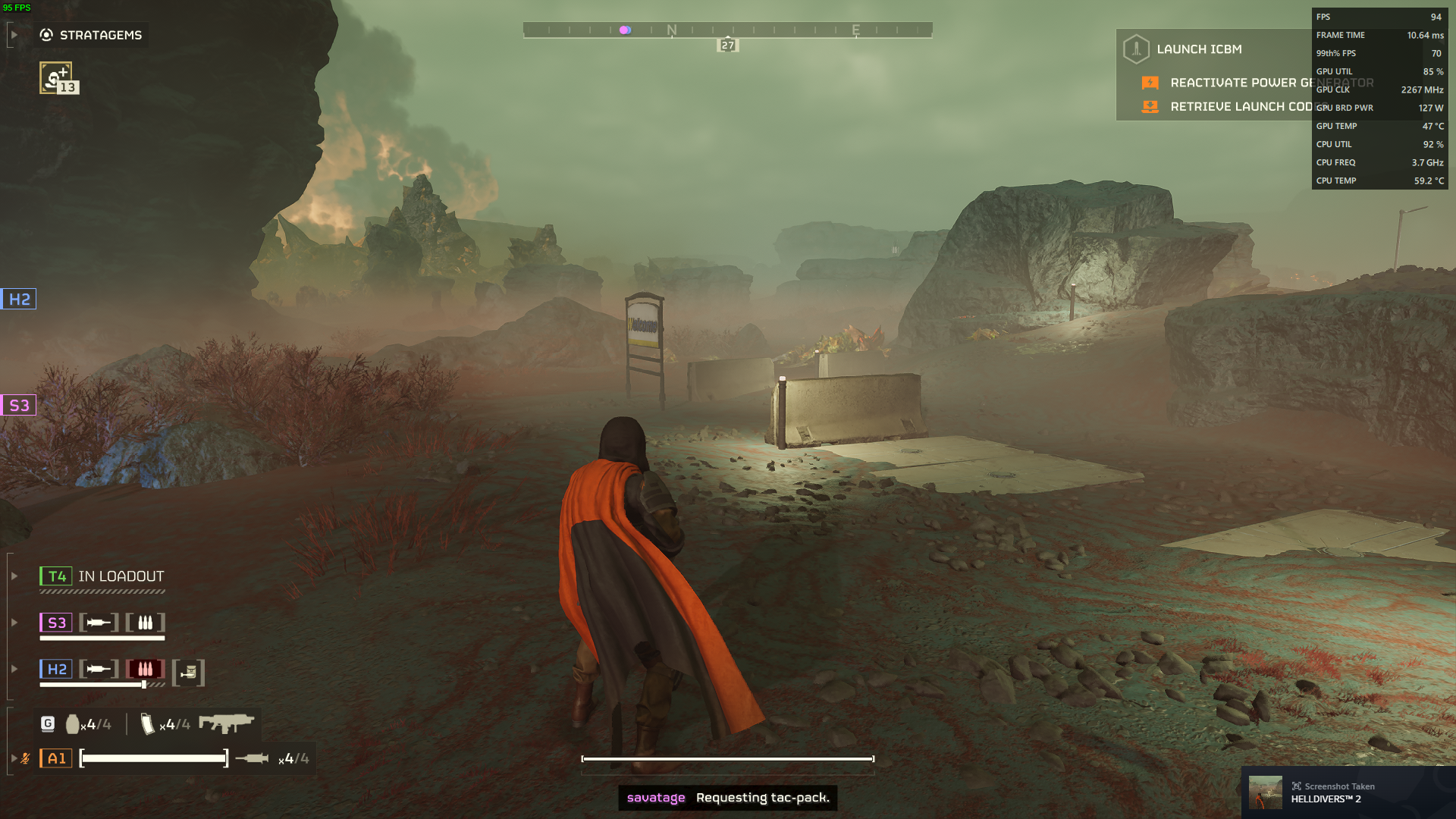

performance in helldivers 2 with everything on max 1080p
looks like gpu is not fully loaded
Did you see my message about cpu being the issue? You are at 92% overall cpu. That is your problem.
2 hours ago, korsosmihai said:
I saw on an earlier comment you tried booting into safe mode and DDU would not work. I would seriously try DDU again after a clean reinstall of windows if DDU won’t run in safe mode. Something might be left behind that is causing these issues. I have a 5700x3d and a 9070xt myself and the gpu usage reaches 100% on the games for me.
