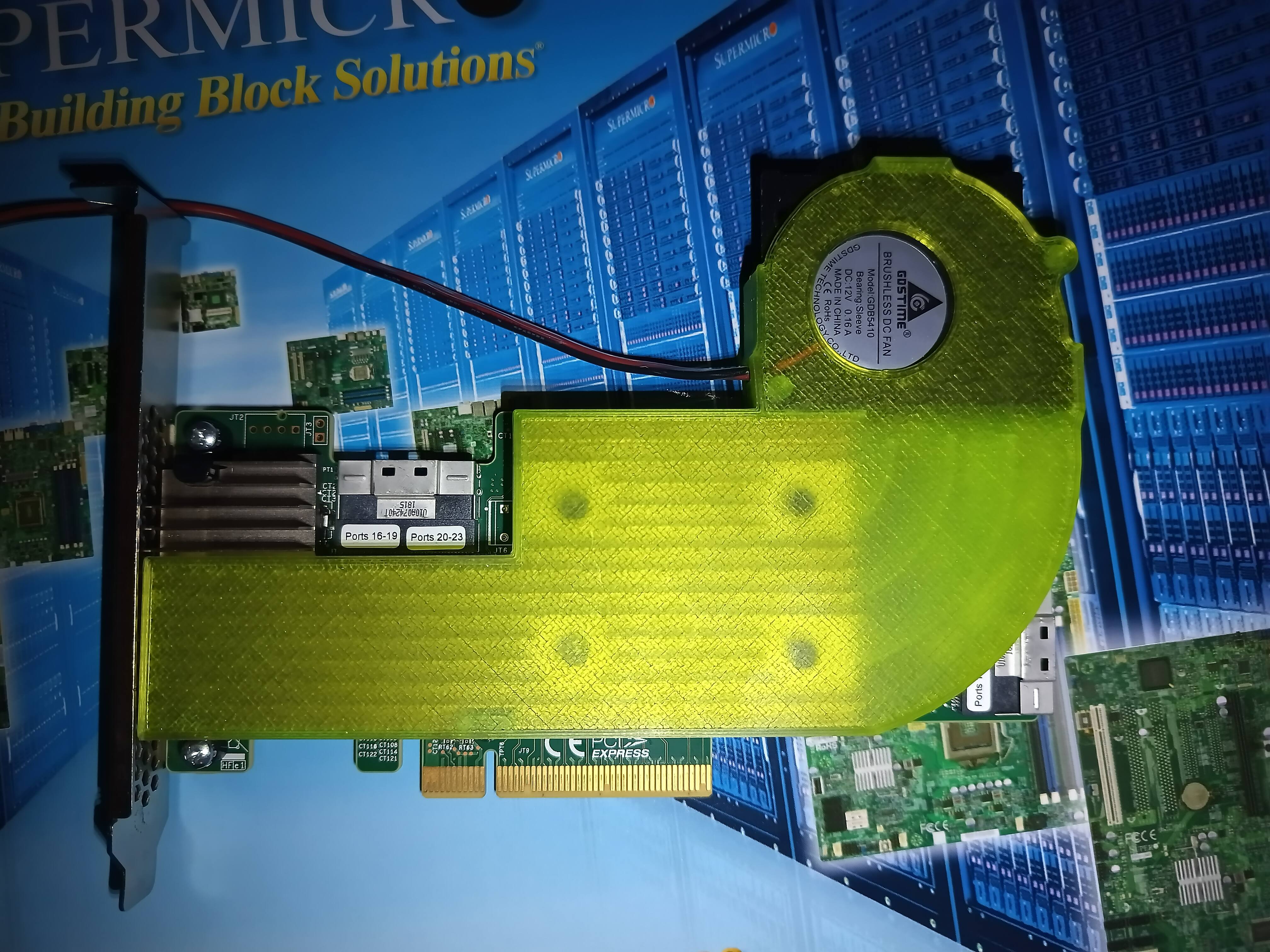

You just need air flow on the card. A PCI fan mount will work. I've used a couple other methods before. In one case with a side vent I spaced a fan out to be closer to my HBAs:
In my current case I have some angle brackets mounted to the PSU shroud to mount a fan to:

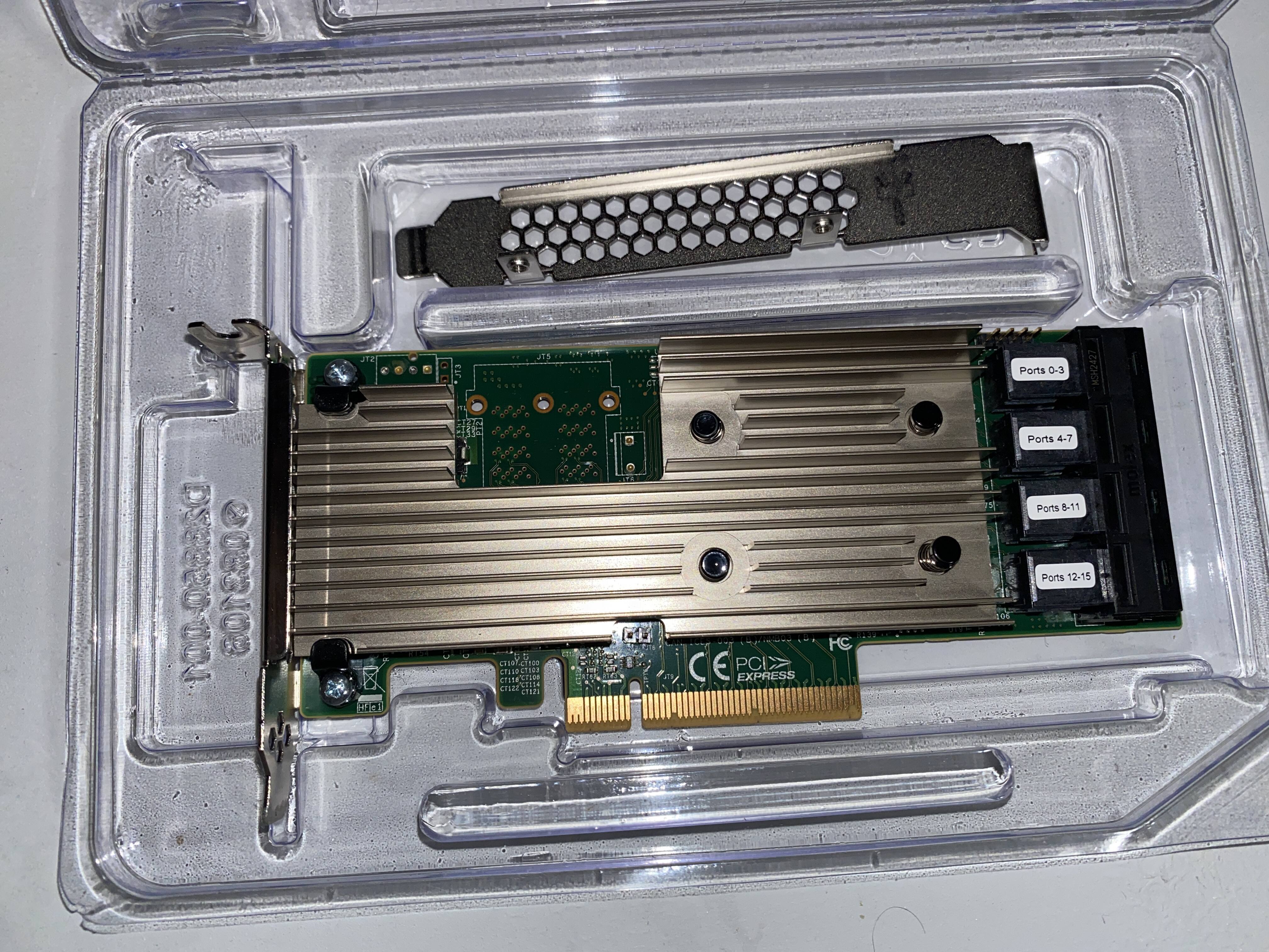

The card's around 65-70 mm tall (including the edge connector)... a 60 mm fan would probably more suitable.
Couple examples ... 15mm thick, 4$ :  HA60151V4-1000U-A99 (if you want very low noise but very poor at static pressure, which don't matter with that heatsink) or
the 8$ in between version (a bit more noisy, a bit more static pressure) MF60151V3-1000U-A99 or 8$ for the higher static pressure, higher rpm model MF60151VX-1000U-A99
This delta model also looks ok AUB0612HHB-A
Ideally, I would drill 4 holes in the fins and use thin zip ties or plain solid core wire to attach the fan to the fins.
